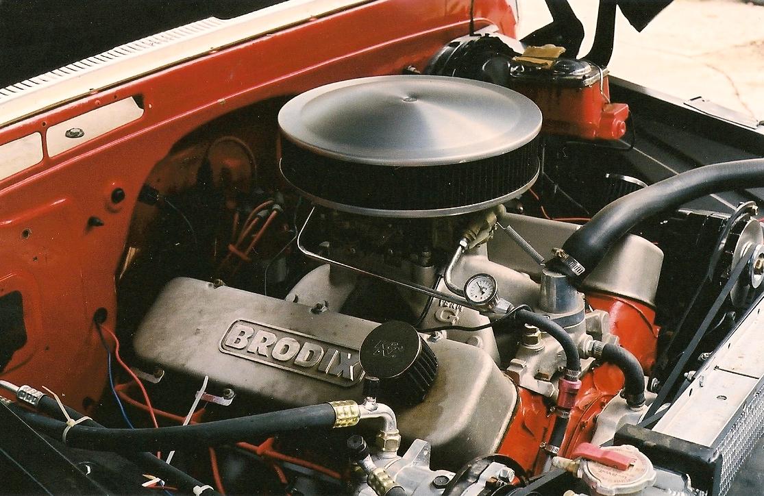

    Here is my 454 in my 64 C10.. Its mounted forward of the stock small block location, so the tall valve covers clear the firewall. Its on stock rubber mounts, the frame mounts are stock small block, slightly clearanced for the headers. Headers are tri y's for a 70's C10. Had to clearance the frame about 1/8 inch and ding one tube slightly. I've seen them in the stock small block location with stock type valve covers and its a tight fit.

  10. tom64c10
    Joined: May 7, 2016
    Posts: 1
    tom64c10
    What headers did you use?

    I bought them used, so not 100%, but I believe they are Dougs D303Y-R
