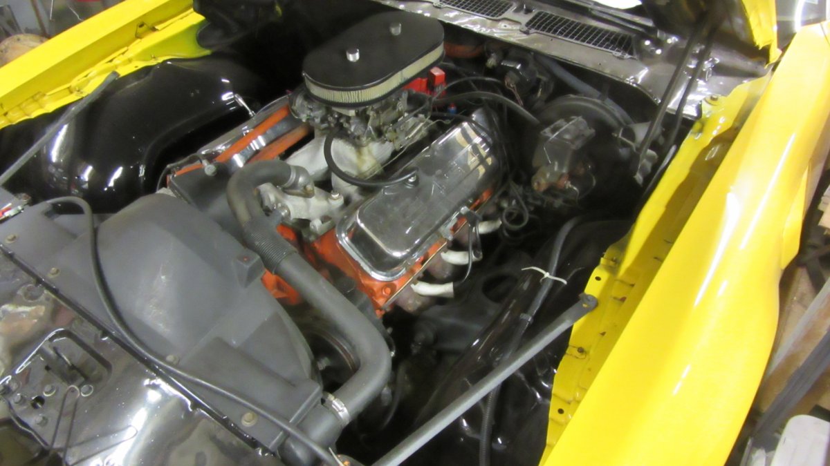

    We have about the same combo here and it currently has a 3.45 gear or there abouts but it did have a 4.10 and it has been together for several years and runs great. I will have to see if I can come up with the number but we used Comp cams hyd. flat tappet and it at the time was the biggest one before they recomended using a stock converte IMG_0019 (2).JPG r.

    Thanks. Is that an air gap intake?

    It is, but it has a 600 Edlebrock on it. 40 over 454 , Probe forged pistons somewhere around 9.5. Comp roller rockers. Bad heads LOL , Summit brand headers, GM Corvette baffled oil pan, balanced, stock converter, the air cleaner is small for the cubes but so is the carb but I put my son in this when he was 16 so it was and still is plenty. He is 25 now and he only spun it out in the ditch twice that I know of ! I t has the stock posi rear end in it now but it did have a Moser 60 with a spool and a 4.10 in it for years . of yeah I forgot you can't run a spool on the street . Bullshit ! Build it , run it , enjoy it. But I grew up riding around in cars we had 5.86 's under. Those were the days.
