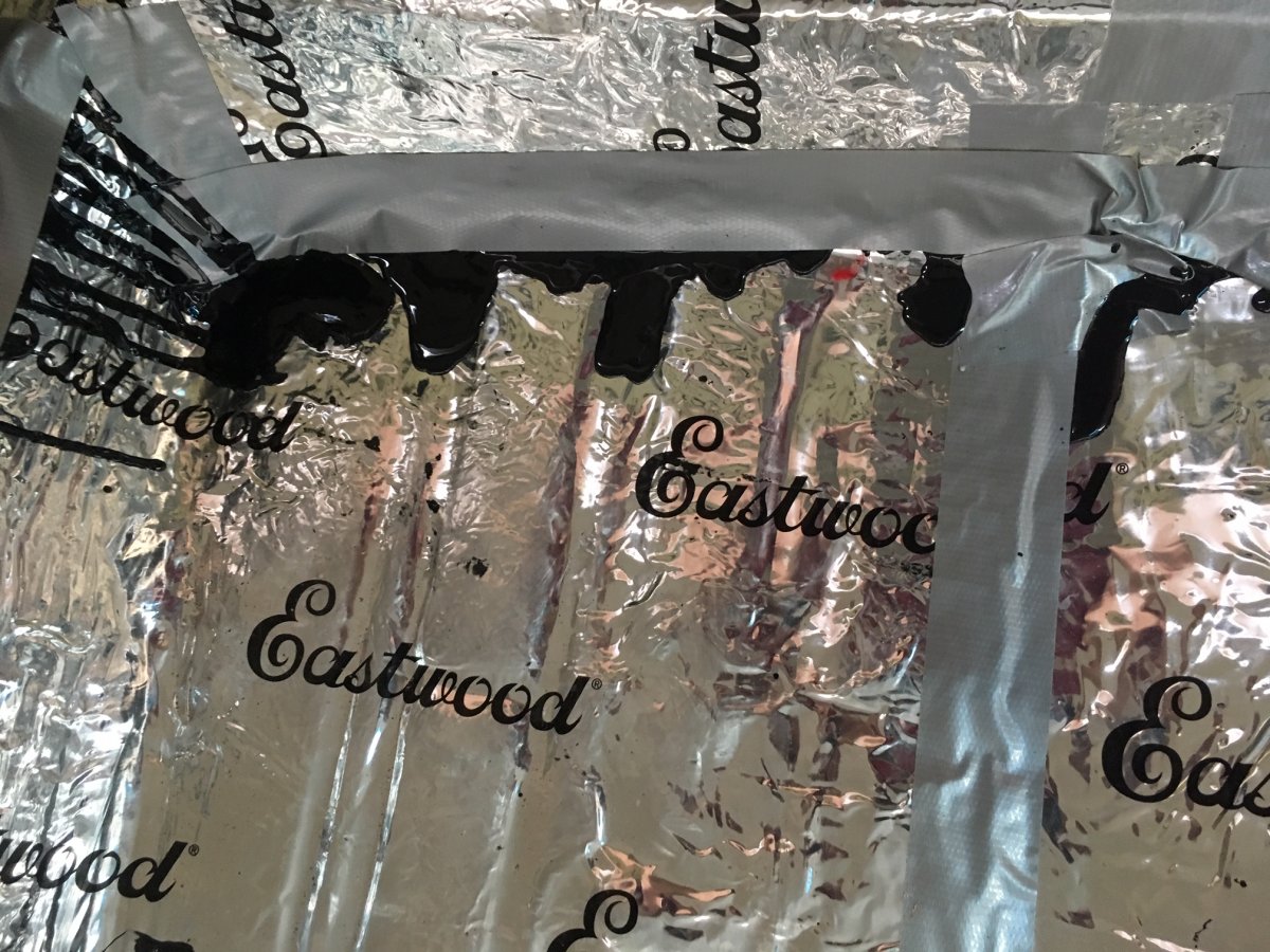

    Two months later and he has puddles of ooze. I don`t think good tape would of stopped it. What about a few years down the road. Or say 10 years. Even with good tape.

    Not much consolation for you, but by posting this, you saved countless other guys from making the same mistake... me included.
    Thank you.

    You're not the only one having this problem with Eastwood's sound deadener mat. Just talked to a guy at a local show that saw my Dynamat in my 31' and asked how it was [it's fine] because his Eastwood stuff was melting into puddles ,he was NOT a happy guy. I do like some of their other products like rust encapsulator and chassis black spray paints.

    Dan E
    I installed Eastwood Xmat in my truck over a year ago and haven’t had an issue. It gets over 100 degrees where I live a lot in the summer. I bet the stuff everyone’s bashing in this thread is their old stuff. Keyboard warriors always love to bash without the full story.

    I also have used peel & seal from Lowes and after the job was done I put a match to some of the scraps before throwing them in the trash. It burns real good. I'm wondering if other similar products also burn and how much heat it actually takes to get them to ignite.
  23. Never2low
    Joined: Jan 14, 2008
    Posts: 1,124
    Never2low
    Unfortunately, that's the difference between cheap asphalt based product, and quality Butyl Rubber product.
    Butyl doesn't melt, at average temps. (Throw it in a campfire, and yes it will melt, most things will)
    Covering with a layer of Butyl may work, but if it doesn't, you'll be throwing good money after bad.
    Most likely it smells like roofing tar every time it gets hot. That won't go away.
    Sucks, but the best thing is to completely remove it, and start over.

  25. Did you mean their NEW stuff? I have the OLD stuff, which I posted about, and after checking was fine.
    Never seen anything like that running before- no threads,complaints, etc......
    Everything posted regarding is with people who've installed in the last year or two......
    Bad Batch? IDK....... Hope there is no more failures.......

    The stuff on the truck I worked on was at least 4 years ago, it oozed out also. So it is an ongoing problem.

  29. Thanks @Dan E. That matches what I hoped.
    I ran a (very) non-scientific test. I rolled some scraps of Eastwood XMat on a sheet of 18g, and laid it on the concrete in direct sun. It’s pretty hot today, for Iowa, 93. It can get hotter but this is average. It’s over 100 in the garage.
    I don’t have a way to measure the temp on the 18g, but I can’t touch it with bare hands.
    No runs, no drips, no errors.
