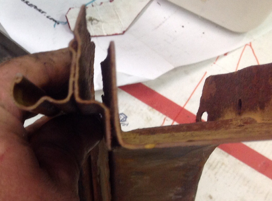

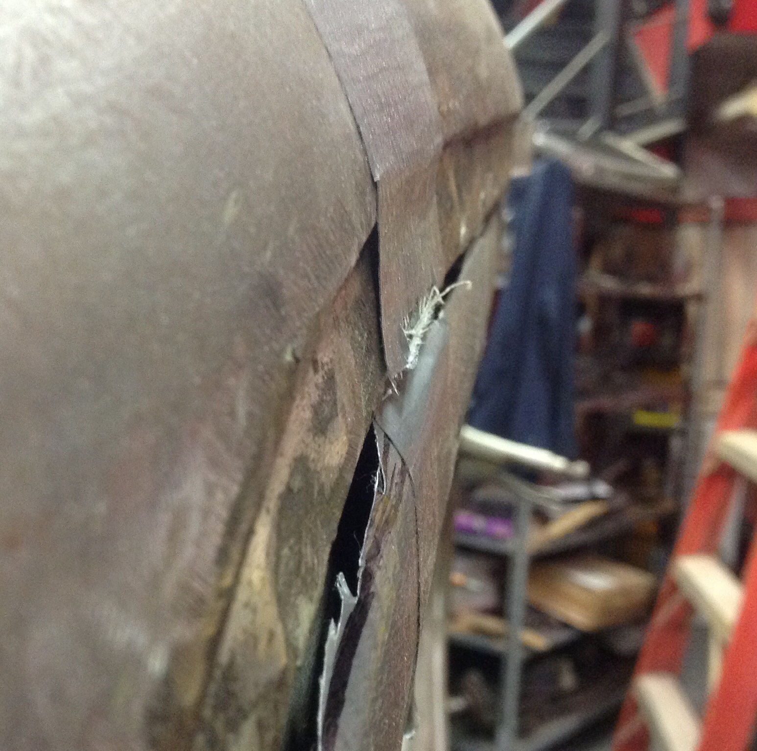

  10. They are spot welded on.
    The roof skin has a recess to accept the drip rail.
    Maybe this will help you see what you are dealing with.
    Here's what the roof looks like with the drip rails removed on a 36.
    Here's a cross section
    If you want to remove them without damage, tackle the rust and reinstall I think it would be tedious job but very doable. Some gentile wedging should show the welds and then you can tap the high spots back down. However if your mission is rust- you can see there may be plenty between the roof skin and door jamb too.
