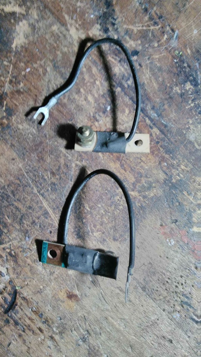

    Can't get much easier than these...been running them in my car for years and no problems...... 1546056252237.jpeg
    Sent from my QTASUN1 using The H.A.M.B. mobile app
    Baron likes this.
