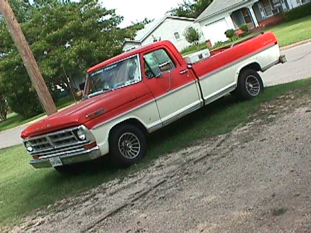

    About 4 yrs ago I rebuilt my tired 360 FE in my old '71 F100. I had it bored .060 & put in a new cam & kit. I used a Mellings RV grind. Don't remember the specs, but I'm happy with it. Didn't hurt the fuel mileage any either, (it's always been low, 10-14 mpg). cam is hydraulic & not expensive $. also have a C-6 auto in it.
    Bob
