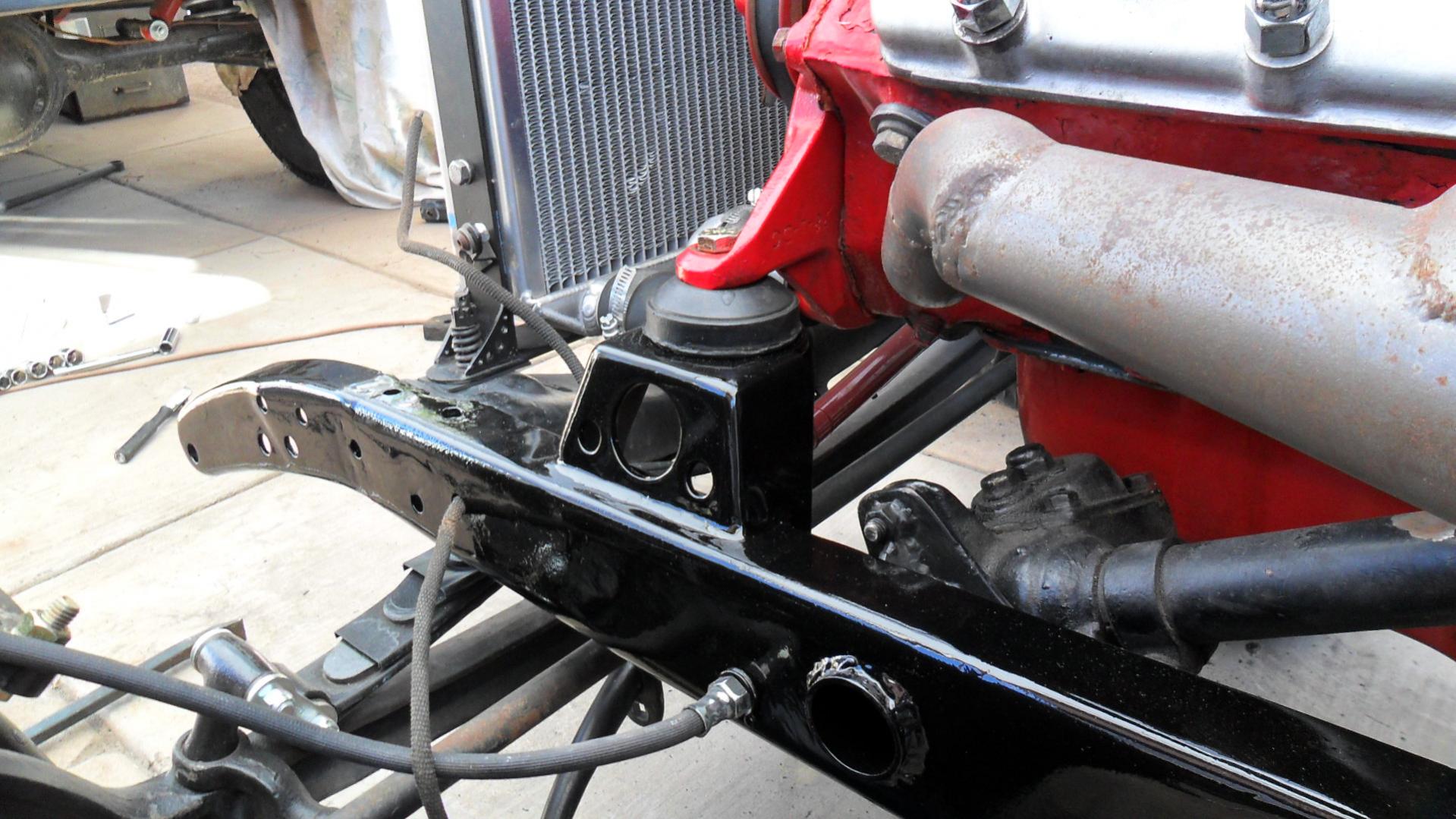

    It doesn't have the fan pattern spray tip, but I have been using lots of Rustoleum Appliance epoxy enamel lately. Warm it up a bit before you spray it and prep well underneath and it'll lay down like glass.

    Looks AWESOME. What primer/rust treatment are you laying down underneath that? I'm currently treating my frame with a mix of a rust removal sponge thing-a-majinger and brass wire wheel...then an application of Ospho.

    Just bare metal, Dupli color high build primer sanded to 400, warm the can in hot water and go. About seventy degrees out side temp.

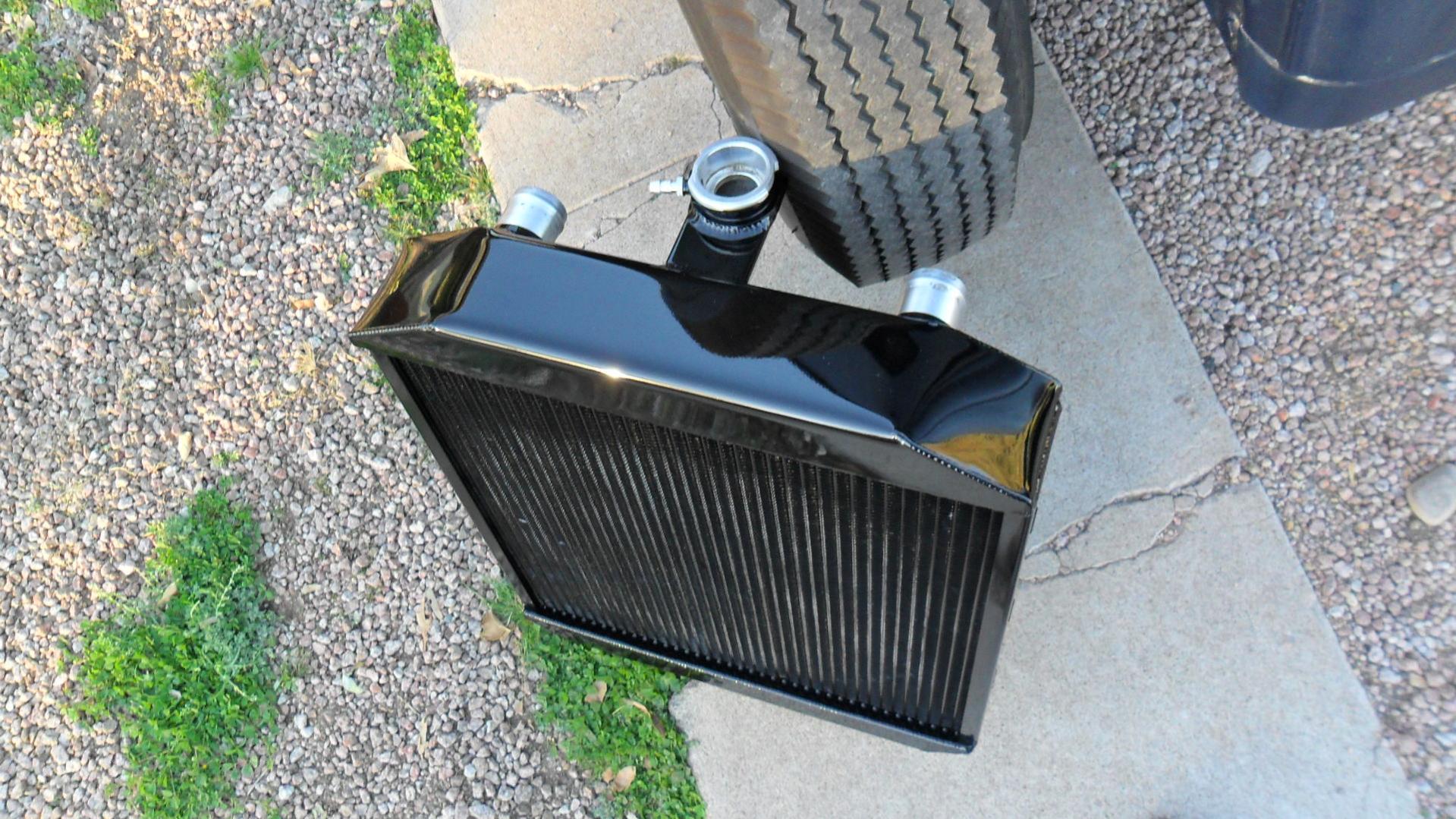

    No real flash rust to contend with in AZ! I just cleaned everything up with a 3M coating removal disc and shot the primer over the bare metal. Just make sure to warm the can in hot water in the sink before you shoot. Nothing too exotic. I'll post a picture of the radiator I shot the other day on this tomorrow... I can't believe it's out of a can!

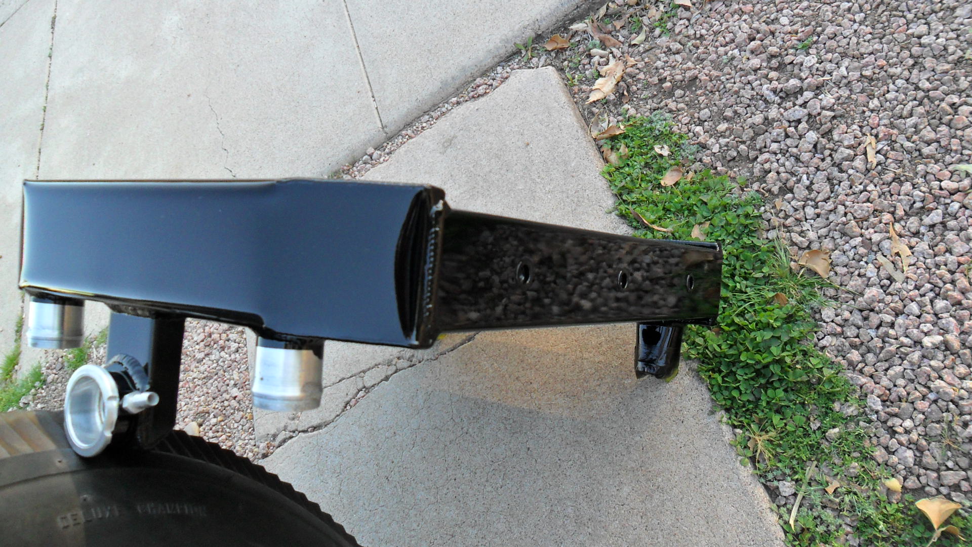

    Thought I would add to this with one more shot of the Rustoleum Epoxy enamel. I'm just flat amazed at this stuff!

    And this is the appliance enamel piss can?? Holy shit!!! Their industrial gloss black that comes in the gallon size is some beautiful strong paint as well

    And, I'll go you one better... That radiator I just showed is an aluminum unit that has been run a bit since it was installed last summer. Just cleaned it, scuffed it down, sanded a couple of nicks and shot... No primer, no heavy prep. It was even only about 60 degrees the other night when I shot it! That's like below freezing in Arizona terms! Just warm up the can in hot water for about 15 minutes before you shoot.
