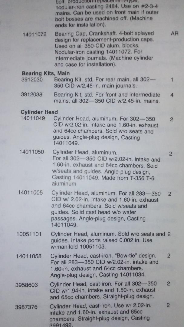

  12. DDDenny
    Posts: 11,445
    All of these are modern style heads but none have the casting identifiers as a "true" camel hump head, not important for some but a dead giveaway of a NOT traditional type build.

  28. DDDenny
    Posts: 11,445
  29. Fordors
    Joined: Sep 22, 2016
    Posts: 1,814
    Fordors
    The photo above was lifted from a post by @big duece. There was also a ‘441X SBC head, but unlike the larger runners on a ‘461X head the ‘441X had 80cc chambers instead of the typical 76cc smog chambers.
