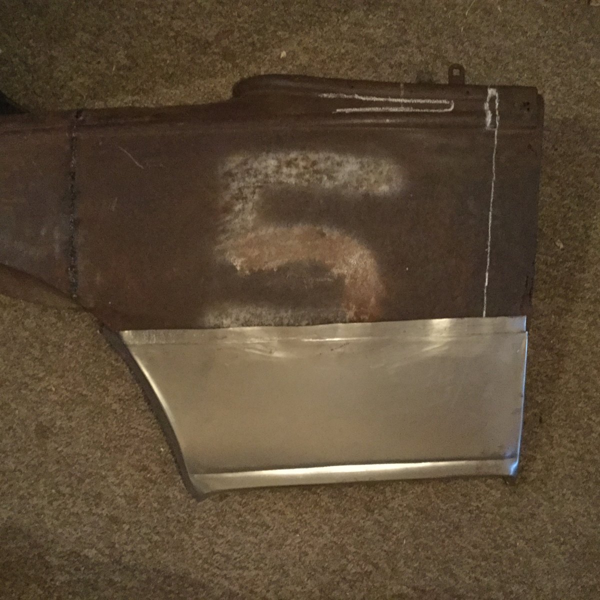

    but if you pay the top dollar for beltline down patches, you will get compound curved skins,
    they fit well, [I cut the 90* strips off the ends, weld the outer skin, inner skin and the fold over strip all at once] then sand flat with a 3" belt sander...
    but the lower beads are just a curved radius where some are a tight 90*, a flat and another tight 90*..
    so I bought [4] total, one each door, the others split in two and used for cowl and bottom of the quarters... this was more money, but the tall patches let me remove a lot of pitting along the bottom 1/3 of the body …
    pix of a '30 coupe, note the hight of the patches... all the bottom beads matched... scoop__ last day here 004.JPG scoop__ last day here 006.JPG

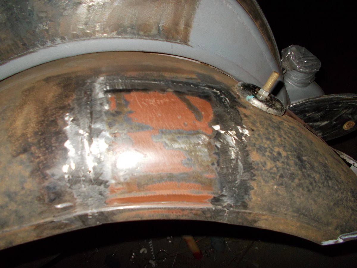

    I patched a fender with a piece from another...
    the thickness [hight] of the outer flat bead was different...
    I may leave it or weld the patch on end and grind and sand to fit...
