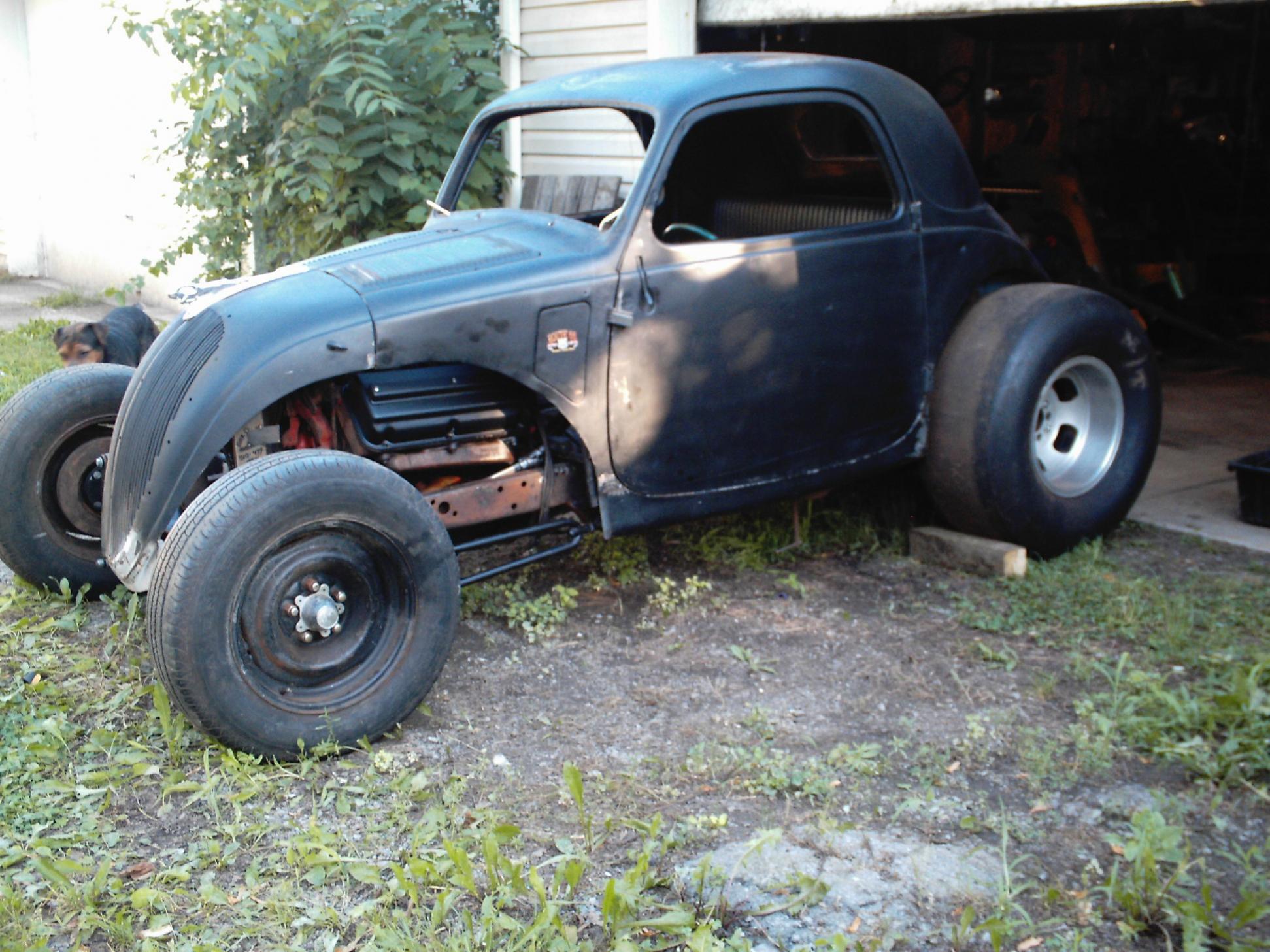

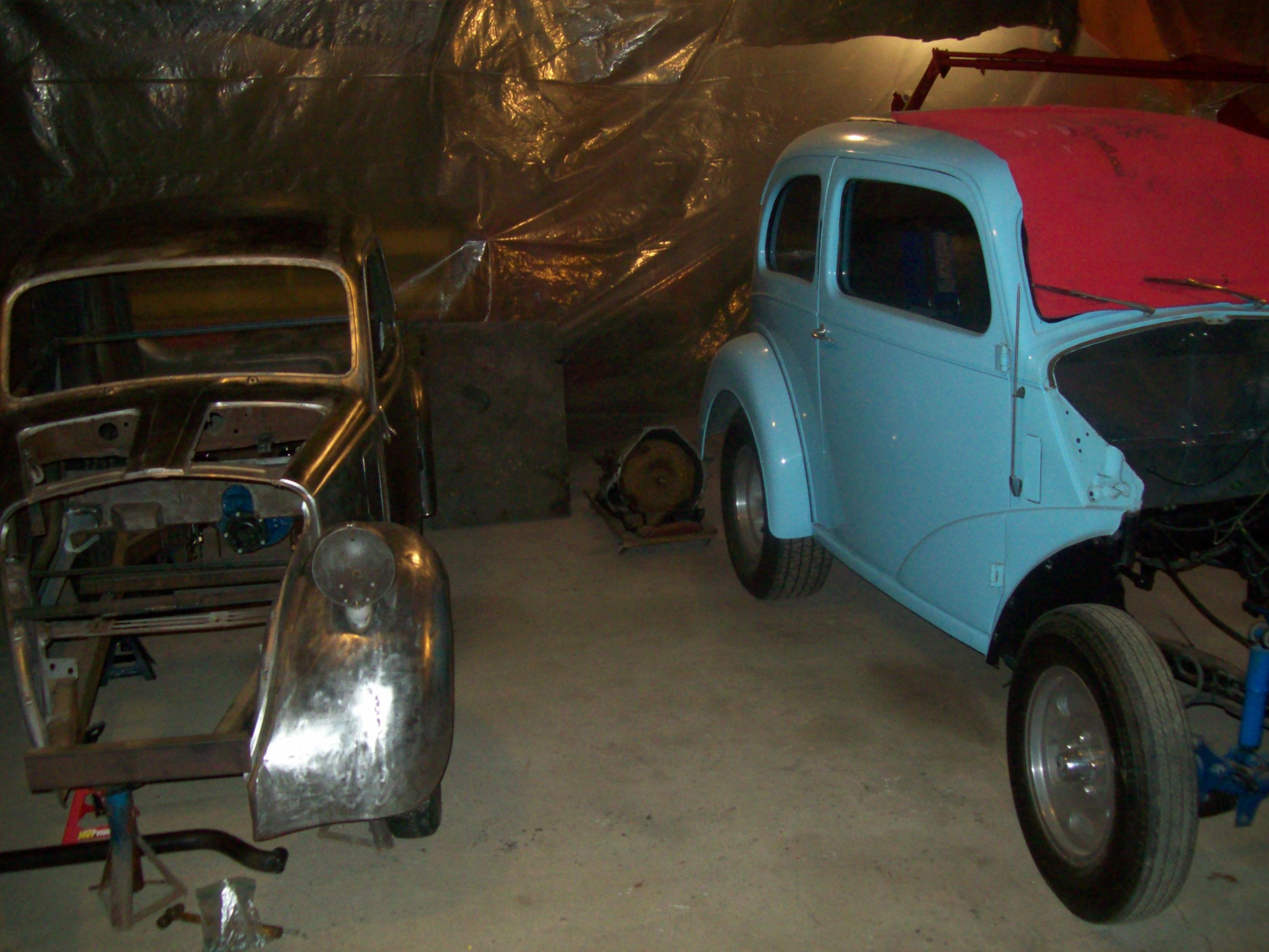

  12. no room for forward master cyl...i've set the hemi back as far as i could... within reason...first pic is of Fiat Gasser Bob's dad's anglia parked next to his forgone..same thing as a topo front wise ..doors too.to give a general idea of how big a topolino is,,,,..
    second pic gives decent perspective of the hemi's set back,,,figure with WC T-5 attached i got the weight a good bit rearward...trying to avoid gettin too "nose heavy"

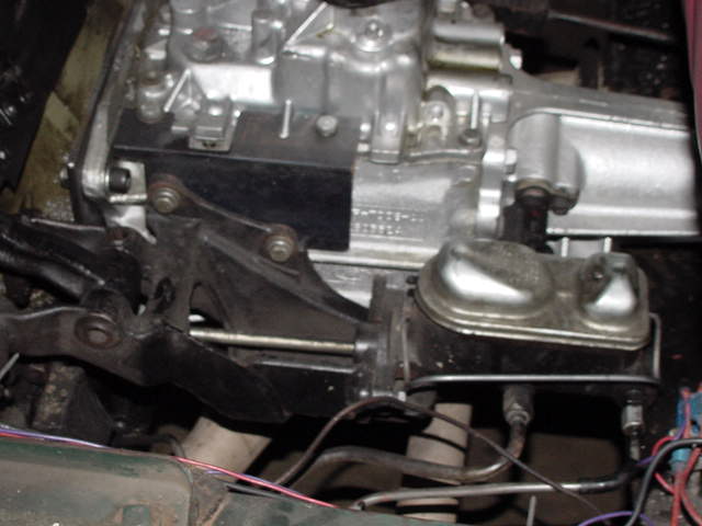

    Larry the 10# valves your talking about are Reserve Pressure Valves RPV not proportoining valves ...... proportioning or brake bias is by a manifold
    This is a Mustang II master and control in my 39 GMC
    Yes that's a Ford T/OD trans too.
    Follow the lines to the little comtrol manifold..... Use the power brake master you'll get more back brake........
    AND Don't fuck this up you'll get hurt NO JOKE-NO SHIT!!!!!!
    AND I don't want that to happen!
    If it were mine I'd get a Neal two cylinder set-up and make it fit
