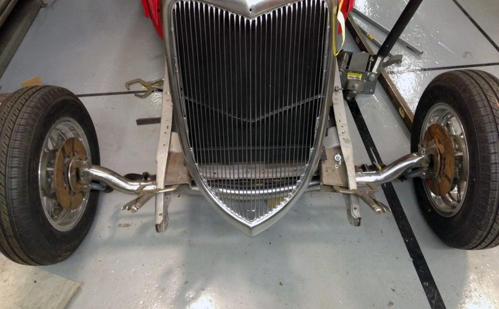

  8. Here's a 46" axle on a 33/34
    There's a mopar double dip in front of it.

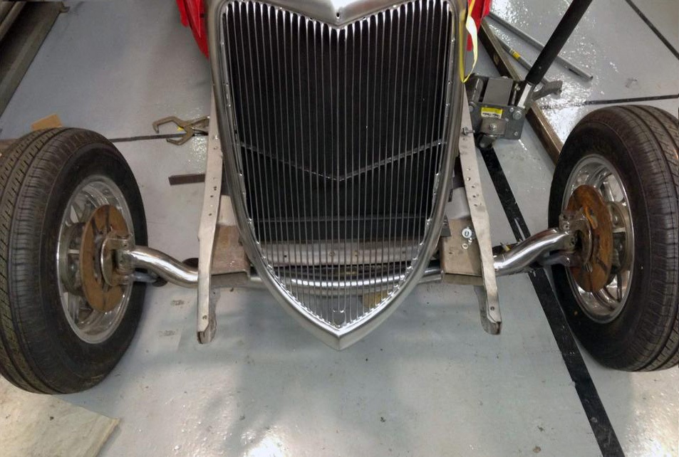

  9. Here it is with the dodge axle
    Too wide.

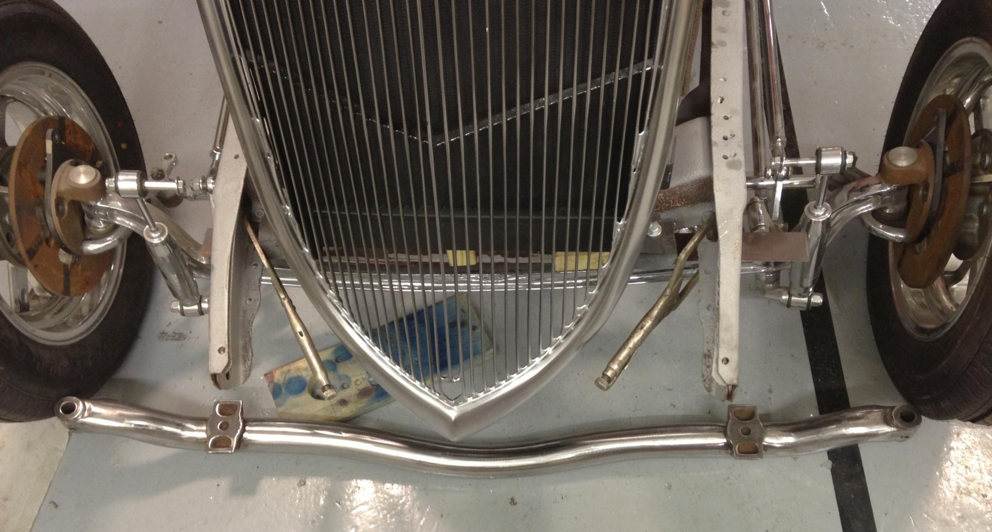

  10. Here's the dodge axle photo shop narrowed to 46
