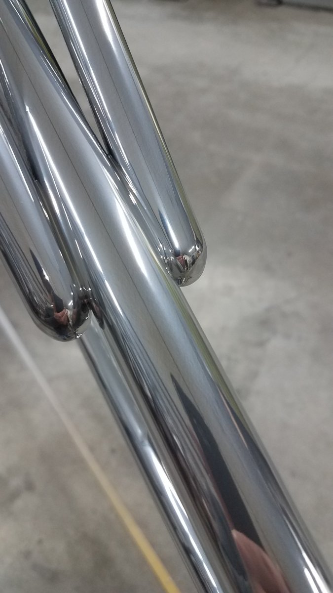

  25. I own a powder coat shop. These are some recent parts I coated in chrome powder. Down fall it's the least durable powder. The manufacture recommends applying a clear coat over the top but all that does is dulls it. Looks like a polished aluminum when you put clear over it. These pics are parts with no clear. If it's in an application where it's not going to see weather or abuse it would be fine. I've done like interior trim parts and what not with no issues!

  30. This is the new chrome powder that Prismatic came out with a few months ago. Looks decent, still not like real chrome. And yes it's not very durable. You don't want to polish on it or scrub it. Glass cleaner & a soft cloth are about it to clean it. I coated some interior trim pieces for my brothers 35' Olds project, not bad, he was happy with it The parts in my pic's are display pieces only not going to be touched much. Chrome powders were designed basically to be used as a base coat for transparent's & candies.
