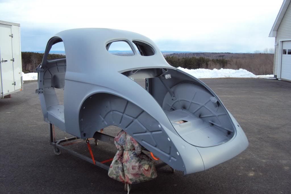

    That must be such a joy to block sand. I'm a big fan of muiti coats of primer, it may cost a bit, but what good is it having leftover primer in a can? Bob [​IMG]
  5. ME.GASSER
    Joined: Sep 18, 2007
    Posts: 3,627
    ME.GASSER
    We used 2 gallons to do the all the body parts. With three of us sanding it went fast, We waited 2 week between the last 2 coats. I wanted to give the primer time to shrink!!! My bodyshop buddy knew that my hands needed a break and he needed to catch up on some collision work. It worked out good for both of us.

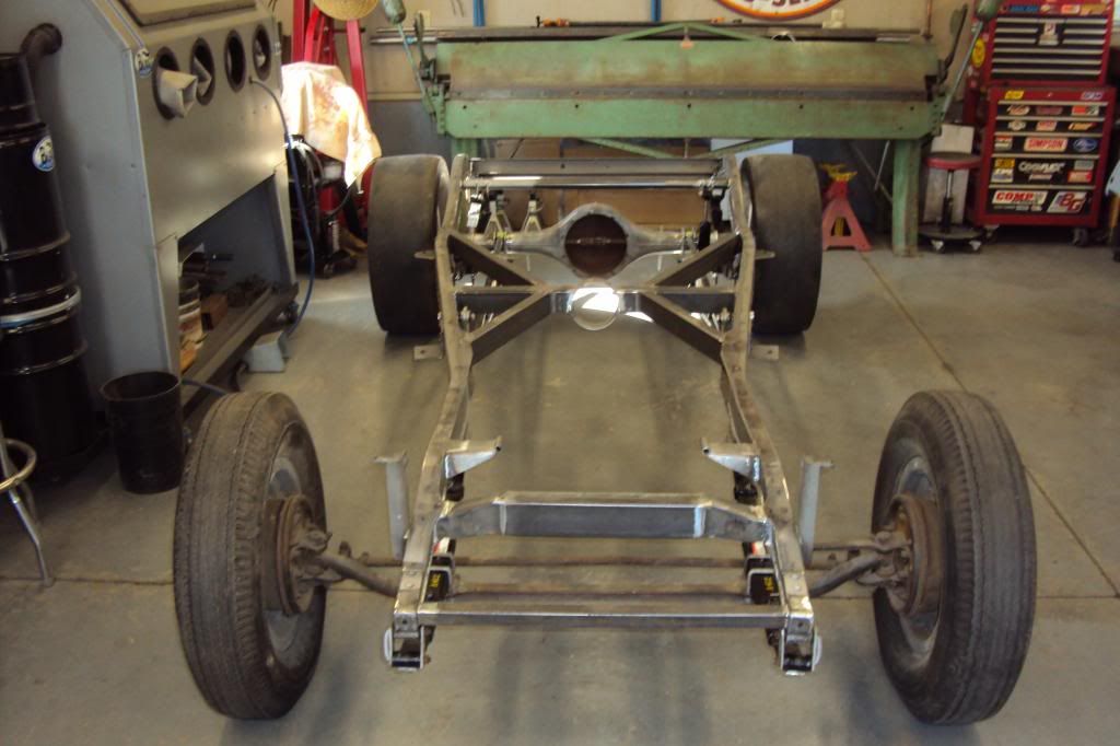

    It's been awhile since I've had time to work on the Mystery Willys. In the last couple of months I was able to strip down the frame that I purchased. I boxed the rails and built a new x-member. The picture shows the drop out transmission cross member and the modification to the front cross member. I didn't want to modify the firewall so I had to move the cross member to have room for the motor. [​IMG]

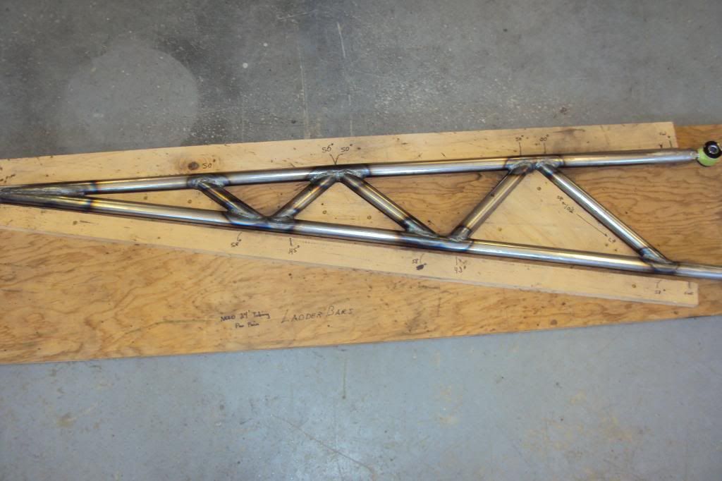

    This is the jig that I use to make my ladder bars. [​IMG]

    The rolling chassis. The next few pictures will be of the ladder bar setup. A few people have asked me to send pictures of this setup. [​IMG]
