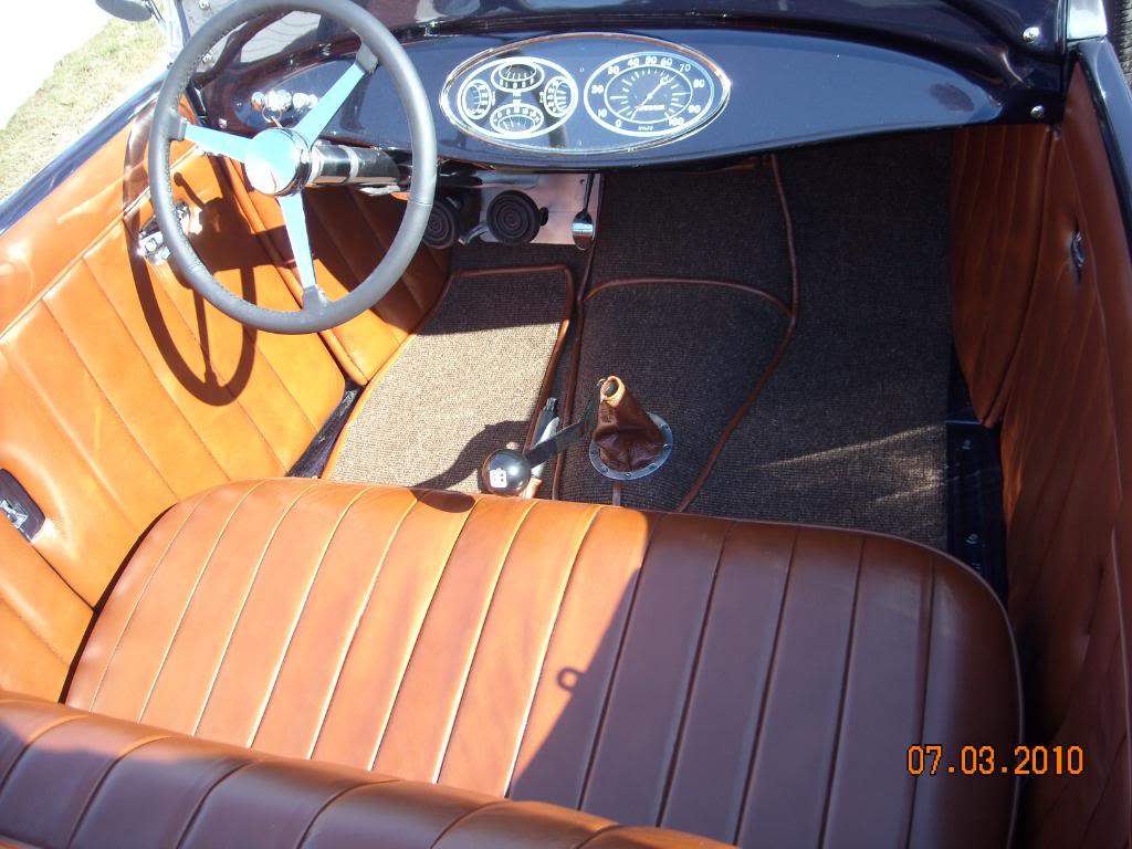

  10. High density foam and plywood works great and when covered it doesn't look like a mini van seat. HRP
  11. ...Second row 90's Dodge Minivan seat in my coupe project...
  12. ^^^^^ That looks like a jeep rear seat to me. Judging by the fabric and shape.
    Fits good...
  13. ...You're probably right!.. It was in there when I got the car...Thanks!

  19. Oldmanolds
    Joined: Jan 16, 2006
    Posts: 930
    Oldmanolds
    Here is my answer to the same problem I had. The oversized lumbar is for a bad back. This seat is great for trips 4 hours or more. Before with the buckets I had I was good only for a short trip.
  20. All the parts are available to rebuild a stock seat. Wood kit for the seat and back platforms and spring units. Ends up about $450.00 for all, plus upholstery. Lebaron-Bonney.
    If you are looking for original style, made well, it is another option.
  21. I narrowed an '84 Ranger seat by about 6" if memory serves me and I am using it in my '32 pickup. It is comfortable, adjustable and the seat back tilts forward for access. I cut the foam with one of those electric carving knives and glued it back together with spray trim adhesive.
