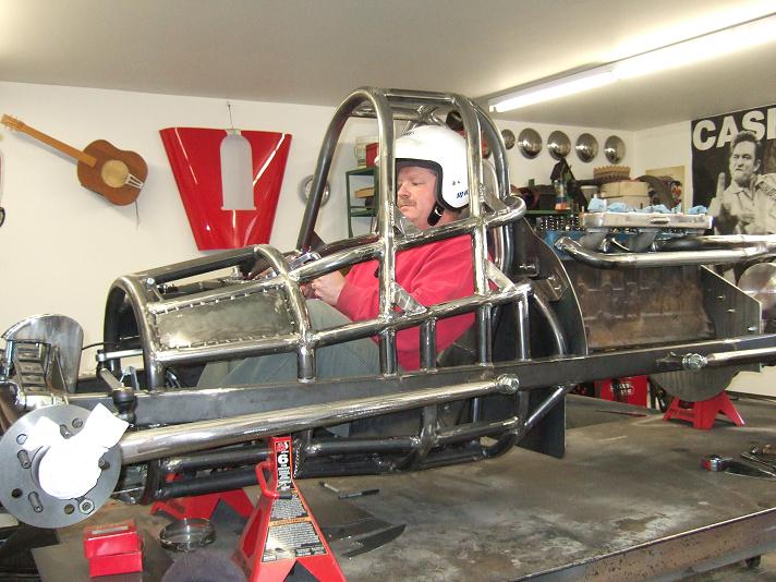

  3. super stout cage, well done, but I'm interested to know why you didn't extend the car a little and lay the driver back a heap and get his head and torso out of the wind? was there a reason you went this path?

    Good Question: I only have 4" from the front of the water pump to the back of the seat, minus the dia. of the tubing and the thickness of the firewall. Straight six, scatter shield mated to a Muncie 4 speed leaves very little room..... If I could have extended the car I would have, I am already at 132 " wheel base with only 55" of room for the driver....
    The head rest is not on the tank as of yet, therefore; the drivers helmet will be almost level with the top of the head rest which runs the entire length of the tank, from the rear of the cage. The seat is already at 20 degrees lay back. 4" of tubing will be above the head rest... The head /intake for the 302 will actually be in the head rest area, as the tank has a "flat bottom"......

  6. thanks for the explanation, and can appreciate the realestate disappears real quickly. One forgets how tall those inlines can be.

    I do new car inspections out on the salt and I try to keep an eye out for these new builds. I see you've got your mock-up cranium in place. Any chance you could hop in and have someone snap some pics?

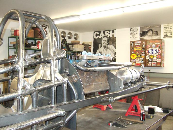

    More progress pic's.... Firewall, parachute mount, push bar and header is completed.....
    Fire bottle is installed, next will be the shifter linkage and battery box instal....

    Awesome build, Cant wait to see it on the salt. Love that Johnny Cash in the background thinks it is #1 :) Got the same poster in my shop.

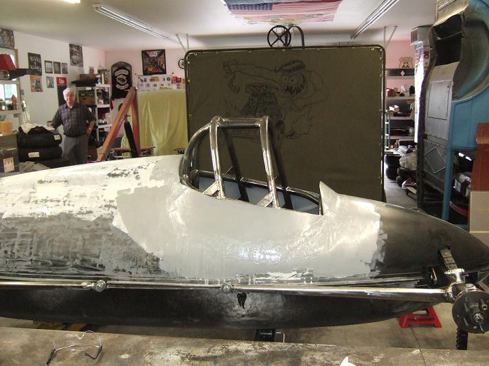

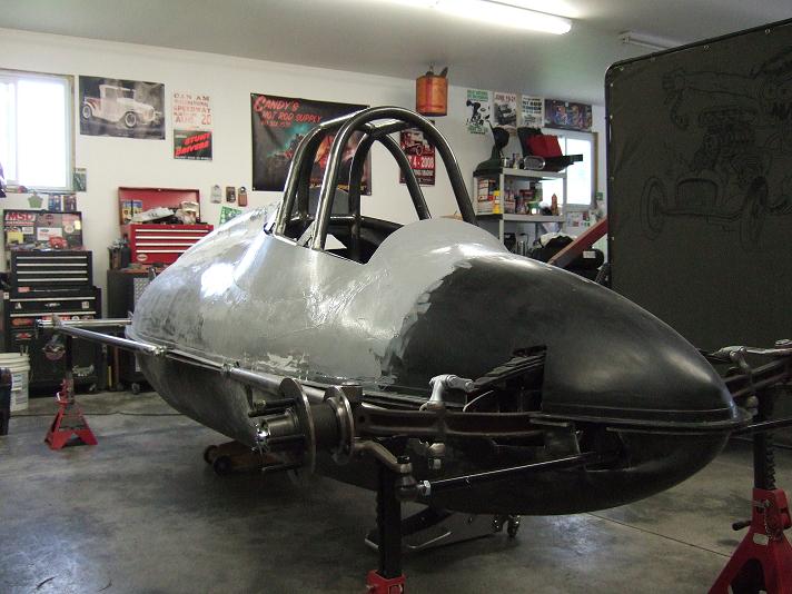

    Well, slight progress during the last few weeks, however; the tank almost fits the frame. More trimming and flanges to be added to hold the body to the frame.
    The cut out on the drivers side is for the 5 deuce Howard Intake and header exiting the tank.
    The hole below the push bar, the good ole' parachute, which fits inside of the body.
