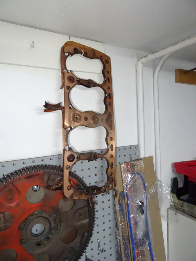

  10. my engine is a 304CI with Scat Crank and rods, Ross Pistons, Potvin 425 ground by Pete One on here, ported and relieved, 471 Blower, now with a 650 Holly double pumper
    I have tried 10% under and 10% over on the blower, under not enough boost, over was using copper gaskets as fuses as too much boost, am now running a 6" dia pulley on crank and a 5" blower pulley gives me 7-8 lbs of boost at 5000
    and everything is happy.
    On the two port FI we still haven't gotten the bugs worked out yet that's why I'm going back to gas for Mays Race. I think I am having cavitation problems with the pump feeding from a 2 gallon Moon tank. I need more time to figure it all out and I'm getting impatient so its back to gas for may. Could also be the four port that I made into a two port may be part of the problem, started out with 4- 40 nozzles, to fat went with 4-38's and still no help ...............sent you a pm if you would like to talk...........

    Thanks for the reply Carl great info, the state of that head gasket:eek: I'm gonna have a good read through your FED thread when I get time..its long.

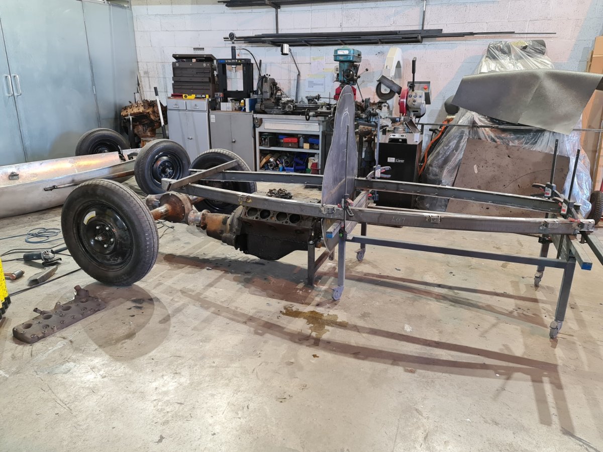

    from Swansea UK
    Had lots of time on the tank over the weekend and last couple of evenings. Took it all apart as I wanted to lower the front crossmember two inch to give better ground clearence and also to move the axle, engine gearbox back a couple of inches aswell as things were getting a bit too tight.
    All in bitz
    Welding it back together..
    Could definetly do with a good chassis table, but this did the job....
    and all back together with the fire wall welded in I was finaly able to cut the top rear half of the tank to fit, been dying to do this to get more of a image of what its gonna look like finished.

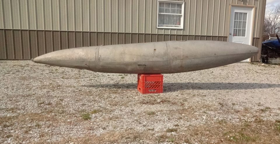

  29. I took this photo of a Belly tank on my last trip to Bonneville to use as a reference. With the wheel and hub removed it give much more access. JW
    Jet96, AHotRod, JamieUC and 2 others like this.
