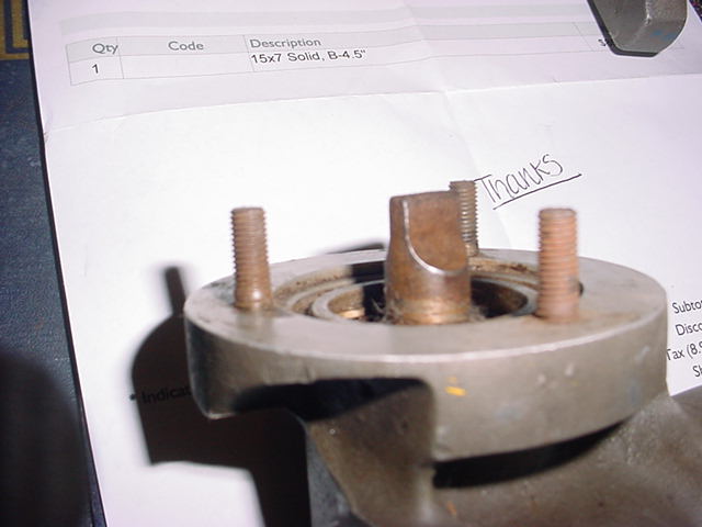

    The pump I'm using is a hex drive not tang but with either pump its probably best to keep the run out to a minimum.
    I'm not sure where I got the 5 thou figure from, I will double check, got a couple of Hilborn and fuel injection books.

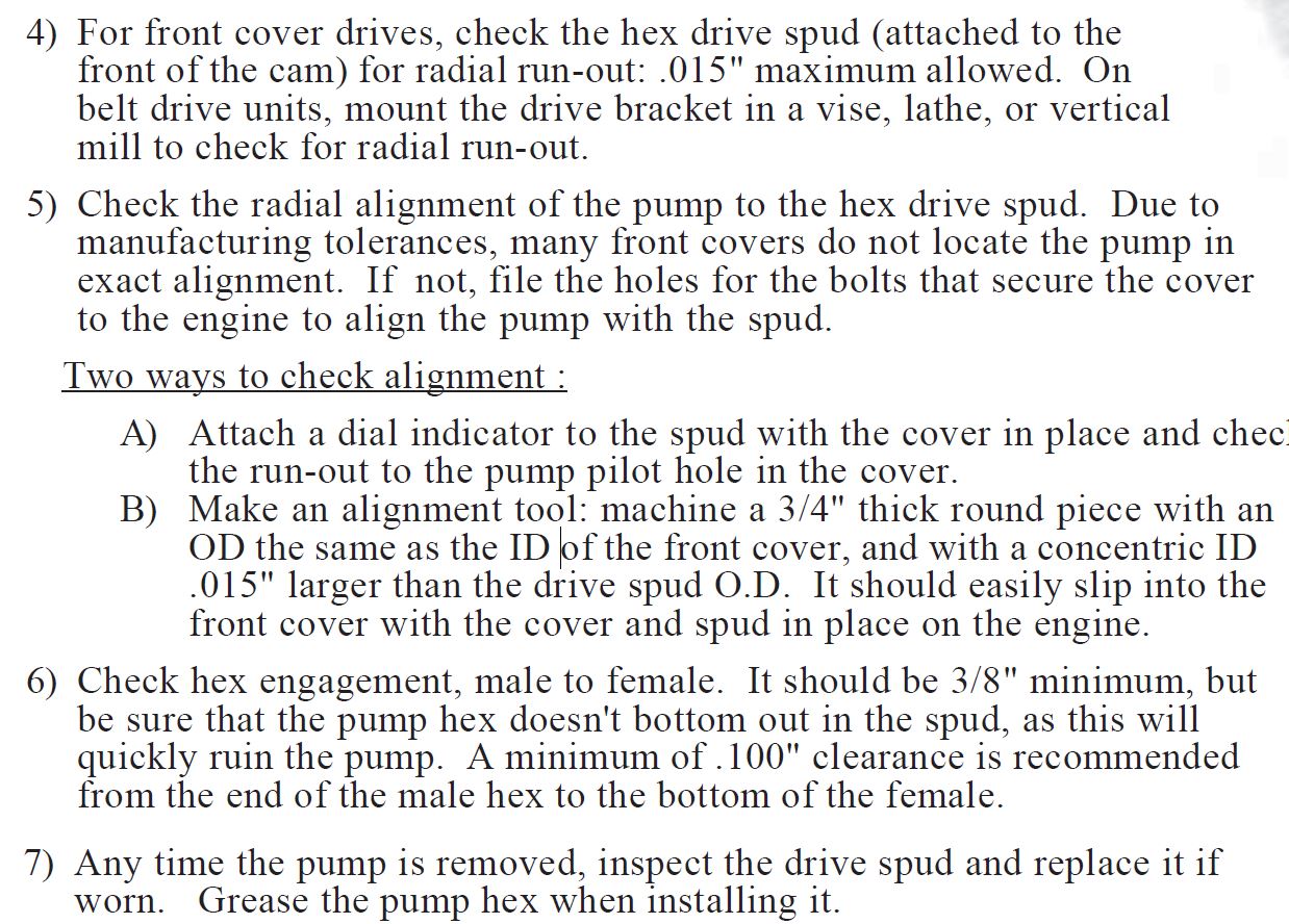

    I couldn't find anything in my Hilborn literature, but Kinsler offers the following:

    Great info, I like the collar idea could be used as the timing cover is fitted , just incase theirs a little bit of movement in the cover.

    The collar got me thinking. The timing covers on the Holden motors are a very sloppy fit. They already have one hole in them, for the crank harmonic balancer lip seal. To get that seal centrered, the cover/seal assembly is loosely bolted up, and a sleeve put over the crank snout in lieu of the balancer. The sleeve centres the cover/seal, which is then tightened up. Remove the sleeve, install the balancer.
    That amount of freedom in cover location might make getting 0.015” runout a challenge.

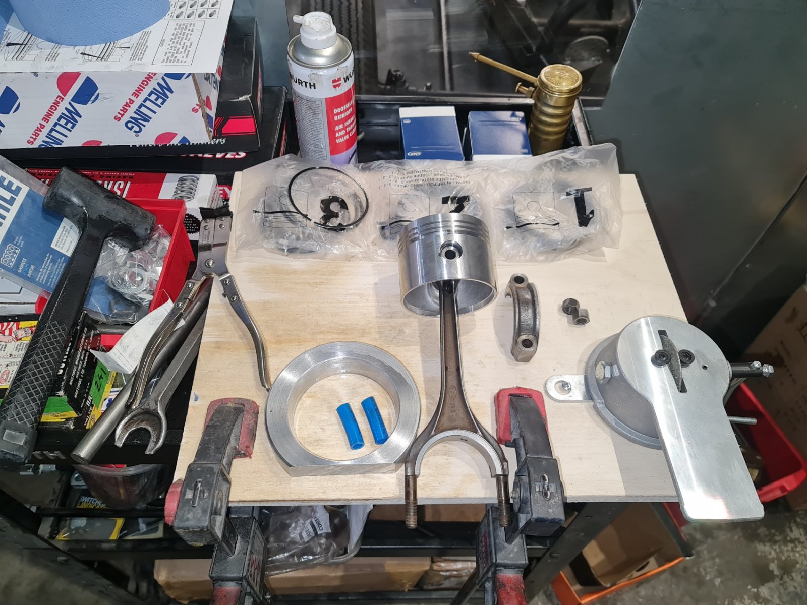

    Made some good progress on the engine this weekend, cranks in, cams in, Pistons are in and valves are all laped ready to go in just waiting on keepers to arive next week, someone... I forgot to order them

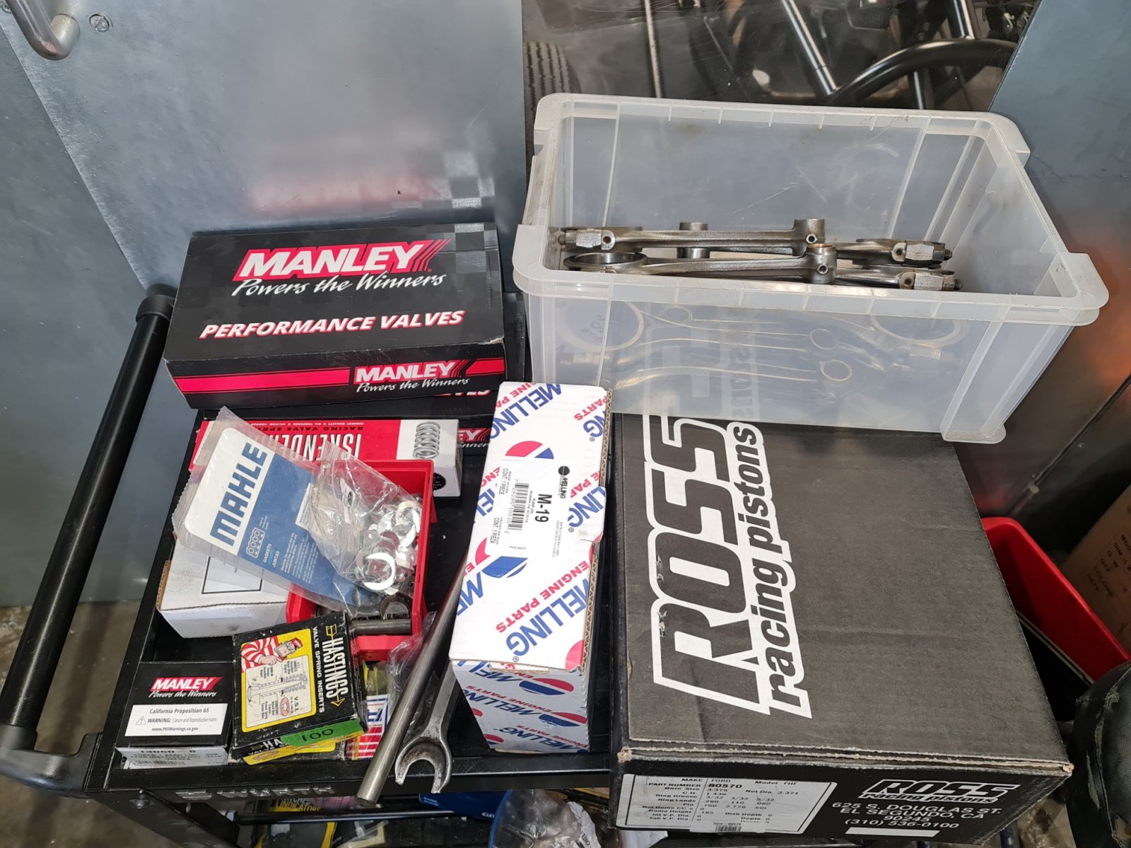

    This is whats going in there, looks like Christmas all stacked up on my trolley.
    My litle set up for sizing and fitting rings.
    This litle tool comes in well handy its a Hall valve depth gauge designed for working out what lenght to grind the vales when using solid lifters, I'm using adjustable lifters and this makes quick work of setting them all to correct clearence before the valves go in.

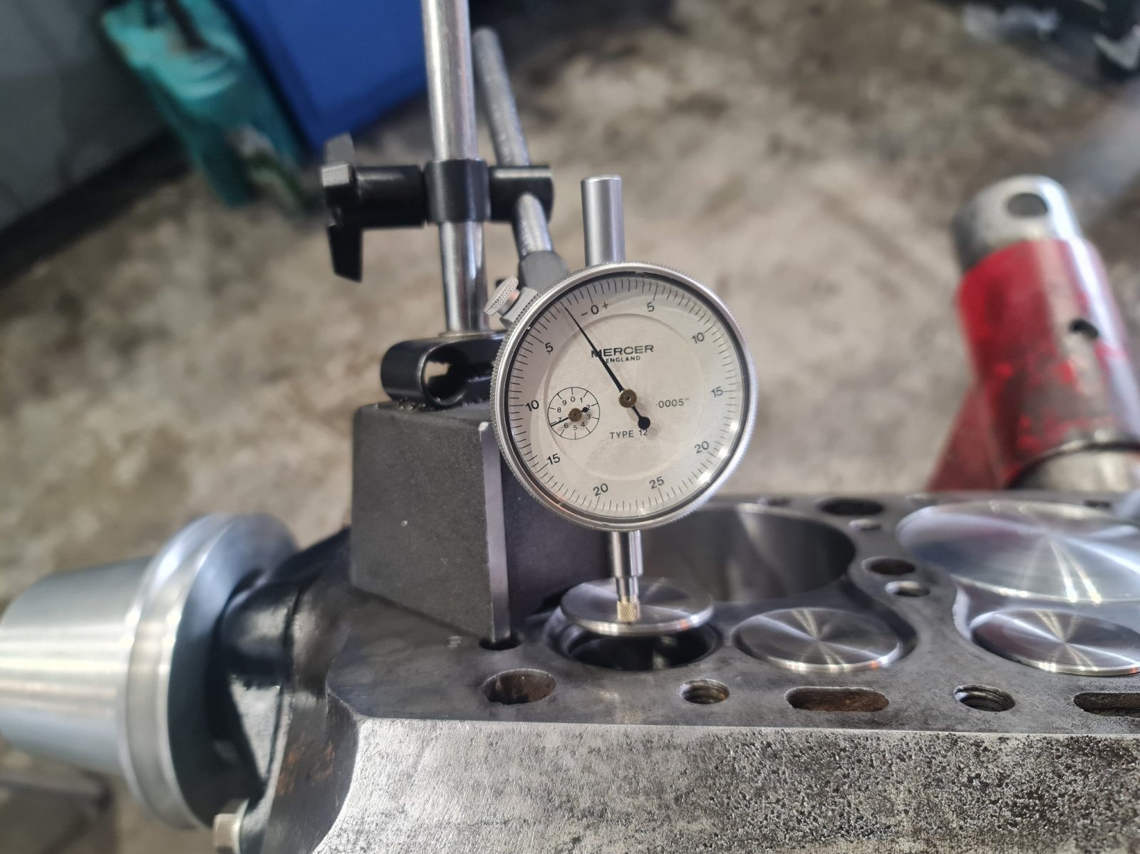

    Checking the valve lift

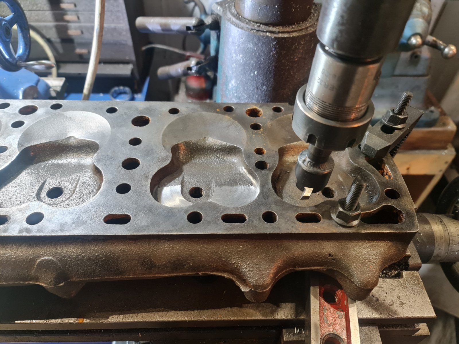

    A bit to much lift for the 8BA heads I'm using, so time for a bit of milling.
    And finaly a bit of a blend, nothing overly fancy just a quick blend with the die grinder and some sanding cones.

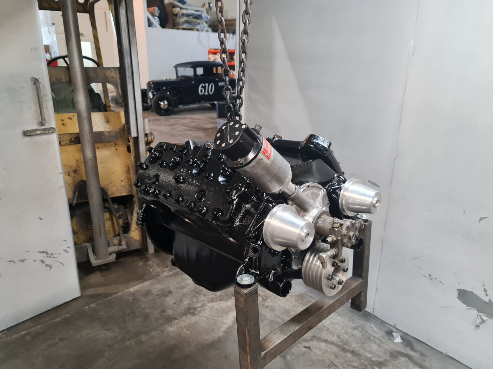

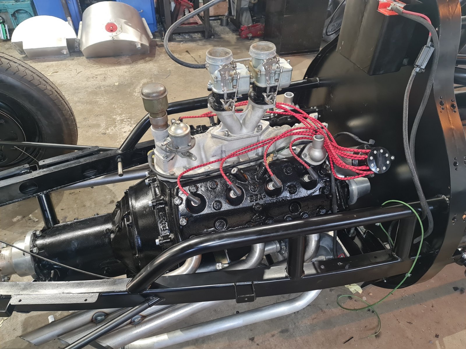

    Got the engine in this weekend, thanks to Geoff and Steve for lending a hand, spent most of yesterday making a hold down clamp for the magneto and making up a set of cloth covered plug leads, I wasnt sure if the red might look a bit blingy but very pleased with the look. Did all the wiring today and fired up the engine for the first time. only a quick 20 second run as Ive not got coolant pipes all plumbed yet. Very nice to here it run especialy with Pendine getting imminently close. Hopefully get all the coolant system finished and bleed the brakes this week and then I can do the cam break in and have a spin around the car park, I will do a video as soon as its all plumbed.
    Ive borrowed the intake off my coupe to do the break-in, hoping to get the supercharger fitted for Pendine but if I run out of time the slingshot manifold can stay on.
