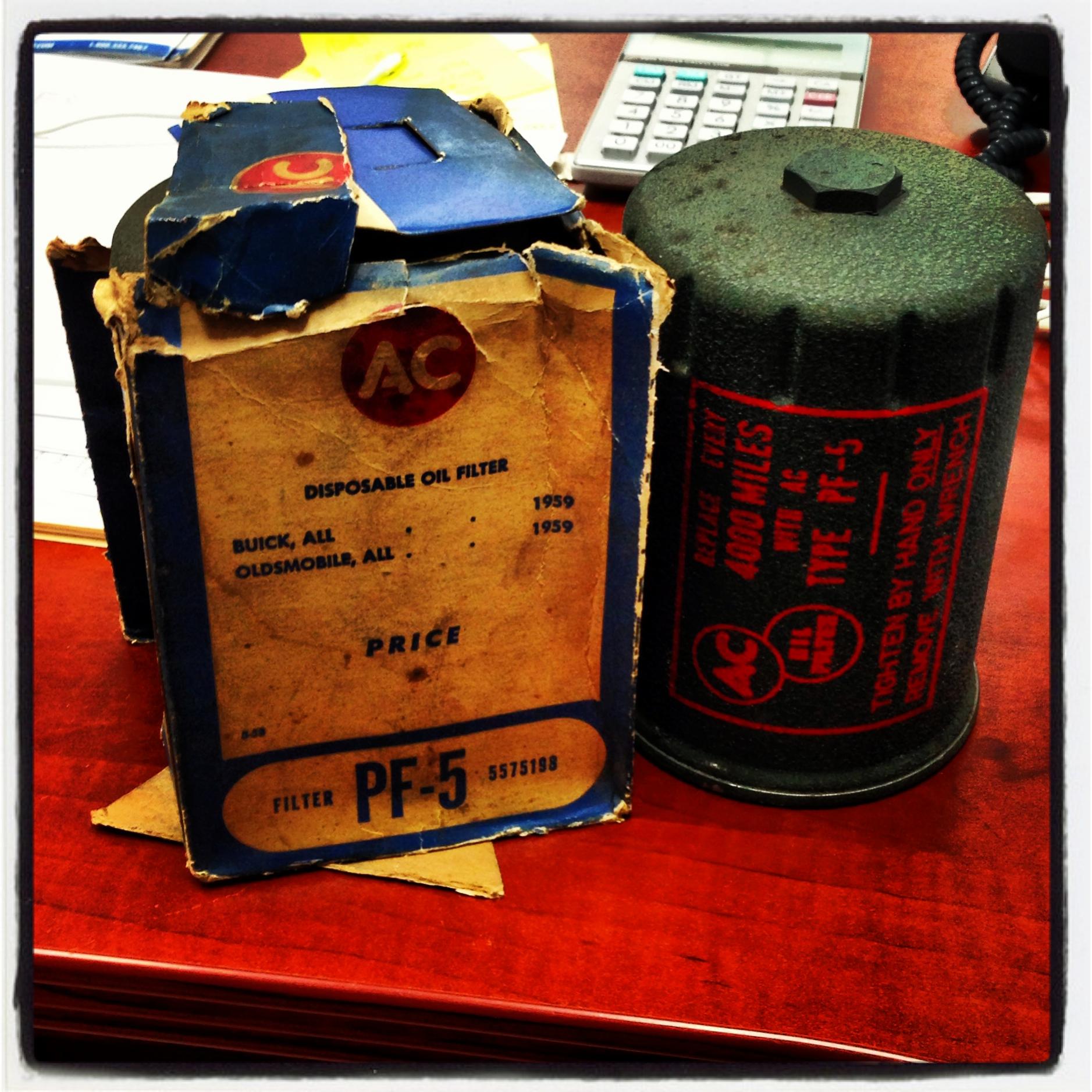

    I thought I would send a few pics of progress on the Beebe Bros and Sixt AA/FD! Work is continuing but it's not as fast as I would like. The key item is that we're moving forward not backwards! The front radius rods are all completed and all the diagonals have been added to the front end of the car. The ultra rare AC-Delco PF-5 oil filters have been found and I've got 2 NOS unit on the shelf. A fresh 3.90 gear 3rd member and Olds drum brakes have been secured. From all pictures I have of the car during the 1st phase of it's life it was sporting Drum brakes so I'm going with them! I have about 4 more pieces of tube to put in the frame and then it's time for final welding. The cage will be installed after I get the thing off the jig and down where I can see things a little better. I'll be checking up with the S&S boys hopefully this week as I believe all the final machine work to the block is done. Balancing the rotating goods is the only thing holding up the assembly of the short block at this point as I have everything I need for that. Oh, and super cool news! I called Jerry Jardine and it turns out he still has JIGS to make his Zoomies from back in the day. I shipped my ultra nice Don Ross flange plates off to them last week to get a set of "Real" Jardine's for the car. The list goes on and on.....
