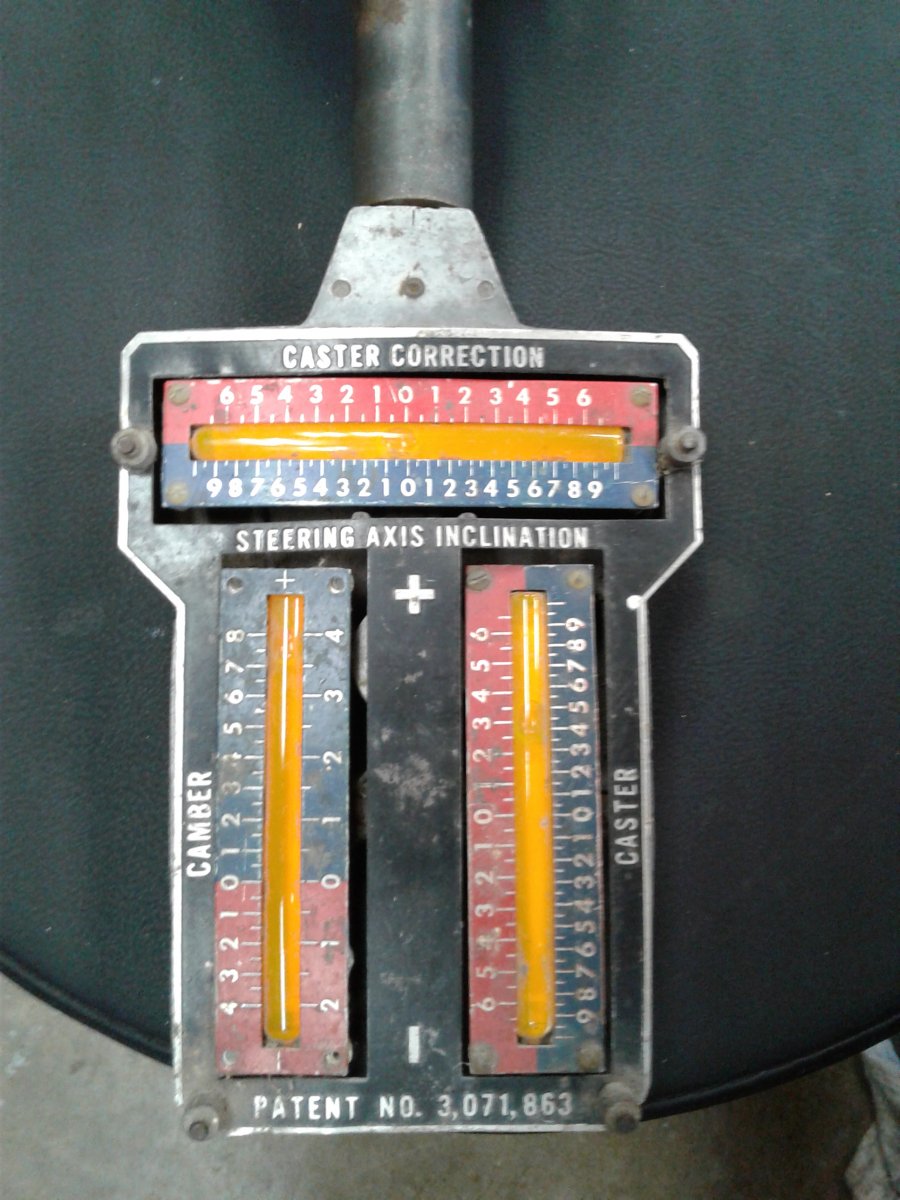

    Is anyone familiar with the old BEAR #27 spindle mount alignment tool? Why are there two sets of scales on all three bubble levels? Thanks 20200514_202403.jpg

    Standard equipment in a front end shop 50 years ago and what the guys with the fancy electronic stuff will tell you that their 30K machine is "as accurate as"
    You pop the dust cap off, wipe the grease off the hub and the magnet should stick to the hub.
    The camber gauge is just that a camber gauge that tells you the camber angle of the wheel plus or minus. No calibrations or setting it.
    The caster correction gauge comes into play when you turn the wheel out 20 degrees at the front, level that gauge to zero and then level the caster gauge with the thumb screw on the back side. Then you turn the wheel so it is angled in 20 degrees at the front and read the caster.

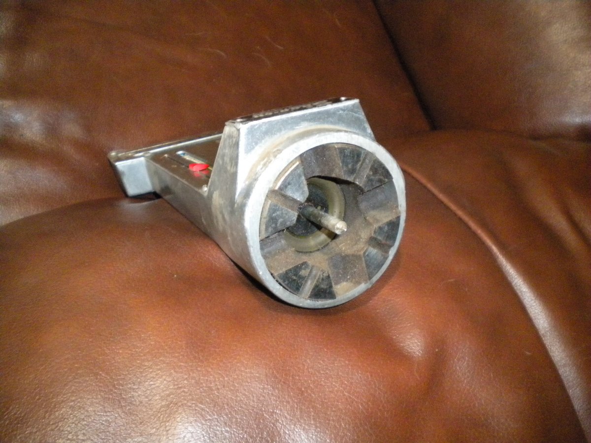

    Here it is, I had to go out and feed the cat so I pulled it out of the box.
    I need to send it in and have the camber bubble repaired.
    Second shot shows the instructions on the back and third shot shows the magnet that sticks to the hub. There is one gauge that the caster function works in reverse of the Snap-On but I don't remember which one.

    BONEYARD51- The one we have is a hub mount we just had the magnet off. All the ones I see for sale only have one scale to read on camber/caster. I'm trying to figure out which scale to go by. MR>48CHEV- Thanks for the pictures. I think I know why there are two scales for the end (KPA& caster correction). Now just hoping to find someone to tell us which side to read for camber/caster.

    Camber reads on the camber side. Once you stick it on the hub you look to see what mark the center of the bubble is on an if it is on the + or - side. Plus the wheel is leaning out at the top. Minus it is leaning in. That is the bubble on the left side of your gauge that says Camber. If you stick it to a steel cabinet or post in the shop that is perfectly vertical it should read 0.
    I bought a Quick trick caster camber gauge set a year ago just to get the plates when a guy had them for sale. The metal plates with grease between them will work or a couple rounds of masonite with grease between the smooth sides should actually work. The idea is to get the wheels to turn smooth without the tires binding up on the shop floor and to be able to settle the suspension easier. Any time I make an adjustment I bounce the vehicle a few times to get the suspension to settle out so I get an accurate reading.
    CASTER your gauge may be the one that you turn in 20 degrees zero the gauge, then turn out 20 degrees to read caster. That is turn it in 20 degrees at the front. level the caster correction bubble (red) adjust the caster gauge to read zero and then turn the wheel to where it is 20 degrees out at the front and read the caster. It appears to be backwards from mine. If you know someone who has a gauge that they use regularly or have a buddy who does front end work in a shop you might want to take the gauge over and have them confirm exactly how to read it. It will take using it a few times and remembering the steps but after a few times it will become natural to you.

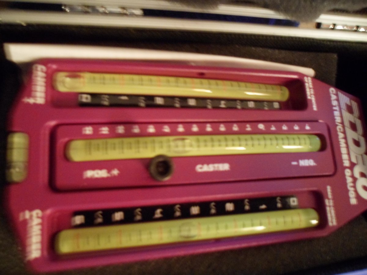

    I seldom use it and definitely don't have a full grasp on the use of it but, it has all of the scales labeled and directions on the back. IMG_3521.jpg IMG_3522.jpg

    56C3B6 - Thanks for the picture, looks like we use the outside scales for regular camber/caster readings. We do have turntables, it's just that the instructions were not very clear on the back of the tool.
