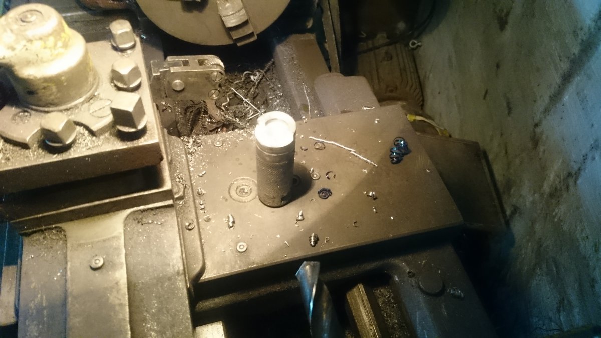

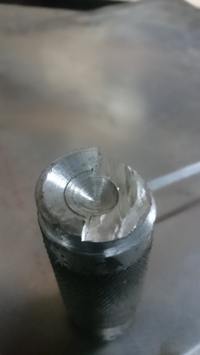

    The difference between dies I use and Lazze's ones is that they have round shape while mine are trapezium shaped (aprox 1 inch wide). So here are some photos of my experiment:
    Firstly I tried to make same die as Lazze showed in his video. Tried to stamp end of bead with it. The result is crappy :(
    I have tried to make die with taper shape but got the same bad result :(
    Any suggestions? ;)
  5. My guess is your tool does not have a sharp/thin enough edge. The ones Lazze is using are punches designed to cut through things like leather so they have an almost knife like edge.

    Just looking at your die you need to do more work on it..... the way I see it. ;)
  10. The end shape needs to make up It's mind-
    if it will finish "trapezoid to round" transition or in "trapezoid fade to nothing" transition.
