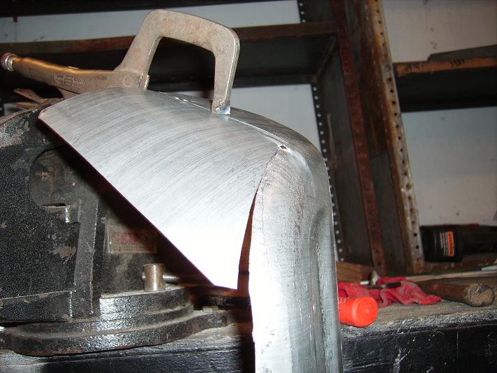

    This was done all by hand. No bead roller, no brake, no shrinker/stretcher.
    I used a hunk of old plywood with the outside perimeter of the stamping cut out and radiused. I used a 4" wide masons chisel with the sharp edge rounded off slightly to knock the line in the recess and stretch the metal into a depression. the curved corner was done with a set of punched welded together to twist the metal and make puckers. The long curve was done by stacking corregated cardboard, thunping down in a long trough with a pipe and BFH then using a home made hammer to slowly bump the curve into the panel. I also used my 4" chisel to form the long sharp line as it was not straight and could not have been done in a brake anyway. Same method. Lay the panel on corregated cardboard and bump in the crease.

    Nice work

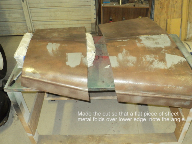

    I hate to sound stupid, but, what's a wooden buck?
    I would like to form the bead in an oversized piece of sheet metal, line the bead up, then trim the patch panel to fit. Photo will give you an idea of what I am trying to do.

    C'mon man, you know. A wooden buck!

    just find some thin wall tubing same size ,slice it down the middle you now have 2 1/2 round pcs

    32v, you suggest thin wall tubing. You aren't suggesting the electrical conduit type, are you? I didn't think that stuff could be welded.
