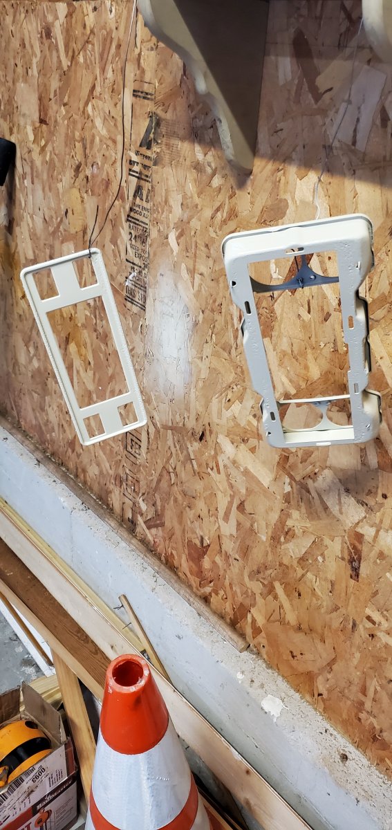

    Tuesday night, I had sandblasted the housing and the gauge face plate. Wednesday, they got painted with some almond Rustoleum appliance paint
    I also made some LM7806 6v regulators for the gauges
    Put everything back together
    Pre-wired what I could to get it ready to install.
    I ordered 10 LED 57 bulbs, as the incandescent bulbs in my gauges don't really provide much light, even though they are the brighter version. Here's the results when I swapped them in the gauge cluster of my '40 stake truck. Since the panel's gauges have more rust stain on them, the LEDs should help with the visibility in those too.
  7. Wow, those Leds make a big difference! Nice work
