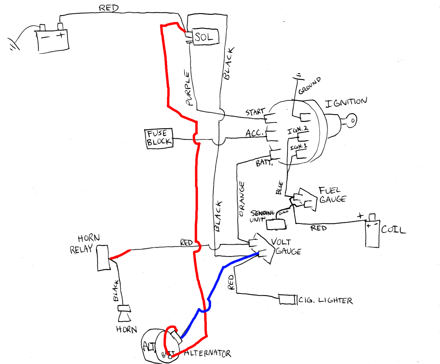

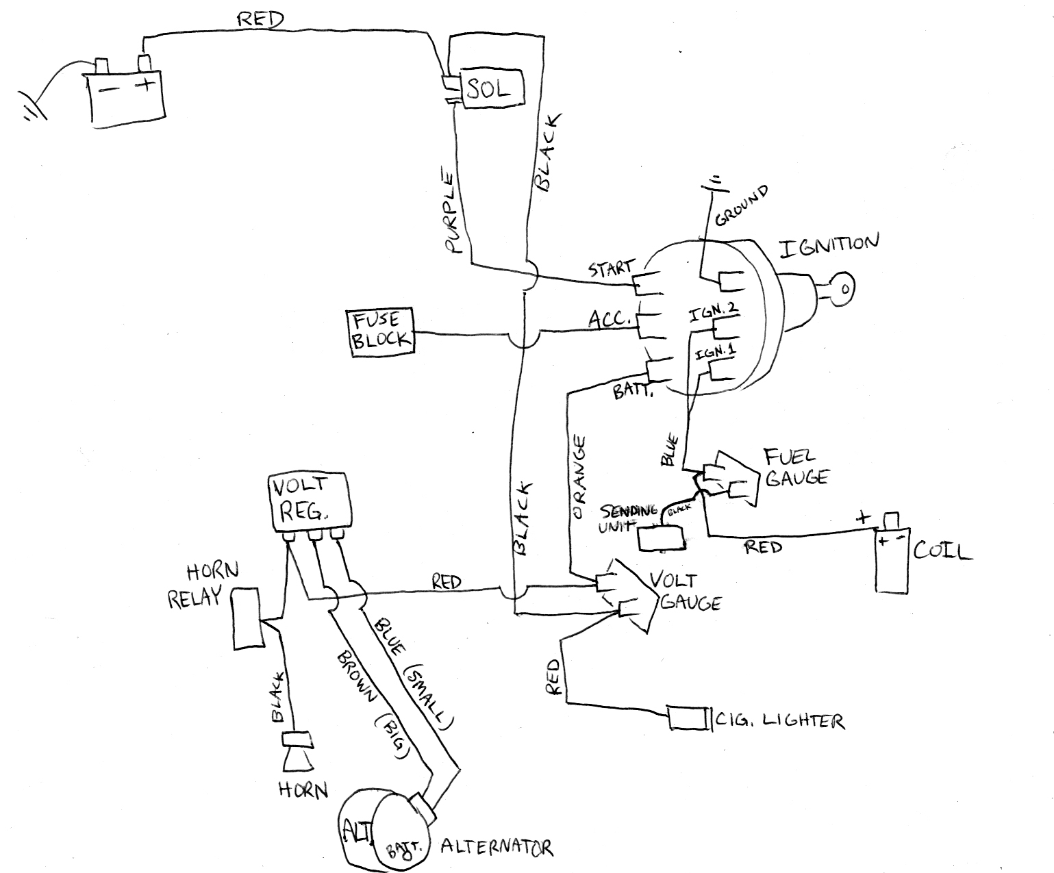

    Ok I hear what you all are saying. I truely suck at electrical and still have a few questions.
    I mapped out my current cars wiring below. Then I made changes in color to what I think Im hearing. Does this look accurate?
    Also... What does the smaller wire of the two from the alternator do? Is that the exciter wire or is that the big wire? Why wire it to the volt gauge? Sorry for my electrical ignorance.
    Also, after looking at my diagram... it seems kind of odd that my coil gets is juice after passing through my fuel gauge. Is it soppose to be like that? Does this mean that if my guage goes out, Ill have no power to my coil?
    And, will a 12 guage wire be large enough to go from the altenator to the solenoid?
    Thanks again for any help.

    Lewislynn, after posting those illustrations and re-reading your post I made changes to the path of the small (blue) wire from the altenator to the gauge. The post off of the volt gauge that had the red wire going to the regulator is where I have the blue wire connecting to now. Maybe this reflects what you were saying with: "The other wire off the alternator goes to your gage/idiot light. One of the 3 wires from your old regulator goes to the gage/idiot light."
    Let me know if this is correct or needs some adjustments please. Thanks!

  14. lewislynn
    Joined: Apr 29, 2006
    Posts: 2,289
    lewislynn
    When I converted my 56 F100 I simply connected the new wires from the alternator to the wires on the old regulator. I used the regulator as a junction block but I removed the guts...It works great. I don't know red wire from blue wire. I'll have to go out and refresh my memory later.
    Your new diagram looks like it would/should work.
    Does your system have a warning light, or a voltmeter, or a ampmeter?
    Use the #s on the alternator terminals per the link I posted.
    I would use a #10 wire to the solenoid if you can, I'm surprised it isn't already.

  15. d2_willys
    Joined: Sep 8, 2007
    Posts: 4,290
    d2_willys
    from Kansas
    The black wire from the volt gauge to the solenoid looks wrong, unless you are incorrect with the gauge, perhaps you meant ammeter? If you are using ammeter, u had better get a high amperage ammeter, as the alternator is anywhere from 60-110 amps output.

    Ok, so I went down and had the battery and the alt. checked out and both were fully operational. Im not concerned about those two now. Im certian it was due to my poor wiring that the battery just wasnt getting charged and I ran the car straight off the battery this whole time and ran it flat.
    So, I have since rewired some things.
    I have a heavy gauge wire going from my BATT post on the alt. to my positive post on the solenoid.
    I have ran the large red wire from the alt. pigtail to the BATT post on the alt.
    I have bypassed and removed the old voltage regulator from the firewall.
    The red wire that use to go to the regulator now goes directly to the horn relay box.
    So my unanswered questions are still these:
    1) Where do I connect the small white wire? To the back of the volt gauge? Which side of the gauge? To the side the red wire to the horn relay is connected to? Thats what I believe Im hearing, but I want to make sure.
    2) Does the wiring from my gas gauge to my coil positive look accurate? If my gas gauge fails, will I lose power to my coil? Is this proper wiring?
    Posting my diagrams again for referance
    First diagram is how my car was wired after 12 volt conversion.
    Second diagram shows what Ive done in RED.
    Second and third show the two options for the small white alt. wire connect location. (shown in blue here)
    Thank you all so far!

  21. d2_willys
    Joined: Sep 8, 2007
    Posts: 4,290
    d2_willys
    from Kansas
    R U running a volt guage or an ammeter? That wiring appears to be incorrect.
    If it s a volt gauge, the - terminal goes to ground.
    The cigarette lighter, black wire, and horn relay wire go to the battery terminal of the ignition switch. The accessory or ignition terminal of the ignition switch goes to the + terminal of the volt gauge. The white (blue on your diagram) goes from + terminal of volt gauge to the field terminal of the alternator through a diode or idiot light.
    I would check the HAMB technical section for more information on this wiring.

    Yea, theres a few updates.
    First off, I bypassed the voltage regulator and removed it completely.
    Second, I realized that my old ignition didnt have an accessory position. When I followed the directions in my "convert 6 to 12 volt" book, it said to hook the small wire from the alt to my accessory tab on the ignition.
    When I did that and tried to turn the car off, it energized the starter solenoid and ground the starter tooth. My ignition had an accessory tab in the back, but didnt have a seperate accessory position.
    I had to buy a newer ignition. I opted for a chrysler ignition because it had the 5 tabs I needed, had a true accessory position and came with some cool lookin keys :D
    Hooked it all up and started and ran fine, and turned off fine.
    I was 12.65 volts on the battery with everything off. I was 14.65 at the altenator while running, and 14.47 at battery. So its charging now just fine.
    The new problem I have is that my gas gauge doesnt work at all now. haha!
    One thing at a time!
    Thanks for all the helpful input from everyone!

  24. d2_willys
    Joined: Sep 8, 2007
    Posts: 4,290
    d2_willys
    from Kansas
    On the gas gauge, the sending unit goes to one side of the gauge, no other wire should be on this terminal. The other terminal is the blue wire to the ignition, and the red wire to the coil. Did you fix the black wire as I pointed out?
