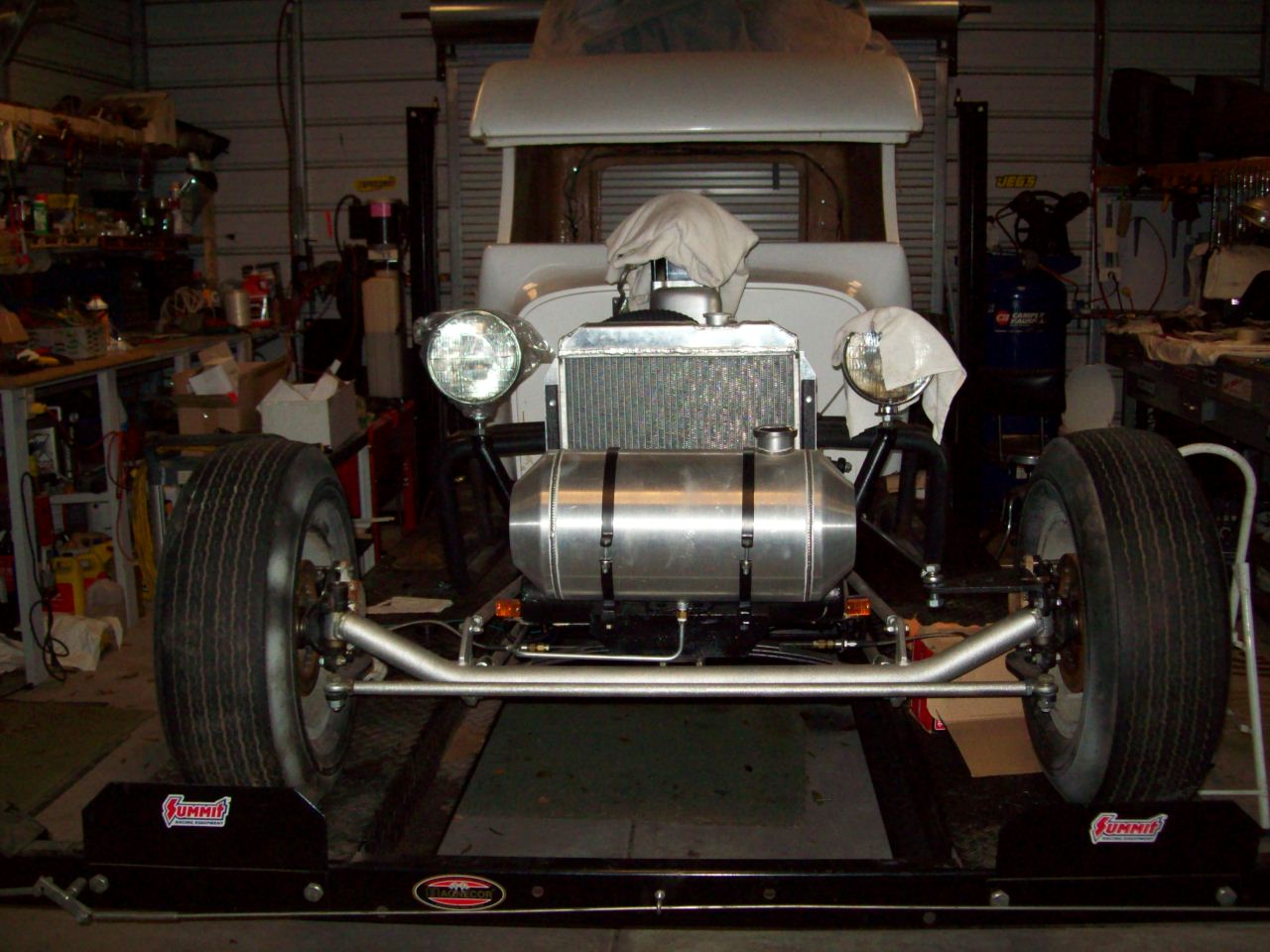

    Guess I'll be going with the 2/0 welding cable, thanks for all the help. Here's a pic. Couldn't figure out how to upload more than one.

    Got it, the second pic was too big, kept getting rejected.
