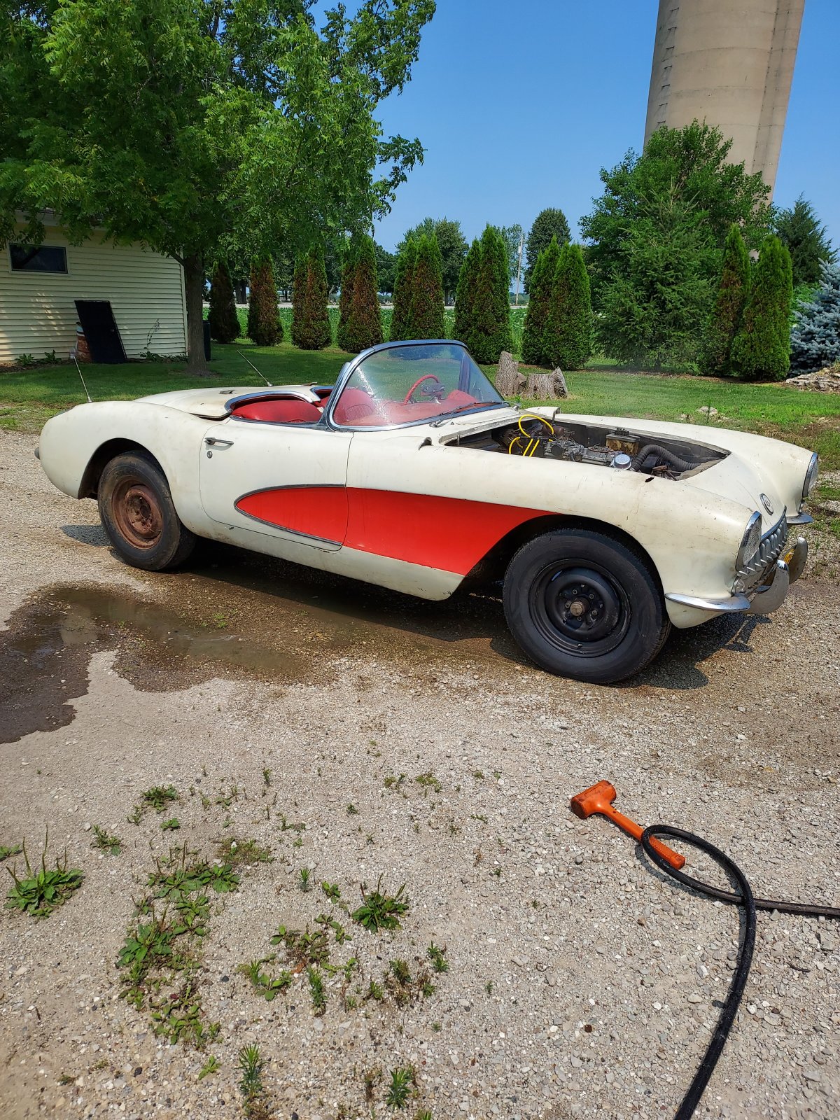

  6. Pics. The whole car is filthy. Starting to clean the top. 20210724_211104.jpg 20210724_211114.jpg 20210724_211737.jpg

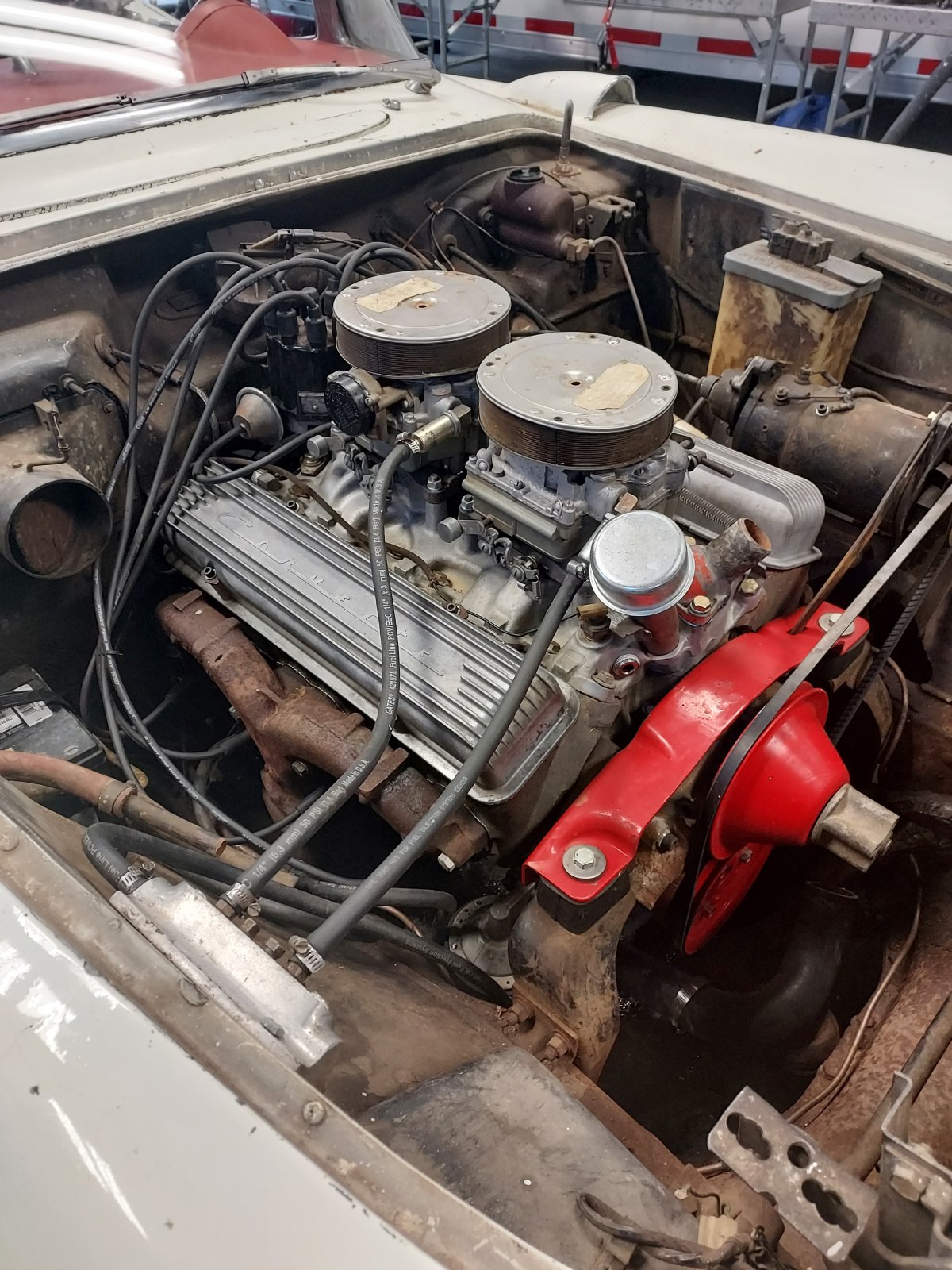

  7. 20210717_113810.jpg i have all of the trim and hub caps. The hood is off for now. The nasty yellow spark plug wires have been replaced with black ones. The radiator is out getting re cored. All of the fluids have been replaced. Too bad such a cool car sat so long.
    I did drive it last weekend. It overheated and almost went into the ditch when i hit the brakes. It pulled very hard to the right. I got the tires aired up and that stopped the pulling. The brakes were adjusted and that gave me a pedal and even braking. The radiator had a few mouse nests in it. Thats out being recored. Cant wait to drive it again.

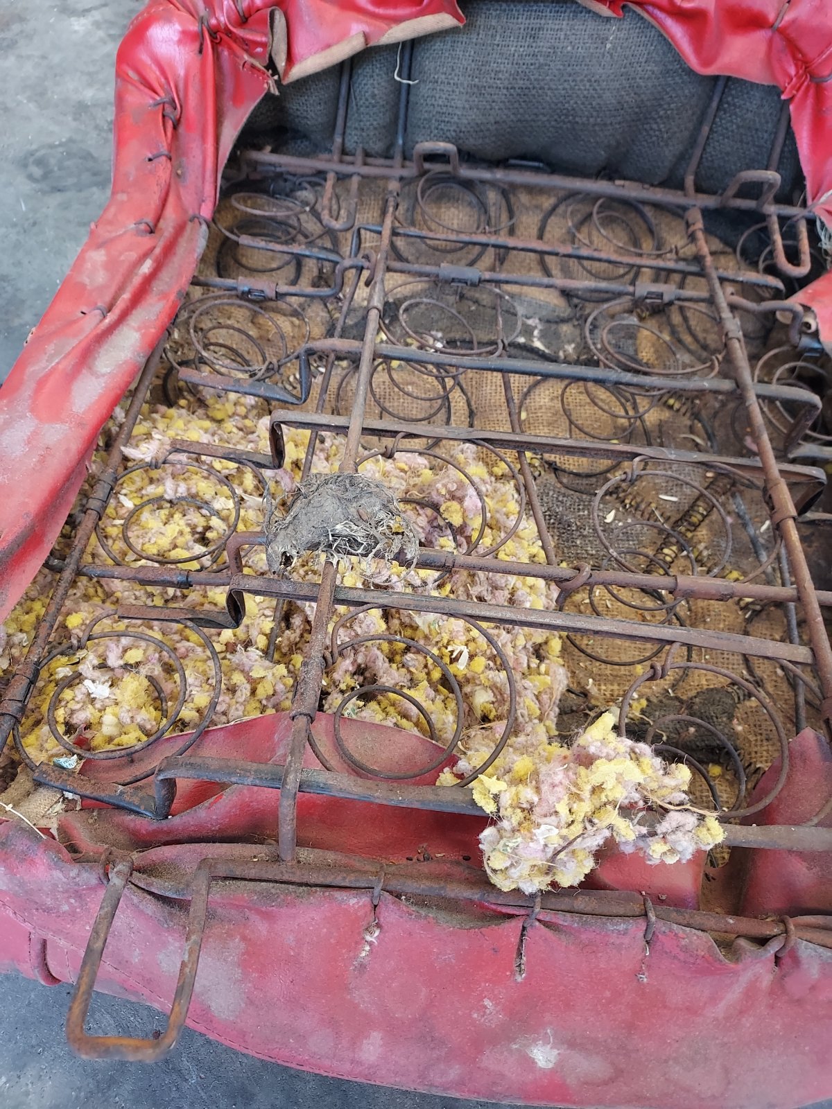

  25. Thanks greg ct. I can see how the seat attatches on the top. Its the bottom that i cant figure out at the moment. I looked at the passenger side. Its fastened in some how. I just cant see it. I was sweeping out the floor and found a clip with a hole in it. This might be what i need. No barn find car is complete without a mouse nest. This guy died peacefully at home. 20210725_141109.jpg 20210725_141113.jpg

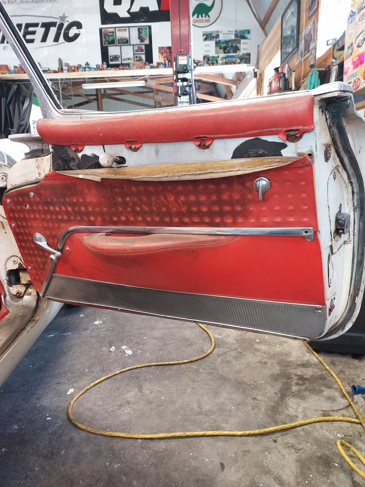

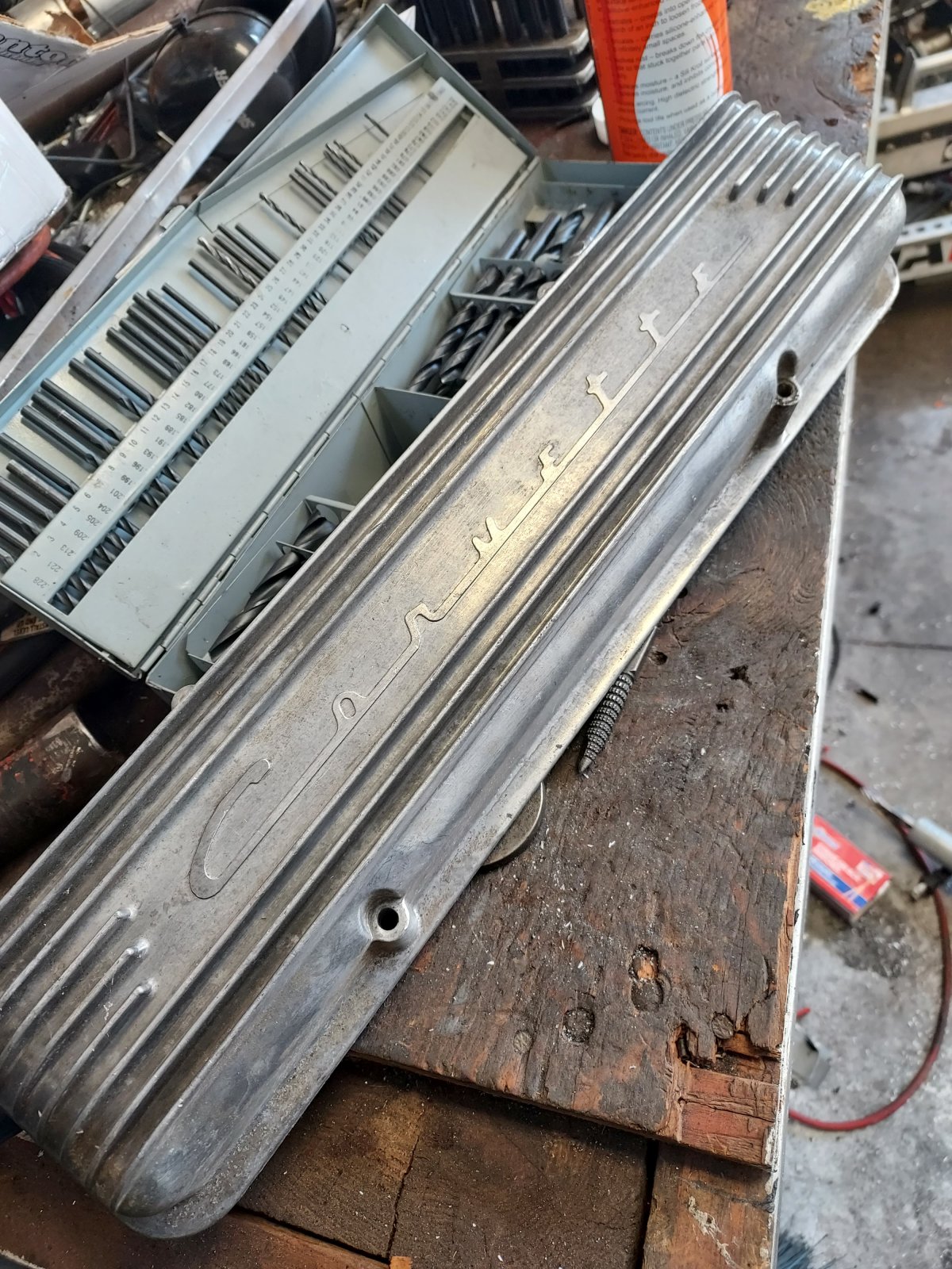

  26. I found the the other low script valve cover in the trunk. Before and after picscof the door panels. I have the missing trim piece. I scooped two full dust pans of dirt off the floor. The red shag carpet has been pulled. Its starting to get cleaned up. 20210725_143909.jpg 20210725_143900.jpg 20210725_143917.jpg 20210725_144159.jpg

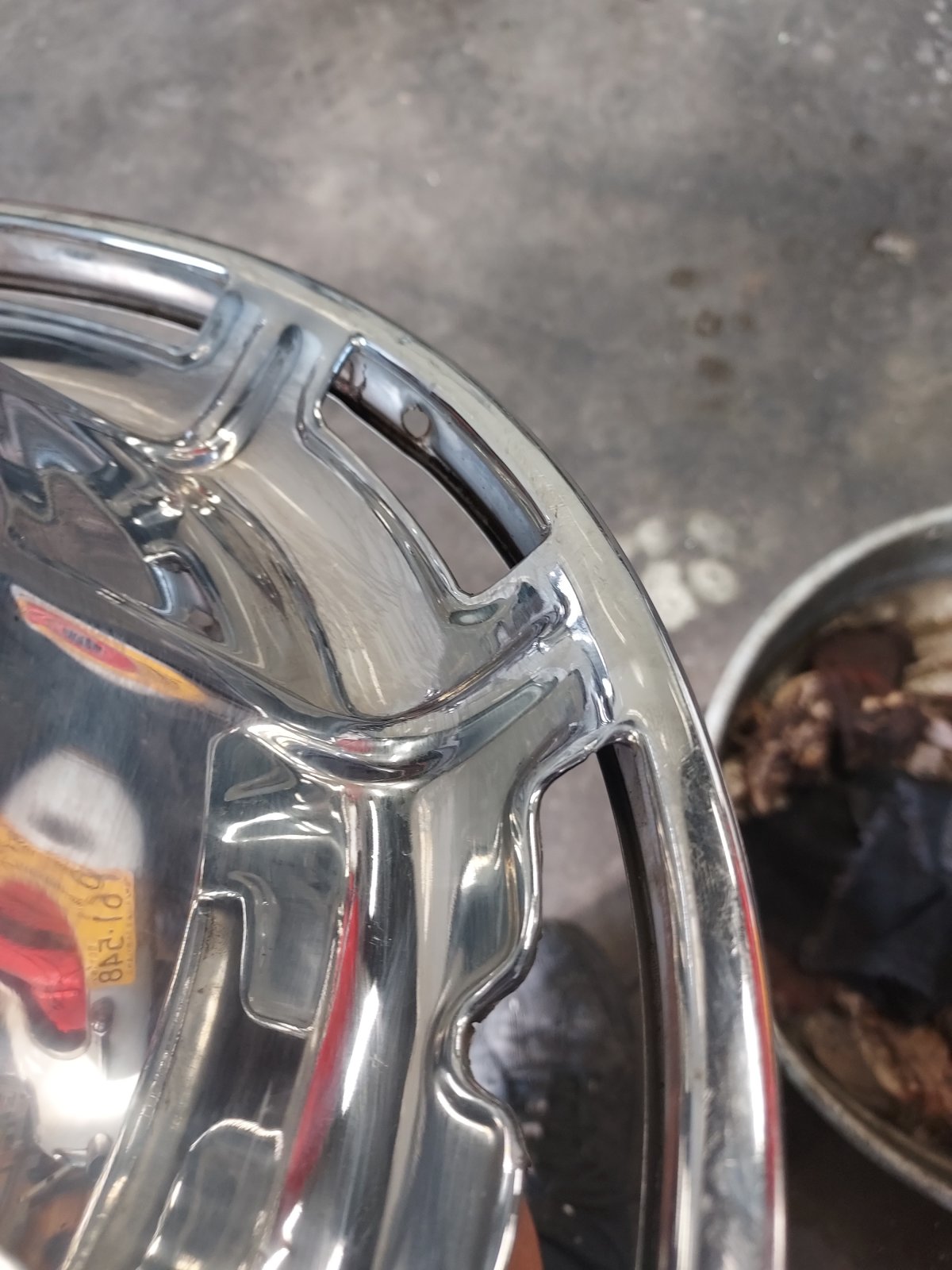

  27. I have six hub caps that might be original i dont know yet. They all have holes pressed into the on each side of the tire valve. What was the purpose for this? Now that the car is somewhat cleaned up its looking better.

    Those are '59 to '62 hubcaps. Yours should not have holes around the outside. I am working on a '57 and getting most of my parts from ZIP Products. Many times one or two day shipping. They all sell the same stuff it's all about customer service to me. I'd have to look to be positive but I THINK with non white walls it gets body color wheels. That's how my '63 was.
