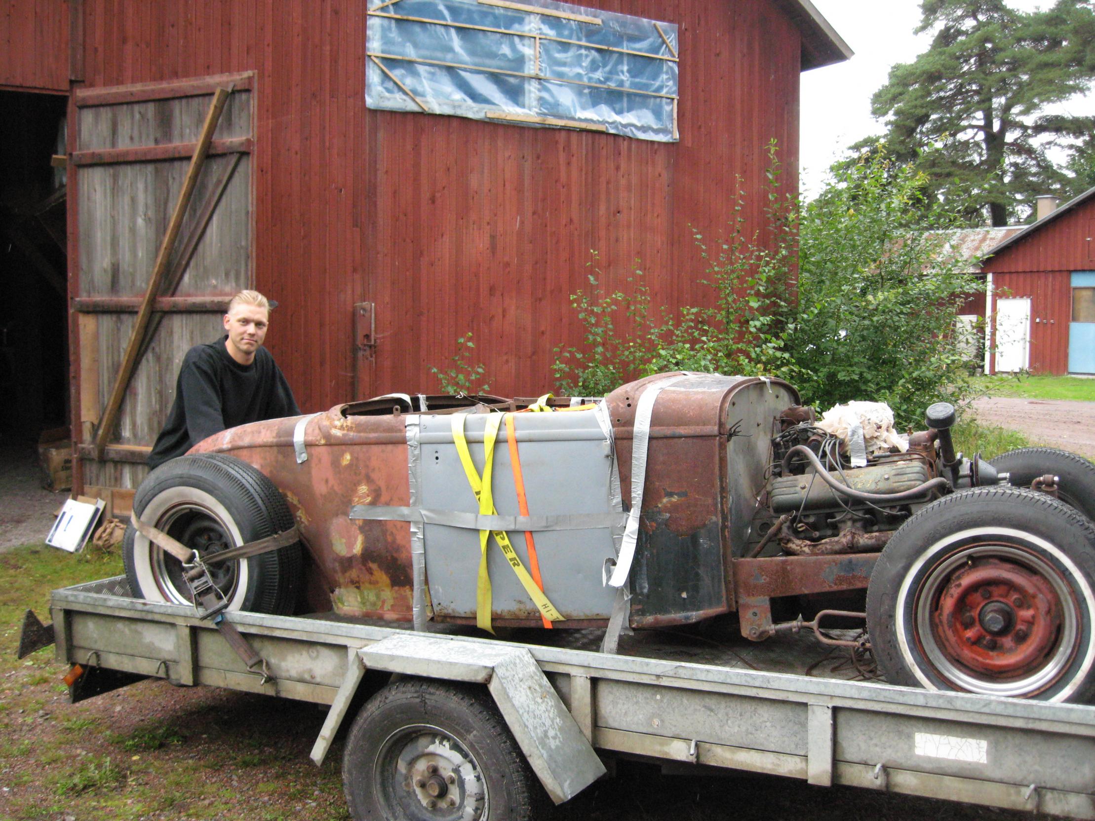

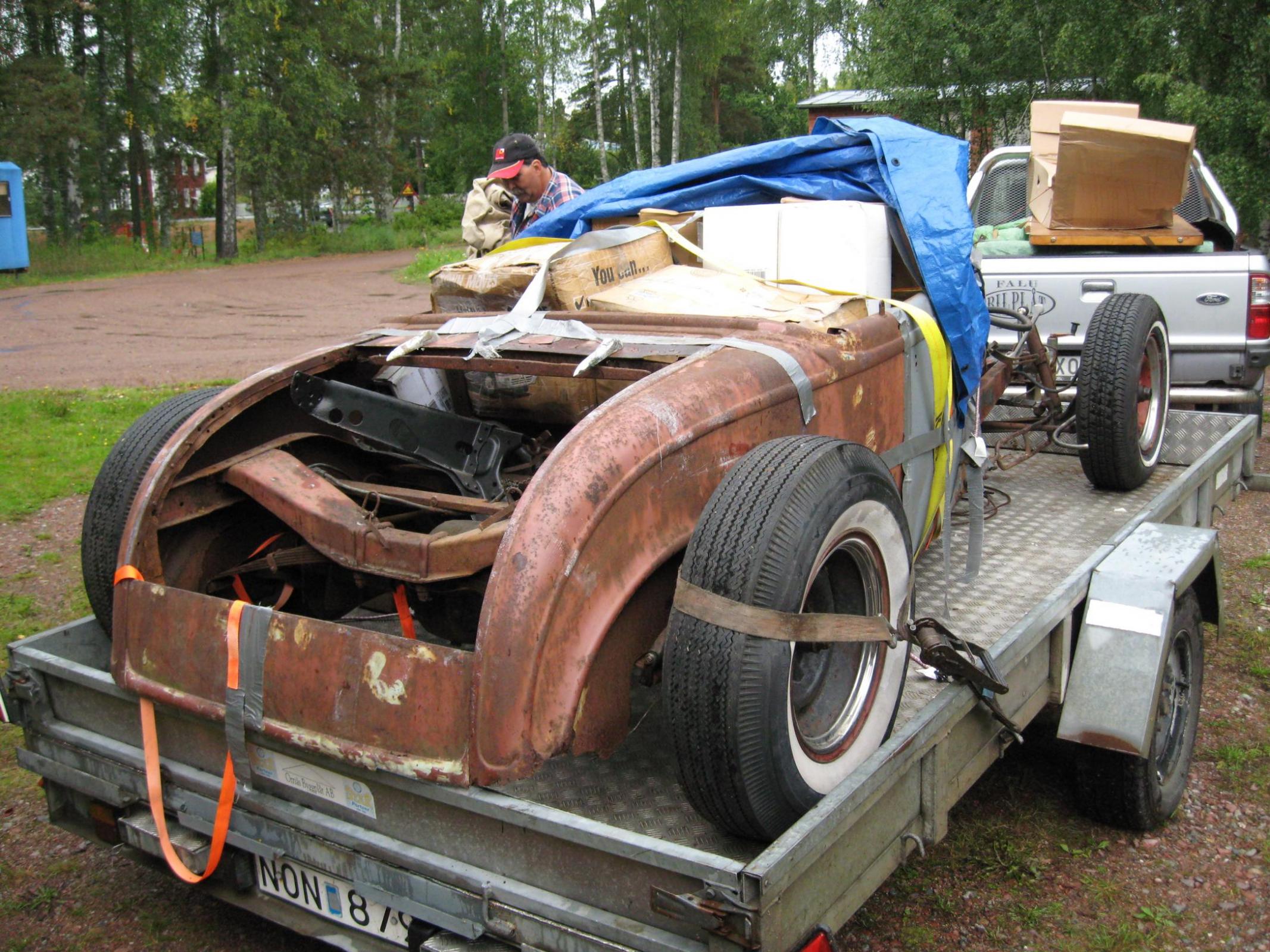

    I try to find some info abute this Roadster. I found it on Lond Island in -07. I did put a add. And a man reply on the add:D. He diddint know muche aboute the car. He said it shuld be build in late 50´s and ben store sens the 70´s ?? The look at the car seams to mach what he told me. The boddy is channeld aboute 6inc in front and 12inc in rear.
    It have a mordrop axel and 42-48 brakes, One of a kind hairpins! The front shock mouts is welded in the frame and chromed. F100 steering box, Banjo rearend whit open driveshaft and hydralic brakes. Even the rear have some special hairpins like a 3 link, You can adjust in the front and rear to get a nother angel on the axel cool! They frame have bean Z in the rear, they have take two 32 frame and put the other one on top on the other one. Lots of frames those days:) The boddy is orginal apart from the flat firewall and the out side hingel on the trunk and the clow vent. The org dash have a insert whit 4 SW and a Sun tach whit a transmitter. The motor is a Olds Rocket. I dont know if the correct motor is a Olds, Caddy, Y block or a early Chevy:confused:. But the radiator fitt the exits. The radiator is in place in front of the A member. The rims on the car is 49-51 Mercury and the rear is reverse. I NEED some one how my be can help me find some info on the car I want to resto it like it was build!! So I need all the info I can get, fotos any thing that can help me whit this piece of history. To bring a real HOT ROD Alive again!

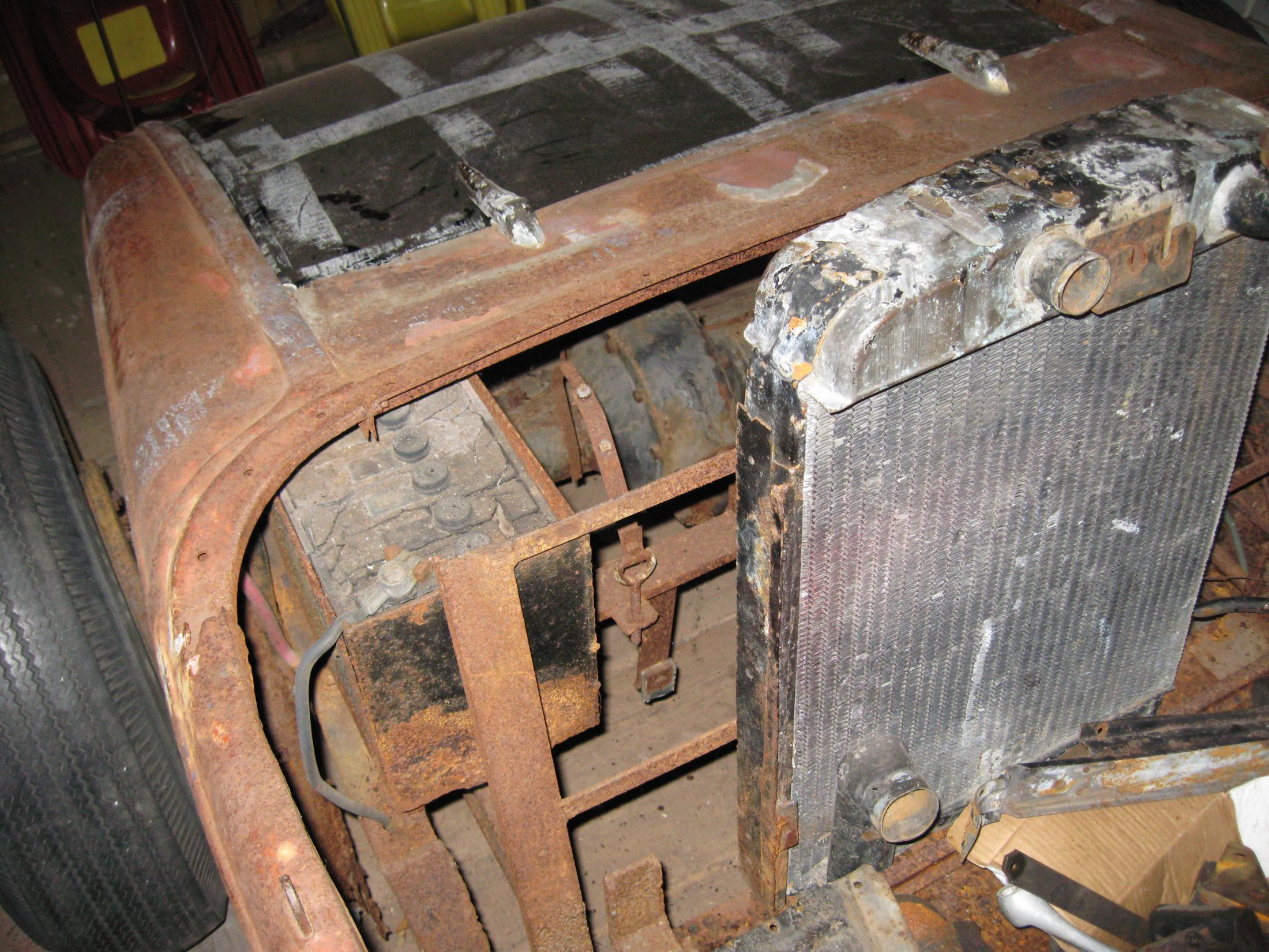

    More fotos !!

    Holy cow, I guess they didn't bother with the box plates on the ZEE joint up east.

    Those welds were sold by the foot in the JC Whitney catalog so that people without welders could just install them with Elmer's Glue!
  20. I think I see now what happened to the rear wheel to body fender line. To Z the frame it looks to have been cut and stacked then moved forward to have a good overlap for the weld joint. Maybe just un-do it and get the stock wheel base back.
    The Wizzard
  21. Geezzz, Check this out closely. It appears to have full stock rear frame horns and another 32 K member. You scored good my friend.

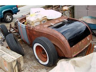

    Wow, I remember when that roadster was for sale...you bought it from Ron, right?
    That car is so cool!!!... I wanted to buy it so bad....poor timing, I'd just bought something else and I was broke...that's the way it always goes...
    I think about that car all the time...man I have the worst timing ever....
    It sounds like you really appreciate the car for what it is...a REAL
    OLD HOT ROD!...
    glad to see it went to someone who understands how cool of a car that is...
    hope you can find some history on it...
    if you get tired of that car, you're welcome to drop it off at my house!!!
