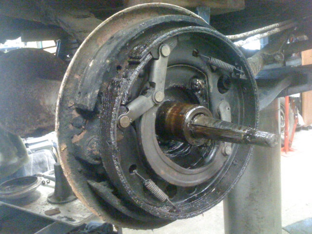

    Rear brake work:
    First you must remove the hub......Fortunately I have my Grandfather's
    HUB PULLER. I can't find a brand name on it, but he used it in the 1940's as a line Mechanic.......Thanks Grandpa !

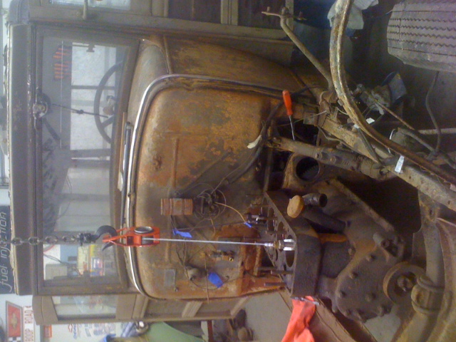

    Well Guys, after 63 years of sitting, the engine was just flat STUCK !
    Pistons # 1 & 4 popped out through the top fairly easy, with the top ring free, but the others stuck.
    Pistons 2 & 3 only had 1 " to go to the top, but they were stuck bad . Even with carefully scraping the cyl walls and lubricating for days, the force of driving them out from the bottom cracked the skirt. All the rings were stuck and covered with rust.
    So now, with the pistons out, I expected the crank to turn........NOT.
    The valves are apparently also stuck in the guides.
    More lubricating ahead.......
    circlek

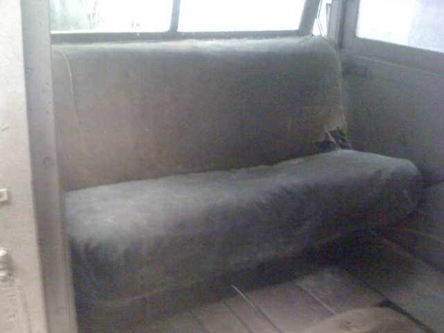

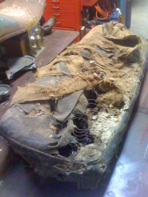

    Today was rear seat rehab day.
    Over the years, the seat had become a temporary home to some kind of a varmit, like a raccoon.
    The Woodie came with a front and a rear seat, but no jump seats inbetween as I have seen in restoration photo sets.
    But, it did come with the bottom of some seat lying loose in the floor which had an aged material similar to the original which was found after removing the outer covering.
    So it was time to strip the OEM rear seat of aged material and re-cover with the NEW / OLD materials.
    kidcampbell71 likes this.

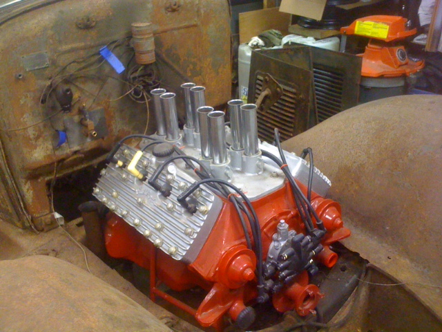

    California Dreamin' for a new engine
    One like this should make the Woodie really HAUL !
    Several years ago I found this engine at a swap meet and just had to have it, but my truck bed was full, so I just put it in the back seat...........because it's FIBERGLASS !
    Just funning guys ! ! !
    The Banger is at the machine shop getting the valve seating work done, then back home for assembly with it's new .060 over piston set.
    circlek
