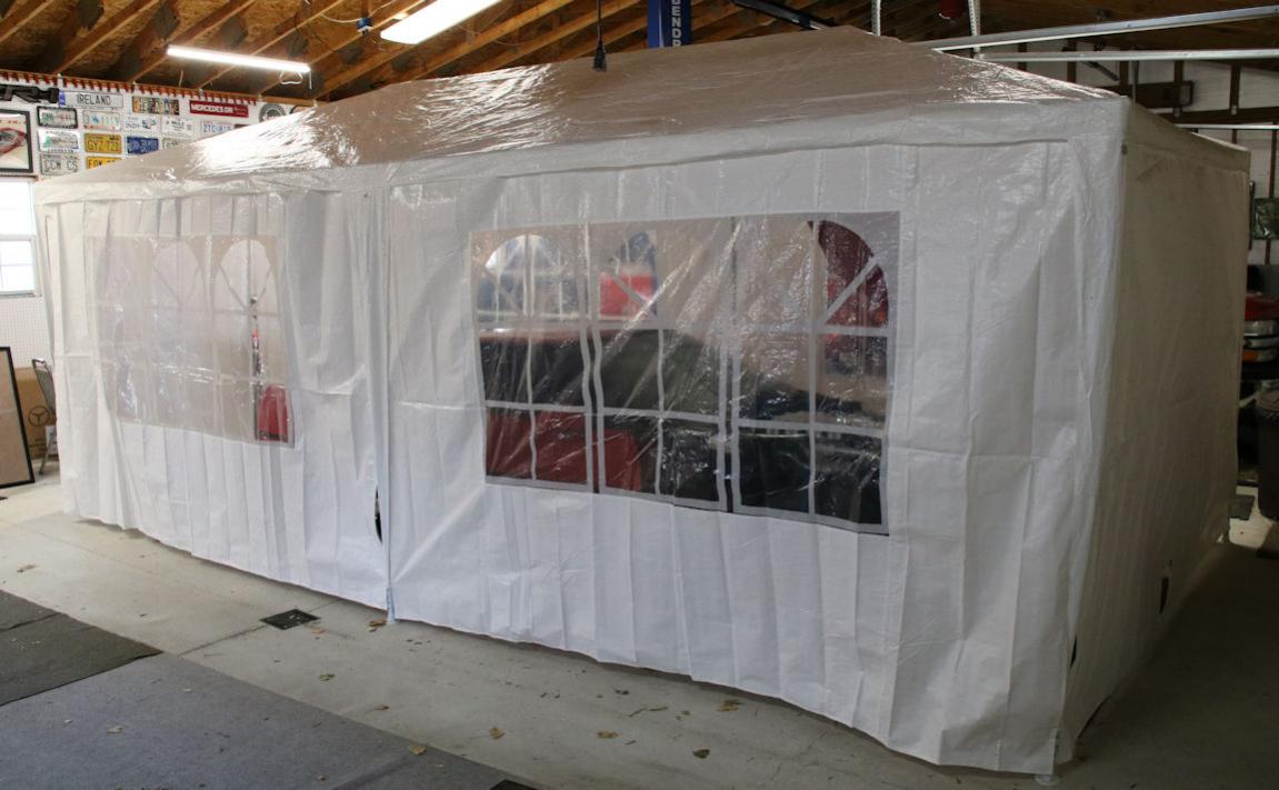

  16. Over on garage journal, there's a thread or two maybe three where guys set up in their big un heated barns a cheap but huge wedding tent from Amazon to work on stuff and better control the climate in the tent. Amazon Links to the tent there too
    oj likes this.
  17. Should be a month or two job, work a section seal it move on 4 fenders, 3 doors, hood, top, left side, right side, inside. 12 areas 2 days each.

    I was thinking along the same lines as 31Vicky. Build a frame out of 2X4's cover it with a tarp and clear plastic film (visquene type) draped down the sides. There should be some way to dehumidify the enclosure.

    That would make a good poor man's spray booth!
