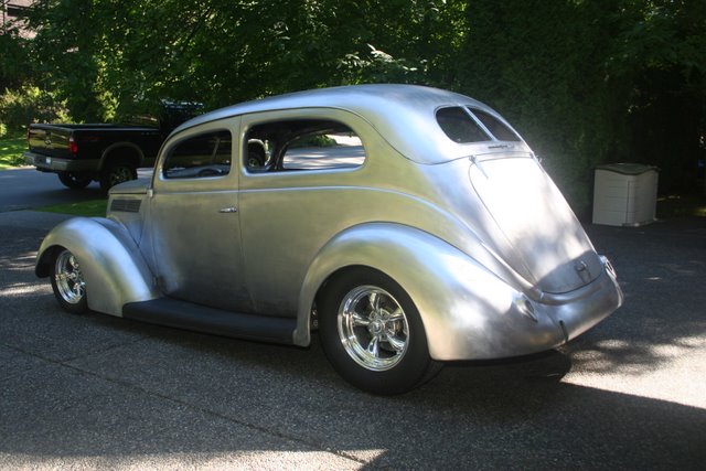

  27. bill3337
    Joined: Sep 30, 2007
    Posts: 231
    bill3337
    It's just nicely finished metal work, then I used a strip it disc to clean it all up and give it a uniform finish then hit it with a d/a sander and 120 grit, then gave it a bit of a hand sand in one direction to give it kind of a brushed look. Sounds pretty involved but really took about a day and a half's worth of work. Thanks for asking.
