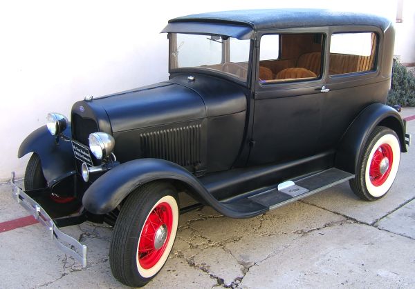

    Anyway, I'm in the deciding stages. Not 100% traditional but I bought a '28 Tudor in June it has a Pinto 2.0, C4 and an Isuzu disc brake rear. I want to drive it now as I'm working on other cars, but want to change the rear (it has '39 drum in front). I have a '46 open banjo of unknown condition and have access to a 9"....oh and I'm sticking with the '35 wire wheels it has on it. I need to think of the future when I build the rear (I have a 322 nailhead, flathead or ???). If I go with the 9" then the backing plates have to be modified, if I go with the '46 truck it might be too wide. I haven't posted pics as of yet so here's one, I've got some shiney stuff to replace the semi flat black parts like the grill, tail light, headlights and bumpers all original older chrome stuff.....and I'm going to paint the wheels another color.

  17. It's the 1/2 ton rear, you can see by the picture that the rear is wide now (tires are close to the fender) because it has wheel adapters on it. I haven't measured it with the wheels off yet as I'm working on the front part now (angled driveway means one side at a time).
