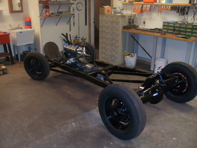

    Wow - first one I ever got to start
    Here's pics of my chassis - just have to finish the body now!!!

  13. Yeah, im so close, just need to sand the primer then paint. I do want to finish it, the darn chassis is DONE. I just cant push myself to touch it. :( Ill get back into the groove with it later...im sure :)

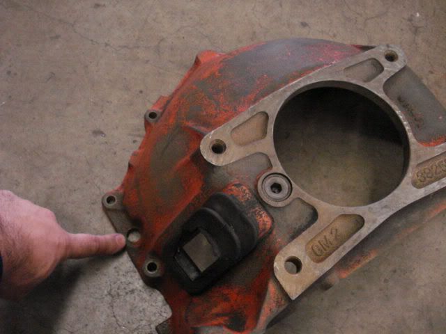

    My neighbor Brian who races IMCA modifieds gave us an old Chevy scattershield he had lying around.

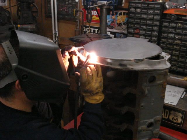

    Welding it on... we bolted it to a Chevy engine block so it wouldn't move. I skipped around to keep the heat even around the thing:

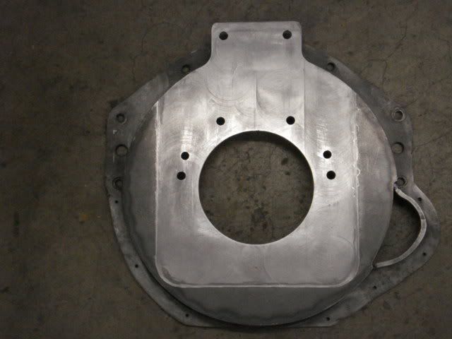

    All welded up and ready to go back to Ivan for some more machining
    We checked it out and it sagged about .016 in the middle...
    Tim got the blue prints for both the Chevy motor and the Banger motor and did a real nice 1/1 drawing to make sure we weren't missing anything before we had it machined.
    Basically we just needed to know the Chevy dowel pin holes in the "ring" so Ivan could zero out the mill. Then with the banger motor crank to dowel pin hole measurements Ivan could pop the holes in the "plate" for the Ford dowel pins... (you just work backwards from dowel pins to crank center line to crank center line to dowel pins. This will get us as close as the factory, then we will index it in when we get it on our race motor.
    Chevy dowel pin holes.
    Ford dowel pins. If these are mapped out correctly, the crank center lines are the same.
    Back from Ivan... he did the dowel pin holes because they are critical... and poked the hole in the center and milled the thing flat so we would be guaranteed that the two surfaces were perfectly parallel.

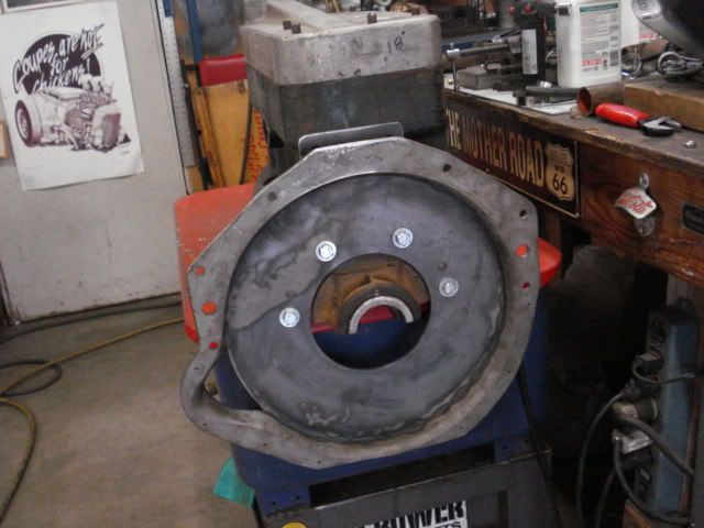

  19. Here it is bolted to the back of a banger motor
    And here is the dowel pin located on it.
    Here you can see the two upper mounting bosses.
    And with a Chevy bellhousing bolted up! We'll use an SFI scattershield in the car. This one is just for a visual.

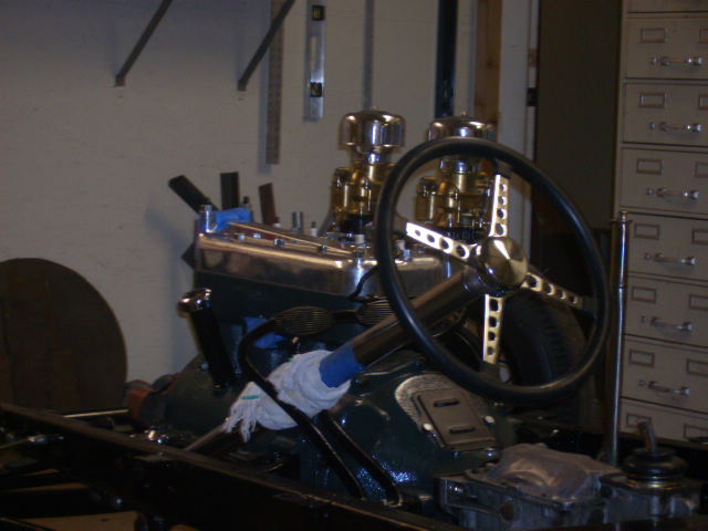

    Thanks for the pictures. My flywheel is at the fat farm as we speak loosing weight. I interested in seeing how much weight Wilbur gets off it (started at 60 lbs).
    Below is a picture of my engine today. I need to turn the body of the Willys distributor down ~.040 so it will slide in the head. If this distributor works out it will be one of the cheapest ways to get a mechanical advance dist for the A engine. My dist. is NOS but I have seen used ones sell on eBay for less than $20.
