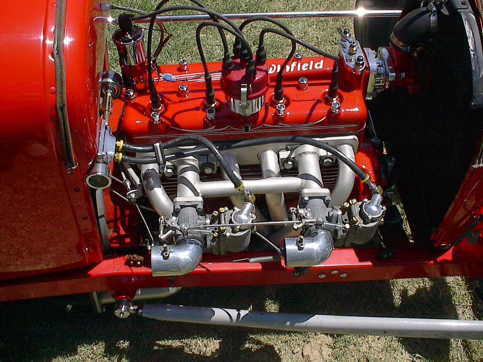

    I'm looking for some opinions on intake manifold design here.
    I am working on installing a pair of side draft carburetors. This will be on a dirt track 29 roadster.
    The intended use of the car is exhibition runs with a group of other cars, so its not terribly important.
    But I would like to end up with the best design possible.
    A have a manifold for the carburetors for an Offenhauser and it is a log type manifold with each carb centered over 2 ports.
    My engine is still just a 2 port model-A block.
    I can make a log manifold and have the option of possibly adding a 3rd carb if necessary. Or make a straight tube manifold with a balance tube (either straight tubing or flared made from sheet metal, flared towards the block)
    Any thoughts?? (drawings are in no way to scale obviously, just for refrence)

    I like the one on the right. Runner length will dictate power range and torque peak.

    Thanks guys... I think the log manifold is more of a benefit with more then direct side draft carbs....started working on it last night... trying to figure out length's etc.
  12. You may be just Banging your head against the wall.
    CDO does make a good point about length vs rpm tune. This is true in every motor design. How much RPM do you think you will be turning this motor? And, for how long? If street driven you will probably be better off thinking lower revs.
    What most forget is that with this motor, being siamesed port design and the firing order, the tuned length doesn't happen to matter as much. That being said, I would make it as long as it can possibly be to fit everything carbs, air cleaners or whatever in your car.
    The balance tube between the two doesn't have to be too big in diameter, depending on the carb, you may not need one.

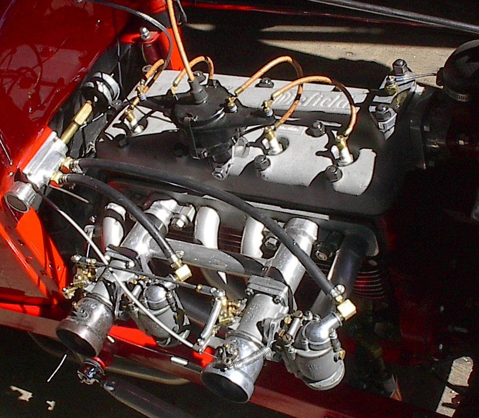

  13. pieces.jpg View attachment 2685010 View attachment 2685010 This is a photo of finished components. The end of the balance tube is has a radius of 1 5/8" the same as the ID of intake tubes . The ends of the balance tube were polished with a slight radius. I turned 2 short pieces just under the ID of the intake tubes to hold fit of balance tube. You can see the short piece in place in tube on the left. One was too close had to bore it out. The bar in the rear held the spacing of mounting flanges. Intake tubes were taper bored from 1 3/4" to 1 5/8" at the block as that is current port size in block. I carefully ran a hone in intake tubes at balance tube joint. Carburetor flanges were welded on after these components were welded. Tried to locate carburetor flanges at 2 3/4 degrees same as a winfield single manifold. This was all scrap material !
  14. This is a photo of my first attempt at side drafts. The intake tubes had a 1 1/2 " ID as I was planning on using a pair of S B's which I did. The length was determined by clearance needed to clear headers . Balance tube size was determined by what scrap Al tube I had. The engine was bored to 4" with a drilled counterbalance crank.REM AL rods J & E pistons Jim Brierley Winfield SU1R cam ran a Winfield repop head 7.5 to 1 car ran 76 in 1/4.
    Balance tubes were, as I have read, developed for circle track racers. The use of supposedly smoothed the power surges as the cars accelerated and de-accelerated as they ran the course. On a straight high speed run there probably wouldn't much use for them. The article was about the Roof designed Laurel Racing heads
    I once made balance tube fittings for Yoshimura for the large displacement 4's and they were approx. 3/8" ID or slightly larger so it doesn't take much

    The dual intake I am making now will be for a pair of 1-3/4 throttle bore Riley small bowl side draft carbs. The venturi on them is 1.05.
    I am planning to make an intake for a single Winfield C side draft and finally one for the same size Winfield as an updraft.
    This car is 100% strictly for dirt track use. We run at a controlled speed... but in a model-A its pushing it pretty hard.
    I was running a dowbdraft Zenith 228 from a GMC 270 on a modified model-B intake. I bought the whole set-up at Hershey last year and just bolted it on.
    My biggest problem was the height compared to my gravity feed from the tank.
    I just about have a pressure pump hooked up to resolve that issue. But still want to try the various other intake layouts and see what is best for what we do.
    This is all just for fun... but I do have some records of the times guys ran in similar cars in my area in the 40's. So I am trying to compete with that.
    The car is a recreation of a car that my family had in 1948... but a bit more "racecar" then theirs was from what I understand.
