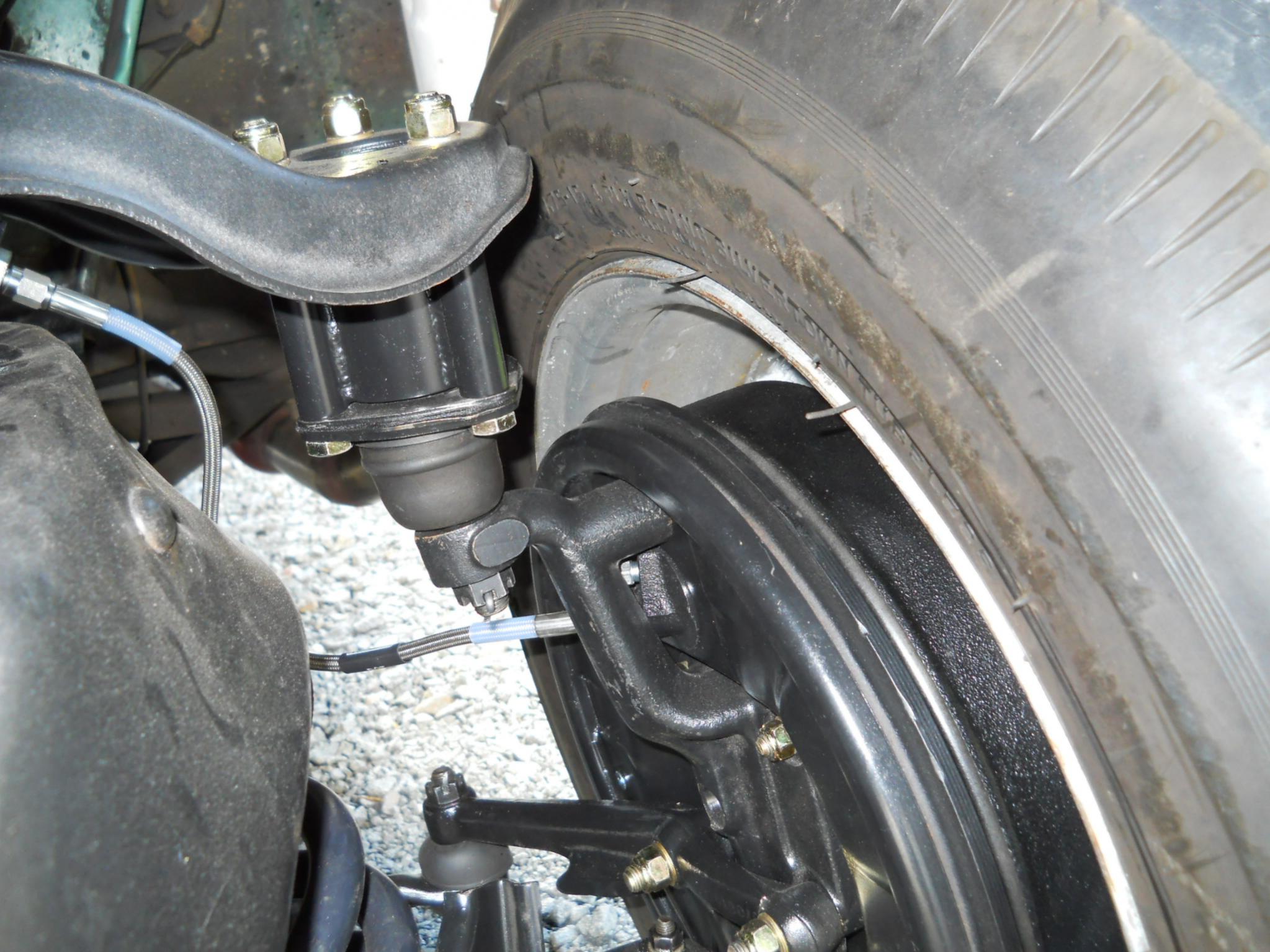

  13. USA Tires Sign Joe
    Joined: Aug 13, 2006
    Posts: 1,072
    USA Tires Sign Joe
    from Western NJ
    Here we used a custom made 4" ball joint extension that Tim's Hot Rod Shop in Pottstown, PA made. The car sits 6" over stock height with Chevy 409 station wagon w/ AC springs up front with one coil cut off. I did use a quality 1" wheel spacer to move the 15" x 6" mag wheel toward the outside. The only time the tire rubs is when the front end is jacked up for servicing.
