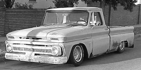

    Not to step on Knuckles', um.. Toes, but I did the bags on that thing way before she made the long journey up north.
    On that truck I used the stock rear trailing arms and put two 2500lbs Firestone dobble convoluted bag in the stock spring location. For a "C" notch I used 5" steele pipe cut & layed into the frame and then boxed. The only major thing I did in the back was relocate the rear panhard to a high mounting position to inside the frame on the driverside & installed an adjustable panhard.
    On the Front I used the same bags and simply plated the upper spring pearch & the lower "A" arm so the bag had a nice smooth surface to rest. To get it a little lower I uses 2" drop spindles for a '71 Chevy Half ton (For Disc Brakes)
    I have some pictures I put up later... Good Luck.

    You'll need a healthy notch out back, around 10-14" and have to move the bedfloor up or cut out the floor for the notch and diff to clear.
    The stock trailing arms can be used, migh have to move the bags forward towards the cab to get a decent amount of lift... a watts link works best to keep the rear centred, or go 4 link.
    In the front...dropped spindles on a 1.5" sectioned 73-87 crossmember and smallish cups will get you low, but you'll have to skid plate the control arms to keep em for more than a month and cut the inner fenders to clear the tires.
    If you just wanna be low but not laying rocker...i'm going with the pipe notch, bags in stock location out back with an adjustable panhard...stock crossmember up front woth 2.5" dropped spindles and 2 or 3" cups i can't remember. Thatll get you about 3-4" at the rocker.
    This is the setup i'm gonna run, this truck has the sectioned x-member but the front end is resting on the tires in the pic so the extra drop isn't really there at all. This is the stance i will have.
