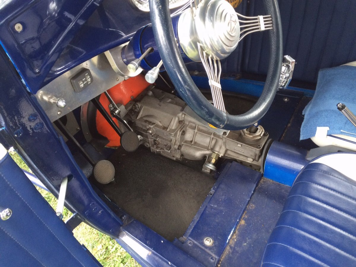

    With some planning, and using a perimeter (32) frame, you can drop the floor to the bottom of the frame. You can then put the bucket seats between the 32 rails and the driveshaft tunnel. You just have to figure out the position of the center crossmembers, rear suspension (wishbones), master cylinder (swing pedals), and the seating all at the same time. Doing that will help seeing out of the windshield, and make it way more comfortable to drive.
    Here is a pic of a friends A, with a dropped floor.
