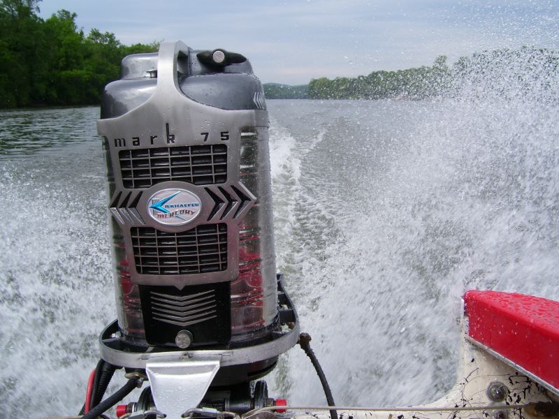

    I had a Merc Mark 75 "Dockbuster", an inline 6 2 cycle, that had no reverse gear (or nuetral). To reverse the engine, you shut it down, pull the shift lever back, hit the key, and if goes well and you held your face just right, it'd fire up and run backwards. Evidently, commonly thru docks, hence the nickname...

    Same as one of these. Mercury Direct Reversing, Direct Drive, 6 cylinder outboard. I've restored a few.
