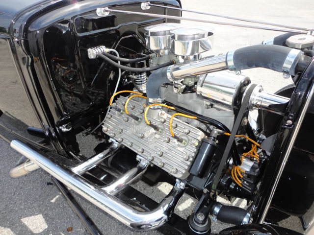

    Were there any other manifolds that reversed the carbs? Was there parts support for the Hexagon to ease linkage and fuel line needs or just seat-of-the-pants DIY? Other than generator placement what's the other advantage of reversed carbs on the street?

    When running a WCFB 4 barrel carb on a flathead, it was common to install it backwards. The linkage and fuel line worked out much easier that way.
    Mine has been running that way for 10 years. As said earlier neither the engine nor carb care.

    Had my Hexagon Tool intake on my Roadster for 15+ years. The only issue I have is that the motor tends to starve when I come to a quick stop.
    I’m so used to seeing the carbs backward that I think everybody else’s are backward...

    40grit, that's easy to assess especially given the throttle geography in early Fords.
    Swiss, that would have been my guess. Unless float levels remained at peak some momentary fuel starvation upon such dynamics. I can't see it being insanely critical unless a fast stop had to followed by equally fast accelleration but that might be just a rare perfect storm.
    I like odd and unique things, surely a Hexagon qualifies and having never owned a flathead Ford I had no idea about this. Being from Motown and spending my life in close proximity to Dearborn I might have to direct my gaze to one of these in the future. This is all good stuff.

    Wouldn't turning the carbs around on an adapter run the lead carb's float bowl into the back of the generator, necessitating an offset generator bracket? Unless the adapters were tall and had a big slant built into them.
    This is all news to me. I have a Sharp 2 carb intake for my car that leaves the gen in the same spot but the lead carb is pretty much dead center of the intake and the second one in the rear, I could see how reversing them to put the carbs further forward the length of the float bowl would make for much more even distribution, especially with non-progressive linkage. Neat idea for any application.

    dickshotrodcarbs.com easily solved my problem. I sent Dick pics, he identified the intake and situation right away. From the pics he quickly put together a linkage set for me. Its now on the car and works great. Thanks to everyone for their input on this issue. I learned a lot and further search Miller and his Indy cars, the ill fated front wheel drive Ford V8 and much more. This Hexagon Tool intake has now become a prized component of my A-V8. I am now on the search for the air breather to properly show it off.
