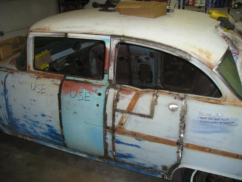

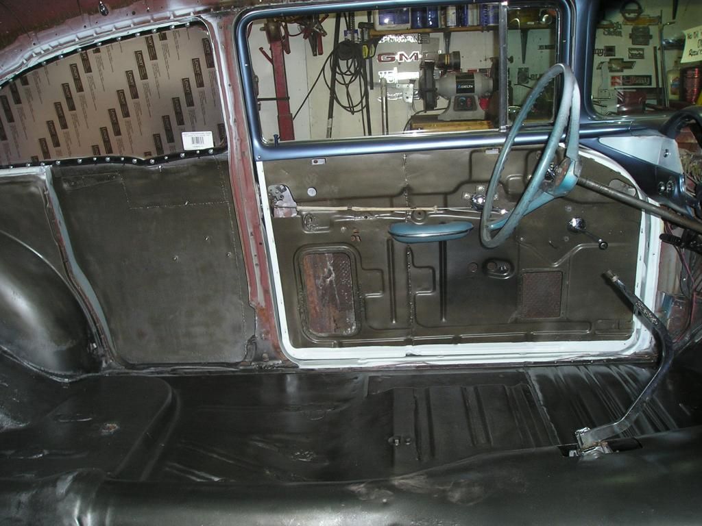

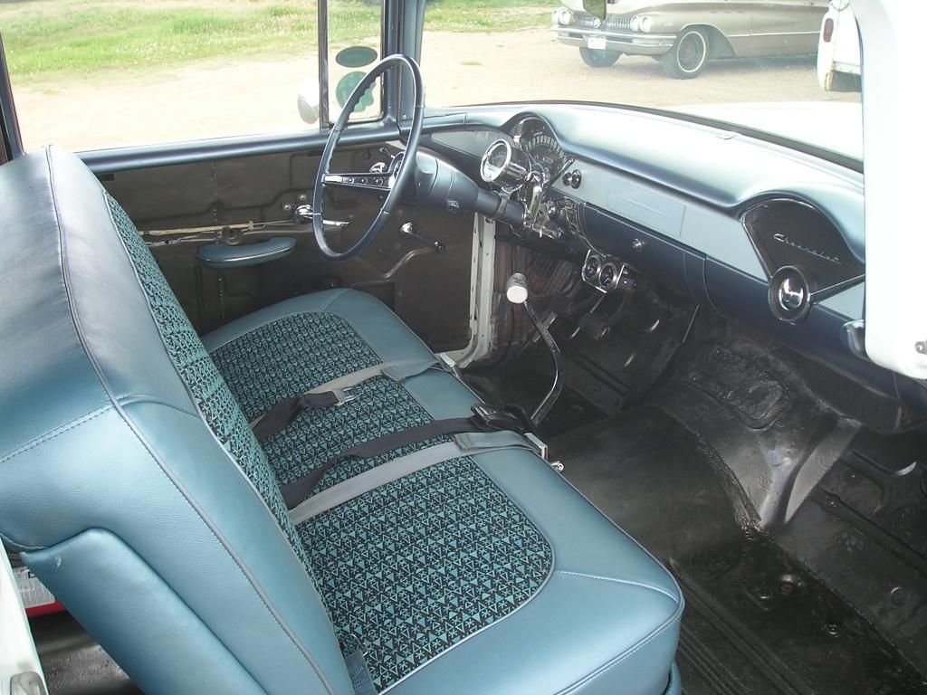

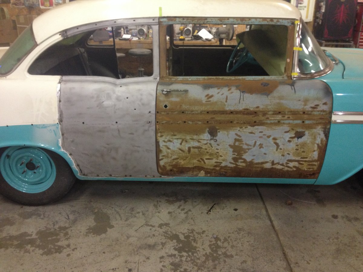

    Here's my '55. I got the idea of splicing doors from CSU55CHEVY a few years ago, I think he did it on a '57 more door he had. It's tedious, but $7-800 cheaper than a pair of nice 2-door doors. The doors on my car close with a click after HOURS and HOURS of cutting/re-welding. It was worth it tho, they seal pretty good to the body also.

    ^^ Damn Kevin, that looks nice!
    I know the 2 door sedan doors are expensive to find in good shape, I grafted the bottoms of 2 pairs of 4 door sedan doors into the shitty 2 door sedan doors that we used on my dad's '56 Chevy conversion. Turned out good but was a ton of work. It might have been easier to do what you did, and just cut the inner sheet metal out of the 2 door sedan doors where the regulators mount to weld into the spliced ones. $1200 for a pair of reproduction shells would have killed the budget.

    Wow, I bet! Goes to show how many ways there are to do this. Checked out your '56 looks good dude. Thanks for the words on mine:cool:
    Hell no!:D Thanks for the kind words. Much appreciated:)

    I love your finished project. Seeing pictures of your project is giving me a wild hair to do this, as if I don't have enough projects allready. I have a 55 210 four door sedan shell and a really rough 56 Belair 2 door sedan body and frame. These were both bought to be parts cars, but I am thinking now that those two cars together and the leftover parts from my old man's 55 H/T build I could build a down and dirty mean 55 150 two sedan street machine. :cool:

    Go to it Malibu! It's a helluva lot of work but it's either time or money take your pick. Cost me about 10k to build mine including the 2k I paid for it as a complete, running, driving, almost rust free 4-door. Just couldn't justify 4-5k for a 2-door body that still needed EVERYTHING. Thanks for the words man.

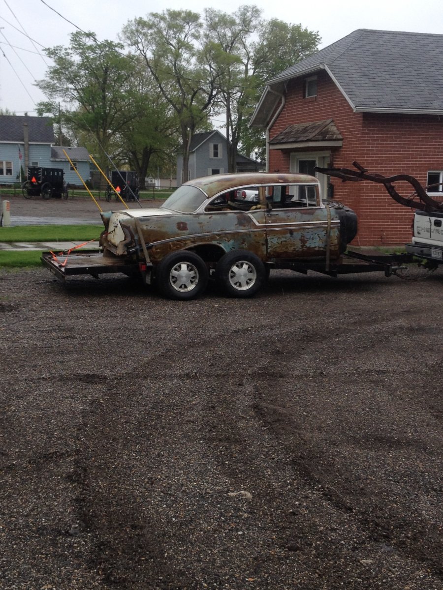

    Hi everyone, I've been on this forum a while but I've never posted before.
    Sorry if I'm beating a dead horse here with my question but I'm currently looking at a '57 4-door hardtop.
    My question is if not having a post will stop me from making it into a 2-door? I assume there has to be some sort of half-post between the front and back doors that I could move??
    Thanks

    I think you'd be the first to do this to a 4 door hardtop, it's something I've always wanted to see done but haven't yet. The 4 door hardtop roof is quite a bit different than the 2 door hardtop roof, so your finished product is going to look a lot different than stock. Not necessarily a bad thing, just different.
    The steps are going to be mostly the same (I've done several of these conversions) You'll need a pair of doors from a 2 door hardtop, you'll have to move the center pillar back although having a chunk of a 2 door hardtop quarter with the door post on it would make your life a ton easier. A same year Pontiac section would work just as well.
    The pillar in the 4 door hardtop is very integrated into the floor and is important to the strength of the body, so don't cut corners moving and welding it back in, reinforcements will be necessary where the post moved, and any rust repair the car may need should be done first to avoid the body losing it's shape.
    The hard part will be the rear quarter windows, 2 door hardtop quarter windows aren't going to fit, but you should be able to rework the rear door window frames into quarter windows to fit the 4 door hardtop roofline. Making them roll up and down might be difficult, would be a good start to cut the inner skin out of the 4 door sedan back doors and weld them into the new 2 door hardtop inner areas, to see if the regulators could be reused. Unfortunately, fixed glass isn't a very good option on a hardtop, so some engineering of the quarter window regulators would be needed.
    But once it's done, it would be a one-of-a-kind custom, with 2 door proportions but the 4 door hardtop roof, which is quite pretty in it's own right. The 2 door hardtop side moldings should fit fine so that wouldn't be too tough.
    Probably not a job for a beginner but it's absolutely do-able and I'd love to see it.

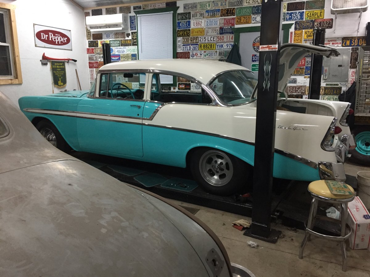

    Here's a rough photoshop of what a 2 door converted 4 door hardtop would look like. As you can see, it's different than a standard 2 door hardtop, but not in a bad way.
    Doing something different and unique with a '57 Chevy without being ugly is a tough job, but this car would do it.
    That said, having done several 4 door to 2 door conversions on a few different body styles, I would say the difficulty of this one vs. a post sedan is probably double, figure on twice as many hours and some engineering of the windows.

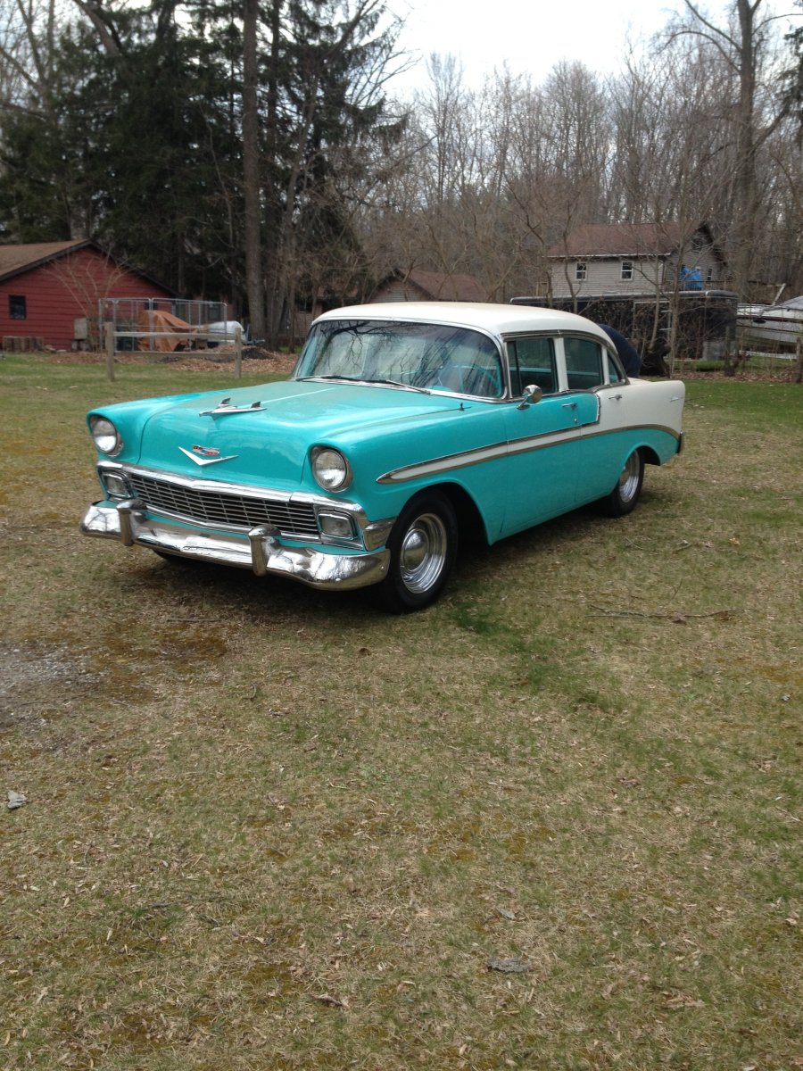

    However, I'm not sure if I'm allowed to post this here. (please tell me if it's not acceptable and I will delete it). I was also wondering if there was any difference in body dimensions between a tri-5 Chevy and a Pontiac? Besides the slightly longer wheelbase (front wheels moved farther forward) I have found a couple nice 55-56 Pontiac's around for much cheaper than any 210 or Bel Air. And I was hoping to put a fibreglass tilt front on it, Two-Lane Blacktop style.
    Any help at all would be great.

    The Pontiac shares the doors and firewall dimensions with the Chevy, so the Chevy fiberglass front clip would fit onto the Pontiac body, but the wheelbase would be too long, so you'd have to shorten the frame up some. Then you'd have to decide if you want to keep the Pontiac dash and tail lights/rear quarters or graft on some Chevy pieces there.
    It could be made to work, but I don't think it'd be super easy. If you're planning on a different front suspension and the project doesn't come with an engine or trans, it wouldn't be that big of a deal. But if you're starting with a running, driving car, you'll be undoing a lot of that to get the fiberglass Chevy nose onto it.
