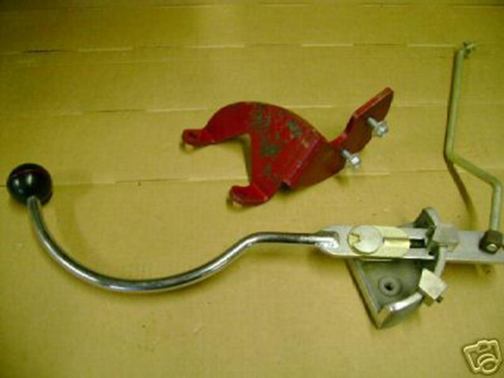

    Old Ansen shifter modified, no lockout but neutral safety switch even though on a clutch turbo car.

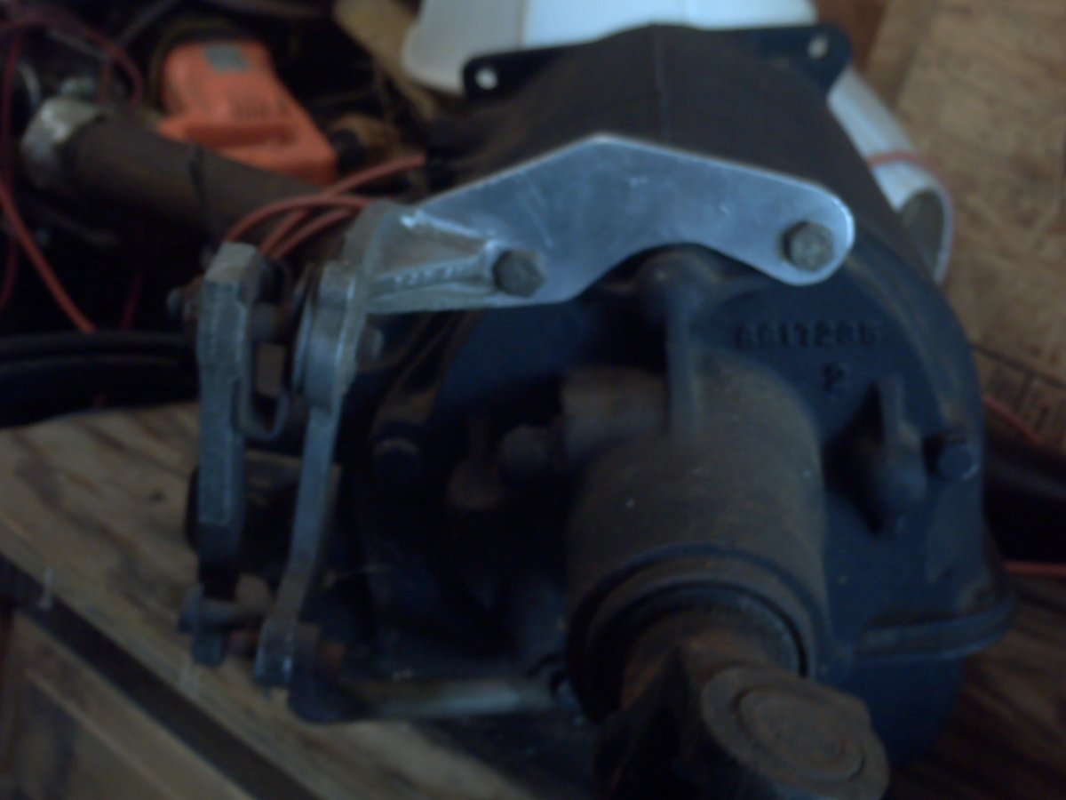

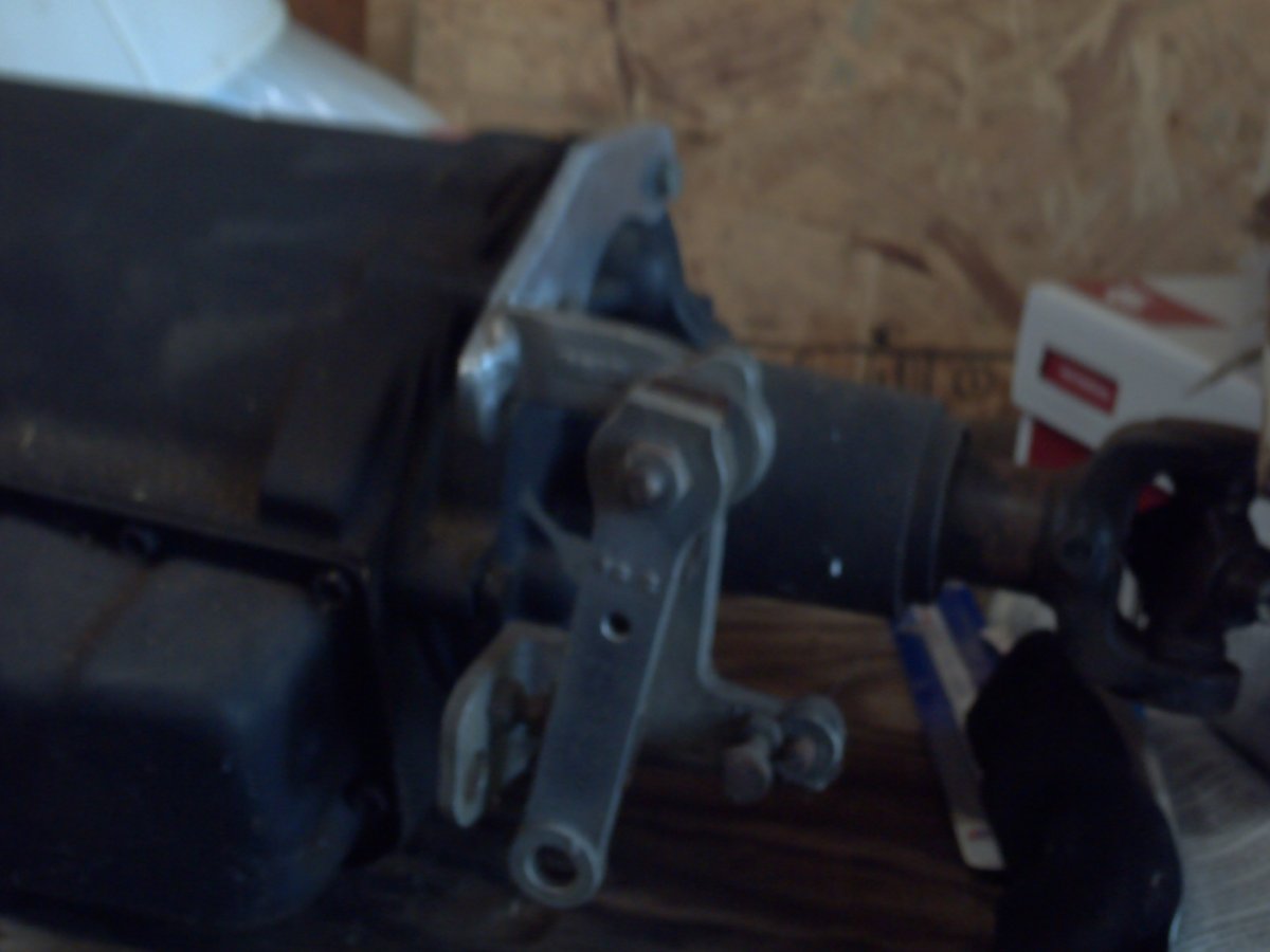

    i have a slant pan hydro stick transmission, that has most of the B&M hydro stick shifter, i won't be using the shifter in my pontiac. here's two pictures of the shifter, and i can take more if you'd like. someone cut the shifter portion above the pivot bolt, but i fiqure a new piece can be heliarc to make it suit you. i'll take $100.00 plus shipping for the shifter. b&m trans 003.JPG b&m trans 004.JPG b&m trans 004.JPG b&m trans 003.JPG b&m trans 003.JPG b&m trans 004.JPG
