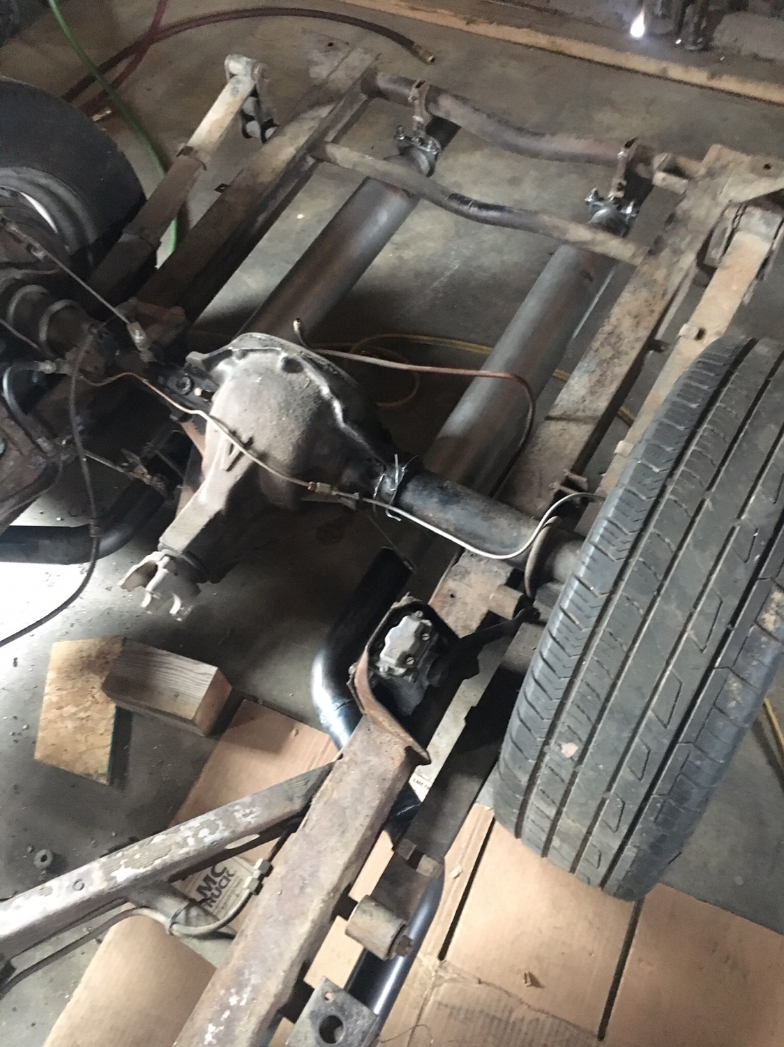

    TR3 with GM 10 bolt rear end. Not H.A.M.B. friendly but is underslung.
    Greg
