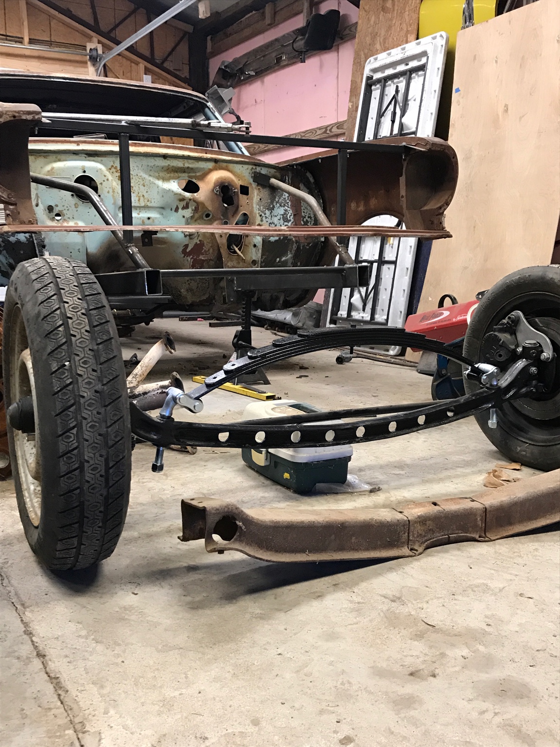

    Speedway treated me today. Got the spring mounted, but the bat wings were on back order so they'll be here Thursday or Friday.
    enloe, Fiddle Picker and loudbang like this.

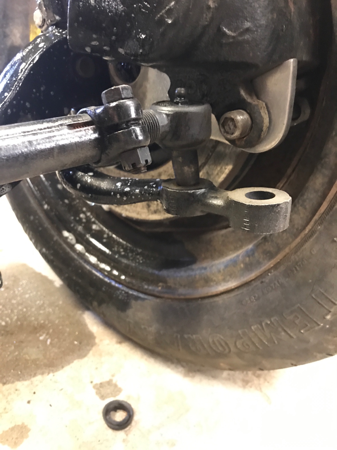

    Gotta ream my steering arms so my bat wings will fit. Oh yeah, my bat wings came in.
    Also, I want to throw out a kind word to speedway. I called them asking about the little lock pins for the king pins. I've torn mine up from removing them so many times, and they don't have them listed on their website by their self. When I called he said they don't part those out because they come in a kit, so he's just sending me a whole new king pin set!

    Thanks to randy (wrenchbender) for reaming my steering arms! Got the front end put together. I heated and bent the hair pins closer together. They were 2 inches too wide for my bat wings. I need to cut that clevis end that's welded in off, and weld on a threaded bung and put in a new clevis, get a bushing set for the 4-link ends, make the mounts, and then I'll be able to start the cross member.[​IMG]
