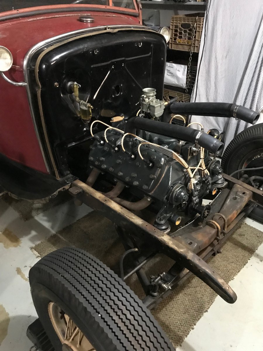

  5. Motor mock up , Verns K member , Useing Clings wisebone braket . Mock up the front spring rev eye. Have a rev. Eye coming from Hartford Ct . All is fitting well but still need a lot of fitment .
    The only issue is going to be the fuel stand.
    Cut fire wall
    Run 8ba intake manifold with elec. fuel pump
    Last is run a elec fuel pump with 59 intake but need to vent the motor so how ...
  6. Atwater Mike
    Joined: May 31, 2002
    Posts: 11,624
    Atwater Mike
    PCV, be inventive when fitting the PCV valve. Some guys hide 'em inside the valley...

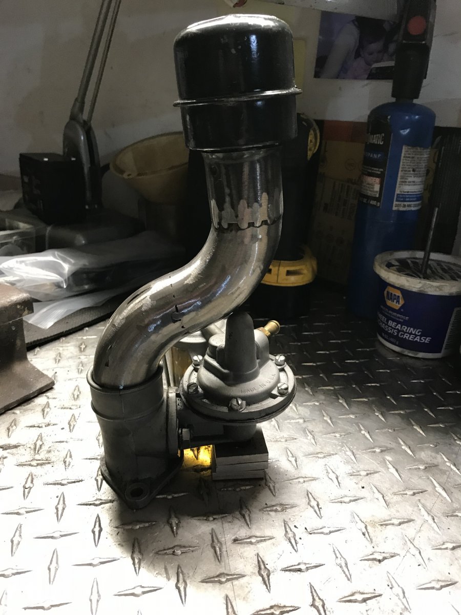

  8. 5F1B4A0A-A8AB-4B74-8B66-9EBBCB93D4CD.jpeg I mocked this up to solve my firewall clearance

  9. Found some Harley Knucklehead pipes with some nice shapes and tack them together
  10. image.jpeg After
    59ab/top load trans/F1 box/16 wires
