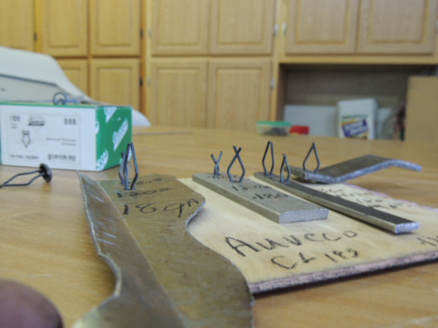

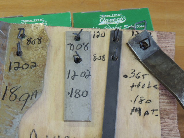

  10. 56premiere
    Joined: Mar 8, 2011
    Posts: 1,445
    56premiere
    As I have said ,I use 808 almost exclusively. The grip range and shape work well. In almost 50 years I have never had a panel come loose, as long as the panel fits and the hole is the right size . The metal can't be double thick in most instances. The panel must fit tight against the metal. I have used over 1000 in the last few months. I know we aren't supposed to mention that auction site but I believe they can be bought there. Auveco will not sell without a special big order. Fastenal here says they can get Auveco. I buy from my supplier, But they are wholesale only. Get a pic up of what your doing and between all of us We can guide you. Jack

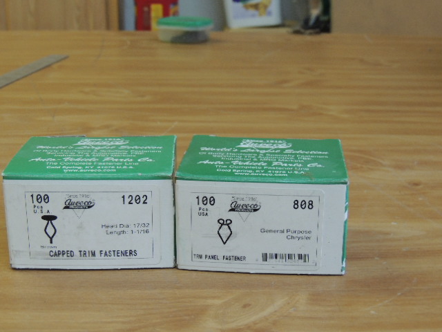

  12. If you need something deeper this is Auveco 1202. Head diameter 17/32", prong length 1", for 1/4" hole.
  13. 56premiere
    Joined: Mar 8, 2011
    Posts: 1,445
    56premiere
    Here is a sample of 808 and 1202 in use

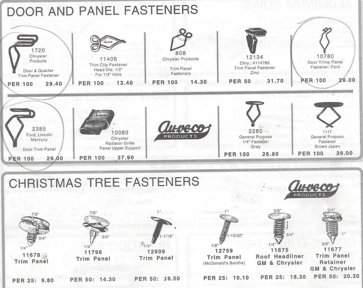

  19. stanlow69
    Joined: Feb 21, 2010
    Posts: 4,471
    stanlow69
    from red oak
    I use the 3 different ones circled. Depending on the depth needed. Scan0904.jpg
