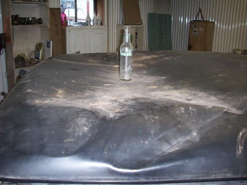

  8. Da Tinman
    Joined: Dec 29, 2005
    Posts: 4,226
    Da Tinman
    Before^^^^^^
    After.....
    yeah shitty tools means shitty work... Gimmie a break.
