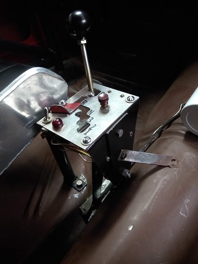

    Home made? Here's one. It's the best shifter for this car, which is trying to be period correct for 1966....and there isn't anything on the market at all that even comes close.

  8. Jim, is that shifter in your Barracuda? I really dig the simplicity and clean appearance of it. Does it use a cable?

    This is in my Chevy II. It uses linkage, pretty simple....
    Aftermarket cable floor shifters came around in 67.

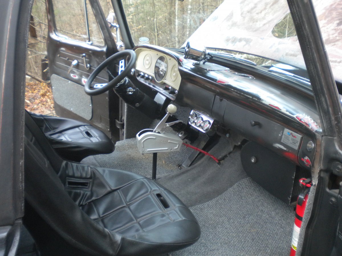

    I have a Shiftworks shifter in my custom console in my Chevy II Wagon and love it, made in the USA too.
    Be sure and look them over, they are available through Summit Racing too.
    Click here: https://shiftworks.com/collections/shifters
    In my Hot Rod I have a TCI Pistol-Grip, and I have neutral & park start and a backup light switch, and I made my own shifter cover.

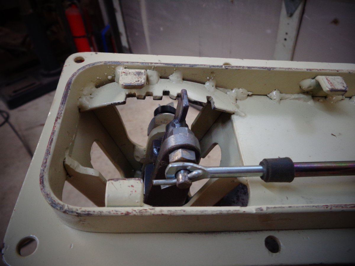

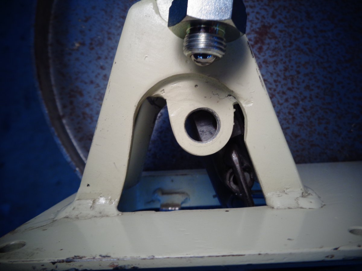

    Home built for a Powerglide. Freind gave me a Powerglide with the shift lever bolted to the tailhouse and the shift lever on the trans pointed up, right where I needed room for a size 12. E-Bay B&M(?) pieces to point the shift lever down, also the cable bracket.
    Shift Mechanism: 2 pieces. In the top picture you can see the 1/4" bolt both pivot on. It gets a jamb nut. The shift lever fits through a slot in the bottom piece so they move together.
    Shift lever is apiece of 1/2 rod with a bushing pressed on to re-enforce the pivot point and barrel shaped on a belt sander. (Froze the rod and heated the bushing.) The pivot hole was elongated so the shift lever could rock sideways.Turned it in drill press with a hole in a piece of OSB to pilot the bottom end. Roughed it out with a 4 1/2 in. grinder and then used successively finer grits of file paper, nailed to piece of 2x3, and then wet and dry paper to finish it. Note! When you clamp it in an aluminum block to bend it you should split the block through the hole before bending. LOL
    Detents: The little tab that indexes the detents is welded to the shift lever and the shift lever is spring loaded against the piece that moves the cable. There is a plate to cover the bottom so everything is sealed.
    Neutral safety switch: Ball pushed in closes the switch. It is operated by steel block with a depression drilled in the middle to clear for reverse.
