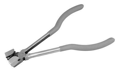

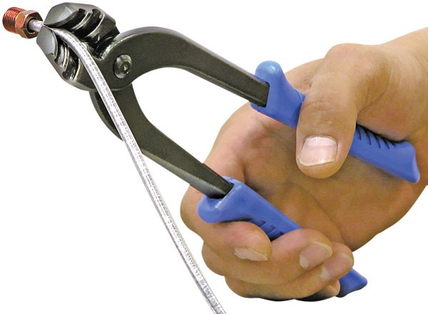

  9. I made a bender like this because I needed it right now for 2 bends- but you can buy them.
    These get the bend as close as you can to the fitting. Plus they make tighter bends along the line. The lower one works great to copy lines and I mounted it on vice grips :)

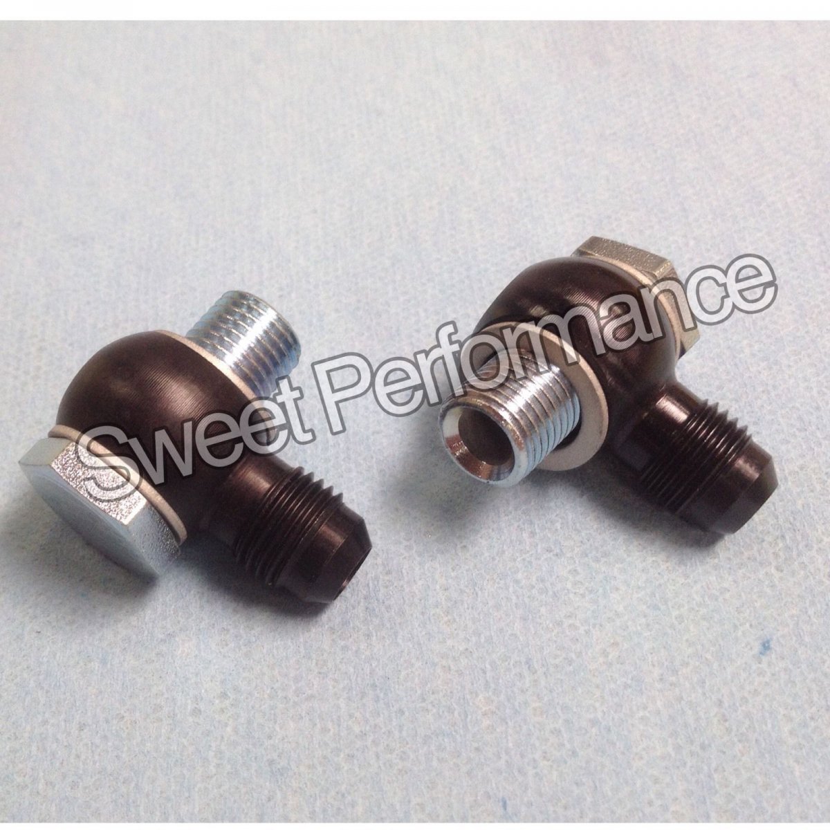

    Pictures would have assisted but 2" from X-member doesn't sound right. Radiator fitting should be 1/8"NPT, why not use a right angle fitting? NPT to NPT or NPT to 5/16" inverted flare. That way you can route lines for clearance for low cost. I always run through radiator and auxiliary cooler.

    Oops, missed that. It that is the case then the case fittings are 1/4" NPS with parallel thread and washer for inverted flare and double flared hard line with tube nut (1/2 20 for 5/16 tube or 7/16 24 for 1/4 tube). Case is not NPT (Tapered thread) but NPS (Parallel thread). Banjo fittings might be in order with compression fittings for hard line due to space restriction?
    Fluid lines will be 90 degrees to outlet with banjos and not like this example
