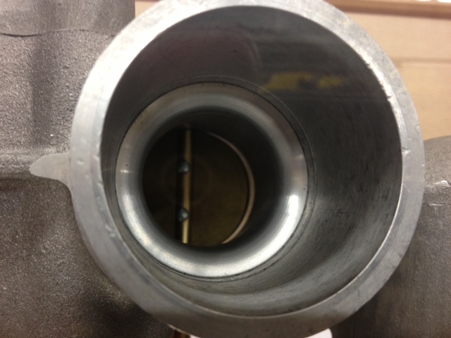

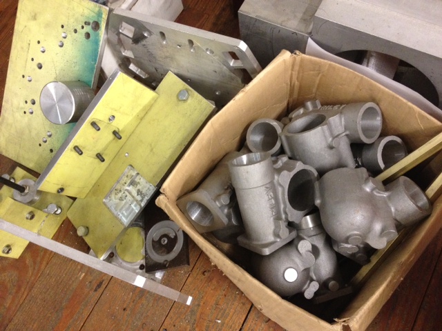

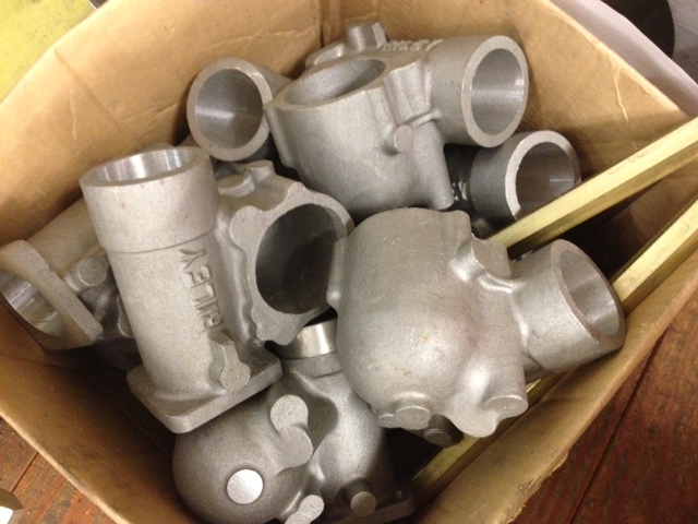

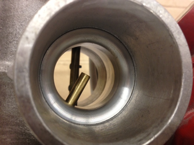

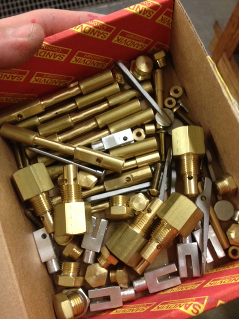

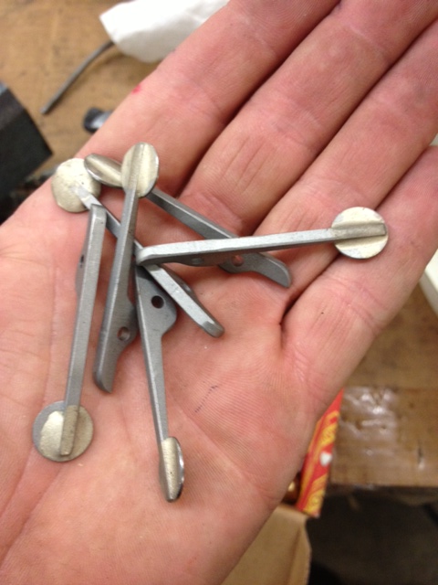

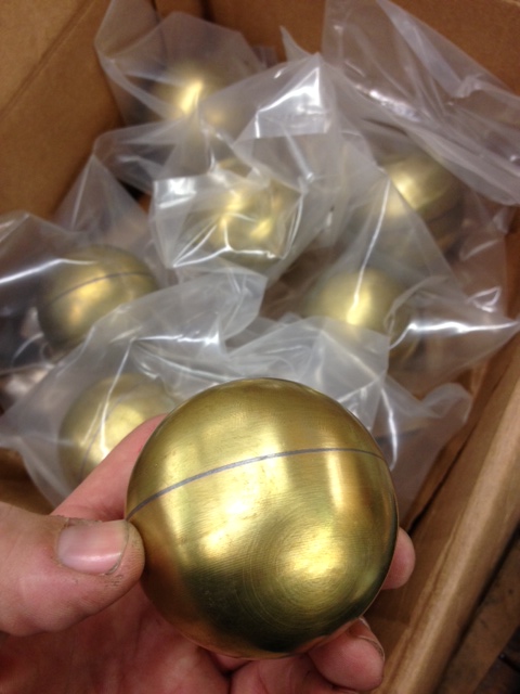

    When I restored the 1949 #14 Hal Cole Kurtis KK2000 a few years ago, I needed Two 2" Riley side drafts for the 220 Offy. I ran down the list of collectors, buddies, and museums trying to buy a couple and quickly found out that the "availability" had dried up.. I found a few, but NONE for sale. Eventually Bill Akin in Nashville Tenn found 4 and called me. We went halves on the 4 and I got my Two I was needing. They were not only very Pricey but had taken 3 months to find, so we (Zakira's) said "We need to make some".
    I completely dismantled my best one and we started researching the parts and components. I found many compatible parts that could be sourced from companies still in business. Reproduction STROMBERG parts, Holey carburetor, and even SU parts all interchanged. The Brass floats we had NEW ONES made to original specs, the Carb bodies, Float caps, and linkage arms were sent to our pattern maker, and new wooden patterns were made.
    Our number one goal was to make the new ones so EXACT to the originals INSIDE and OUT that parts could be interchanged from new ones to Old ones and visa-versa and work perfectly. So, in the future we can offer "Rebuild kits" for originals as well. This was accomplished.
    On our first run we casted 12 carbs. (roughly 10% ever produced) Of these 12 we have machined, built and TESTED 4. We ran my Two originals on a 255 Offy in our Dyno... Tuned them to run and rev smoothly, then bolted on Two of our REPRODUCTION Rileys with the same settings... They performed flawlessly!!
    The 2" Rileys can be "dialed" in to perform on MANY different size engines due to the "insert style" Ventura. We have copies of Rileys original Ventura Size-Cubic inch CHART, and can make any size engine application work.
    The official RELEASE of this new product will be within a week (on-line) and in up coming months through magazines. (good timing Mac!!)

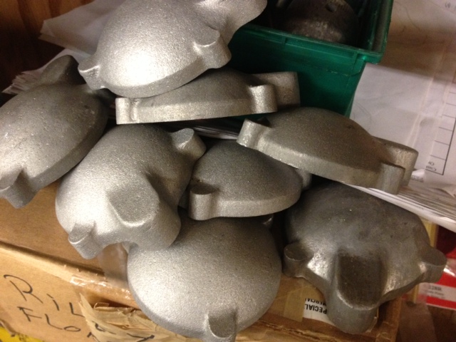

    For now, here are some progress picks to interest you all. There were a few different style RILEY float caps.. Early and late. We went with the "Smooth" style because its what we had. The difference is where the Fuel comes INTO the bowl and Throttle Linkage.
    We are currently tooling up to have the "Early" style Float cap patterns made, plus the smaller 1.5" Side draft RILEY's are a possibility if the demand is present.
    A new ready to race Reproduction RILEY Carb from Zakira's will cost $1700 Each. The turn around on one or more is around 3-4 weeks due to our busy work load. We currently have 8 in stock.

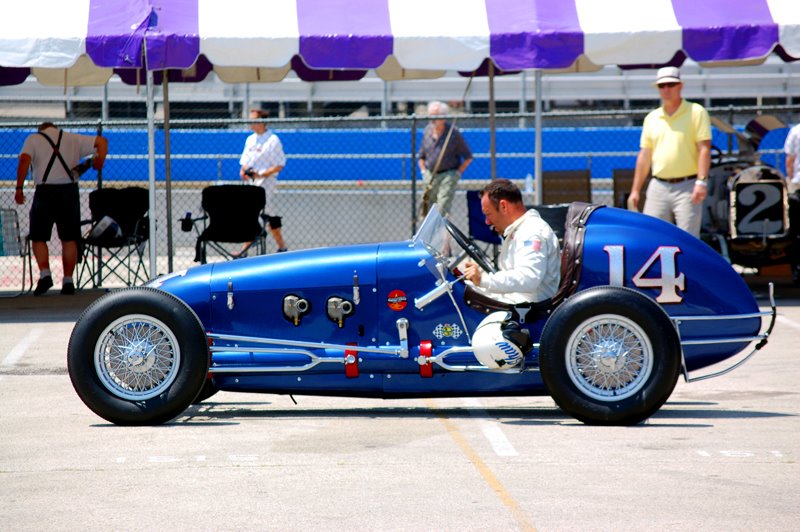

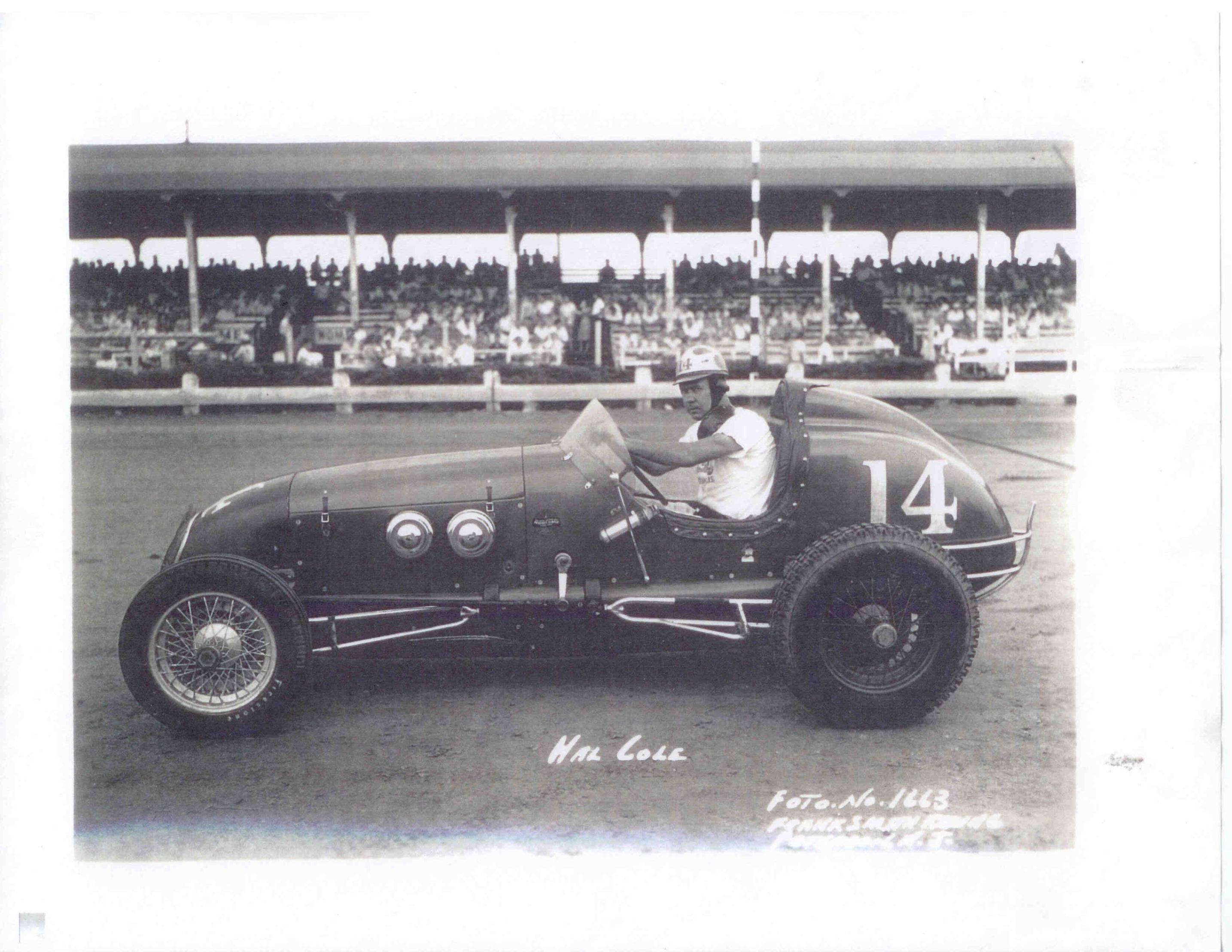

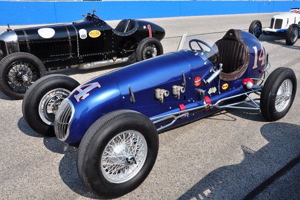

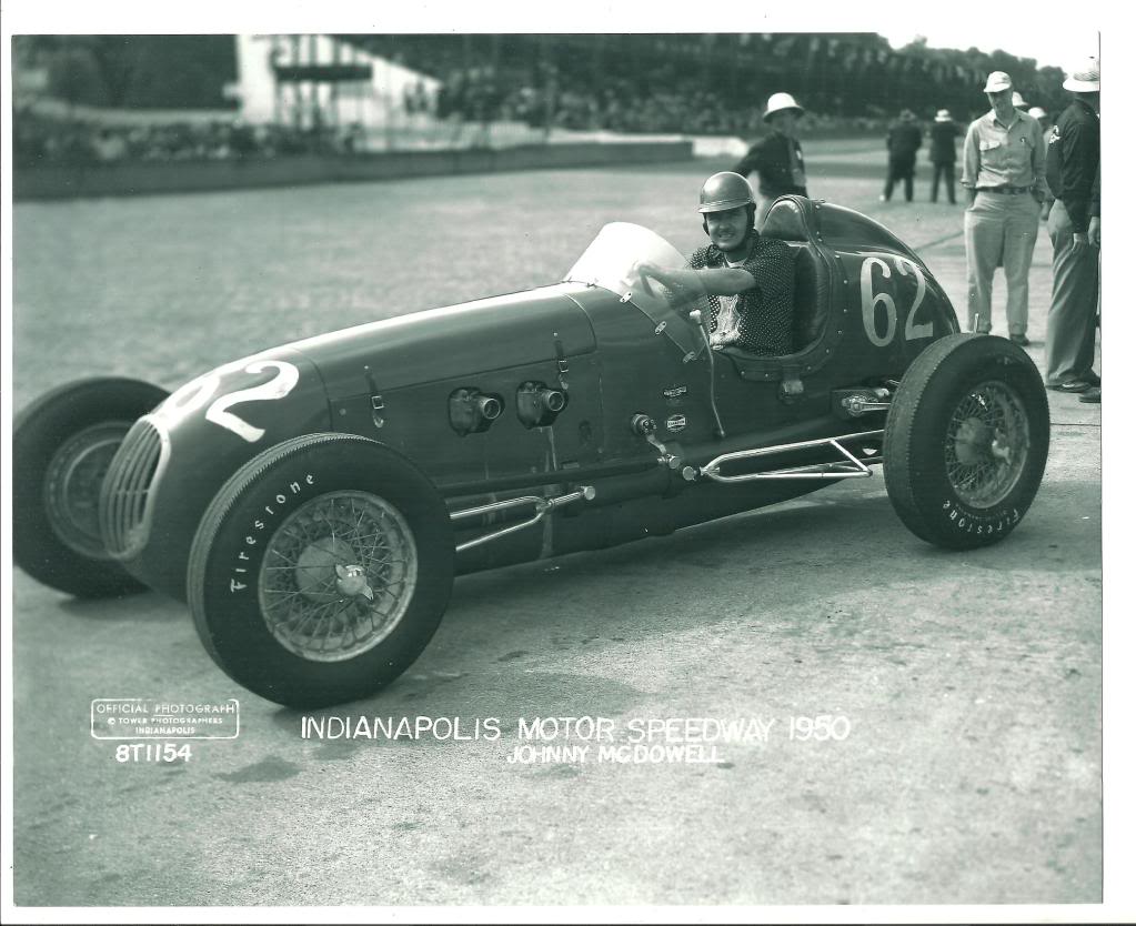

    Correct.
    it was originally built by Kurtis for Cole as what they called a "3/4 car" meaning it was between (actually both) a Big Champ car to be raced on Mile tracks, and a Sprint car to be raced on 1/2 miles and smaller. It had/has a spacer block between the chassis and the front Spring plate, as well as spacers in the end of the Front Hair pins that could be inserted making it a Longer wheel based Champ car, or removed making it a shorter wheel based Sprint car. It was fitted with a 220 Offy to pass c.i. rules in the Sprint car ranks at the time, so.. inturn when it ran on the Dirt Miles and the Indianapolis 500 in 1949, 50, & 51.. It raced and made the race vastly under powered against the 255's and 270's. Hal Cole and others dubbed this Chassis Set up a "Money car" because it was so versatile and the owner could enter so many races with the SAME car. I've read rumors of the adjustable suspension cars being outlawed, but have never confirmed it. (The Belanger #99 that won Indy was a stretched Midget!!) However, We have only found a couple instances (photo's and documentation) of the #14 Hal Cole Kurtis KK2000 being ran as a Sprint car during it's "adjustable" years (1948-1954). It spent most of that time being ran as a DIRT CHAMP CAR, very successfully. It won the inaugural* Williams Grove CHAMP CAR race in 1949 with Hal Cole at the wheel (color pic below). In/around 1955-56 it was PERMINANTLY converted to a Sprint car, and raced extremely successfully by Curly Doggett in the BCRA circuit. The car was updated many times and last raced in the late 70's on pavement! As with most vintage race cars it had a long interesting life with up's and unfortunate downs that come with the business.
    Here are a few pics of the car then and now.

    IMHO how to screw up a beautiful car.
    Put a roll cage and nose bar on it, coil over shocks, wide tires and wheels, a wrap around seat, and stuff a V8 in it and run the stacks out the top.
    Sort of looks like a pipe organ.
    This should make me lots of friends. LOL
    Bless the restorer.

    That's how it looked when I found it advertised as a C.A.E sprint car. I still have the cage, seat, interior, body, front axle set up, bumpers, Steering box, etc.. and that damn Nose hoop. :p
    It's up in the loft of "spares" in my shop.
    Nothing I wanted on the car... But can't just toss it.
