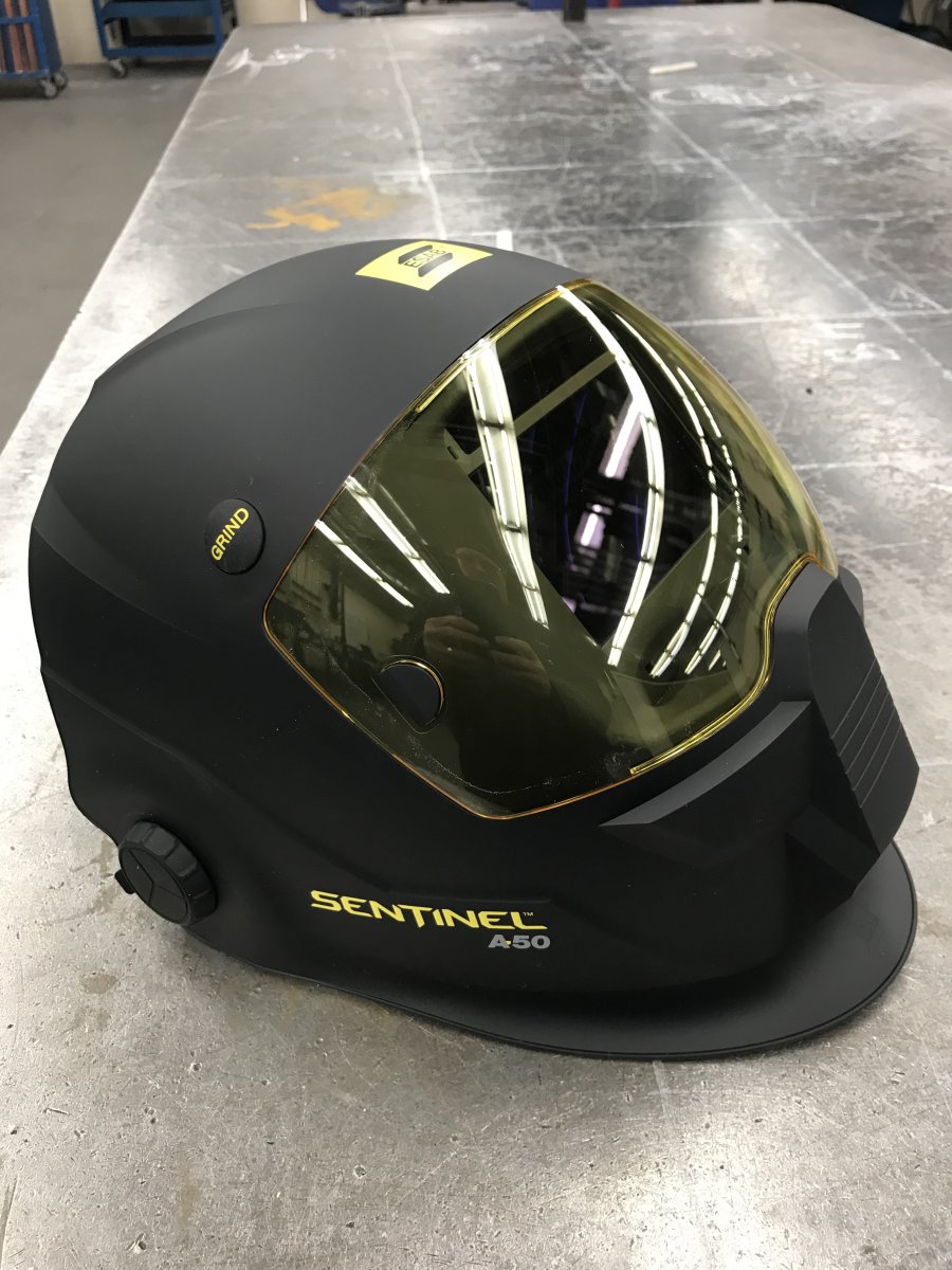

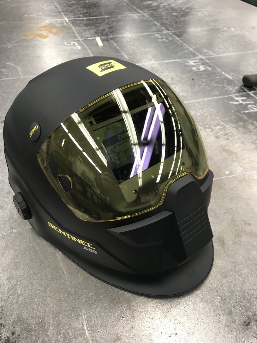

    I just got a new welding helmet.
    Best one I’ve ever had.
    The auto darkening is super fast and the battery life will be really good because it only uses power when you weld.
    You don’t have to turn it on or off it’s automatic.
    I can also see better when welding than any other helmet I’ve ever had.
    It’s light and the headgear is really comfortable.
    It also has a really neat ratchet feature that keeps it from falling down in front of your face when you don’t want it to.
    It’s an Esab Sentinel A50
    4A86FC53-F14B-4101-9B41-9FEB607DEF62.jpeg 5E899BC5-22B7-49BB-A963-D24C9344872D.jpeg

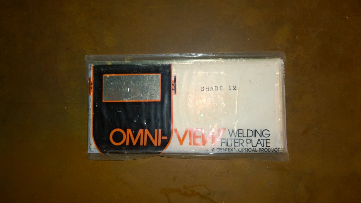

    I use the "old hood" with a gold lens when pipewelding on a positioner with MIG spray and pulse. The clarity is excellent and allows for really good puddle control. Of coarse on large pipe, I may be running setting like 33/300 on MIG. For metal at 1/4" or less, the auto darkening hoods are the preferred method usually because of the constant starting and stopping. On TIG welding were the start of the arc is critical, you can't beat the auto hoods.
    The gold lenses work great for watching solar eclipses. WP_20180120_23_01_14_Pro.jpg
