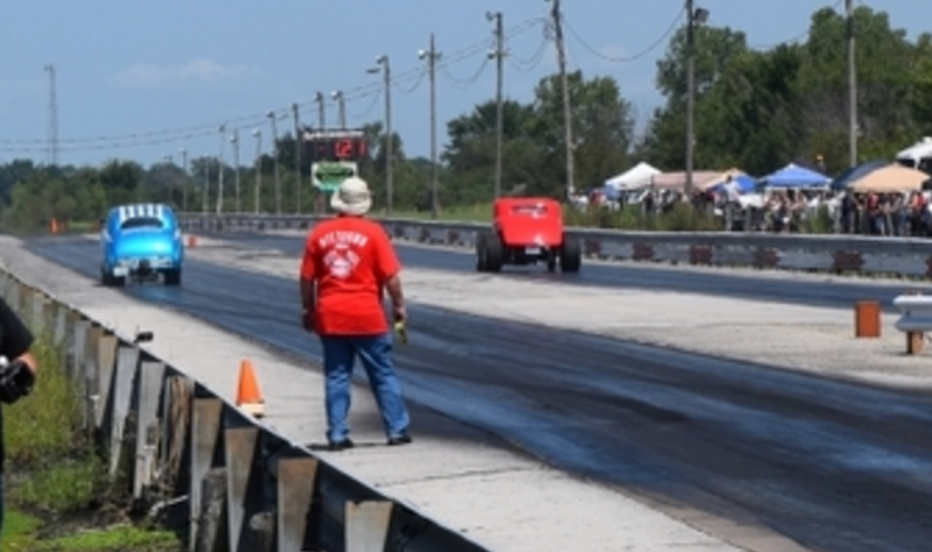

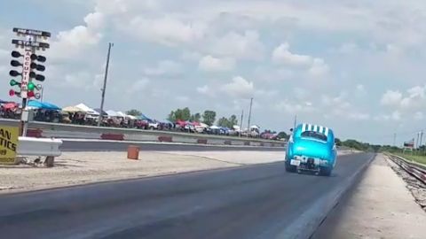

    ROUND ONE: We rolled into to the track about 9 a.m. just as the guys were unlocking the gate so we got our early bird parking spot under the big tree near the concession stand. We were very excited and actually sat and enjoyed the shade for an hour or so before touching the Austin.
    We had an issue with the new longer throttle cable we installed...speaking of just leaving things alone. We could not get it to open full throttle. Even after spending the better part of an hour playing around with it, we still came up a 1/2" short of the throttle stop but decided to just leave it alone. We will have to fab up a new bracket for it to keep it in better alignment but no big issue.
    We we roll up to the line with our new horizontal cross bar and pre-loaded right rear shock ready to lay one down.
    It was not idling very well so I had to keep feathering the throttle. So that meant pull it back into neutral, let out the clutch...pump up the brakes with my left foot, hold and push the line lock. Then back on the clutch, back in first and then light the tires. Sort of a pain in the butt not to mention it really messes with your rhythm. Anyway long story short I didn't get enough brake pressure so we just rolled right through the lock and got very little heat in the tires.
    We blew right past the start line exactly like we did first round of the Meltdowns. I hustled it back and lit the tree. On the third light both cars launched early. I went -.125 and the bad ass red 34 Ford Coupe next to me went -.127 so I guess in the real world of drag racing I gave that one away. But I sort of hands full at the time!
    It is hard to see from the camera angle but we were all over the place in first and second. I finally got her straight and into third gear and even though we left a red light at the start, the Austin ran the coupe down. We went 10.20 to his 10.70 and even with the crazy first two gears, still managed nearly 144 mph out the back gate. But that race had it all! A couple of killer cool cars (I love that coupe, it was awesome!), the crowd loved the Austin being all over the place and then it took every inch of the track available to run him down.
    I had already decided to scratch one off the bucket list at this race by pulling the chute. I had been warned to drive through it, don't let off and then pull it etc. So at 144 mph I pulled it but to be honest I didn't feel anything. Maybe too much adrenaline at the big end. I actually turned around to look to see if it deployed. When I saw it back there, I got on the brakes. As I said earlier, I nearly waited too long as I thought I was going to wind up in the corn field chute and all....LOL!

    ROUND TWO: We came back to the pits after the first run scratching our head a bit. I had been prepared (or at least as prepared as you can be) for the car to get wacky. But it has been so well behaved. The car has always gone so straight. But there is no questions, today it is a different animal. I took a quick look under the car to make sure we had not broken something obvious but all is just the way we left built it.
    It is really hot and the track is a bit greasy so that may have been a factor. We let a few pounds of air out of the slicks and decided to try the other lane in round two. I thought about taking some power out of it but to be honest, this kind of track (if that is the issue) is exactly what this car was designed for. But I gave my phone back to Dad at the start line so we could get a good look at what the car was doing.
    Same result...although not as dramatic as round one but still a handful through 2nd gear. This time only a mid 10 second run but still pretty hard out the back at 140 mph. When I got back to the pits I watched the videos. The car just simply is not rotating like normal. In my opinion it is the stupid right rear spring we added in an attempt to preload. In my opinion there is no reason to make another pass unless we can fix the issue so we skipped round three, took the shock off, removed the spring and reinstalled it. An absolute complete pain in the backside in this car especially at the track. But we got it done.

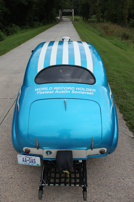

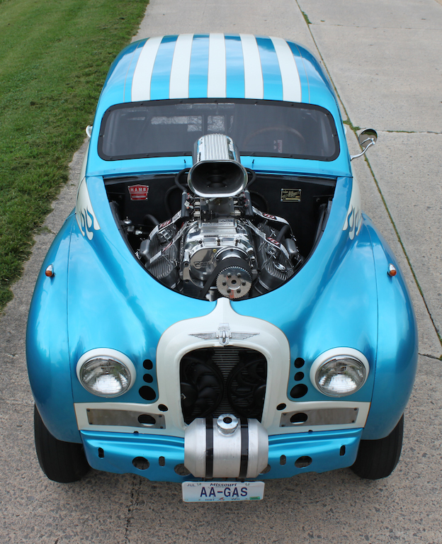

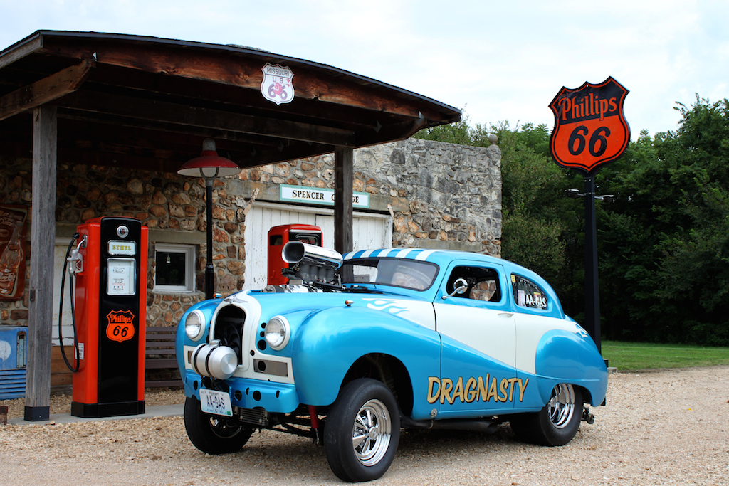

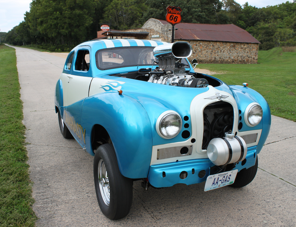

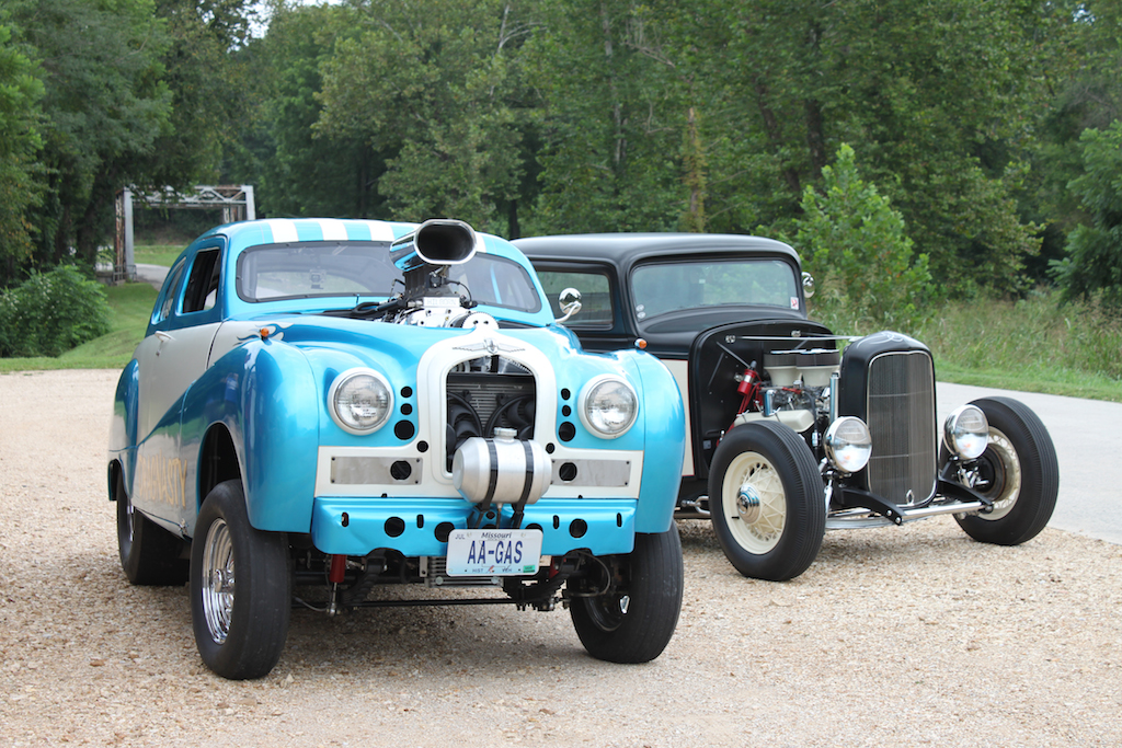

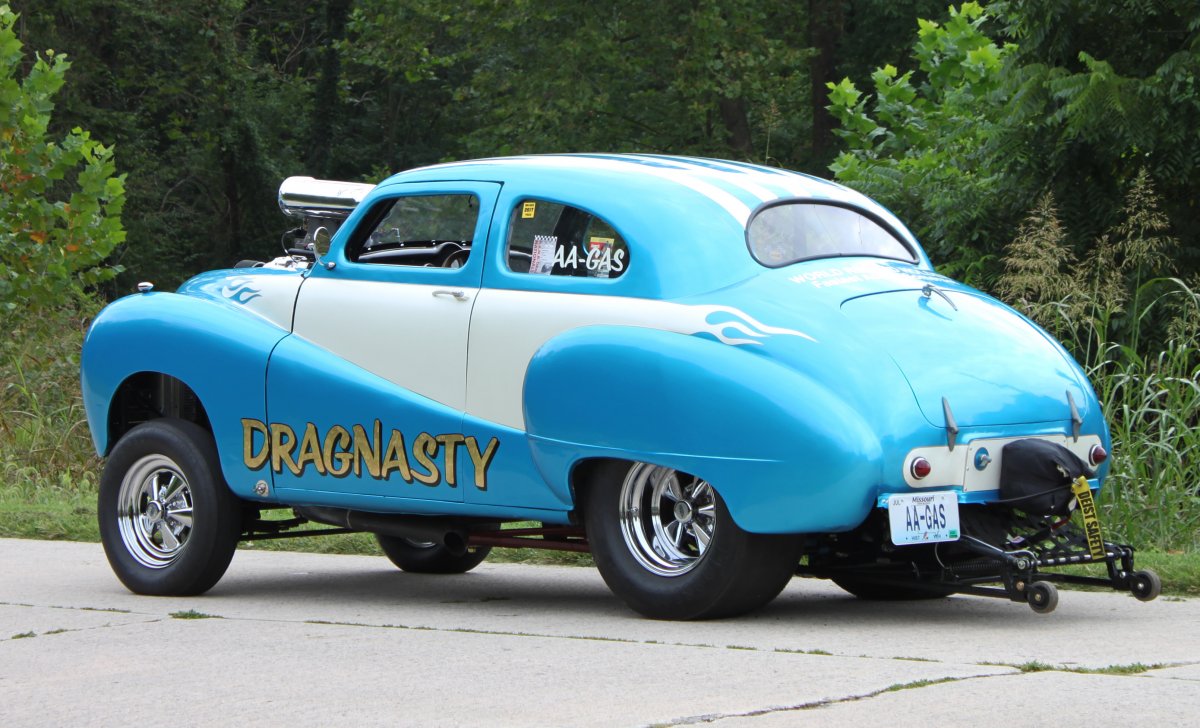

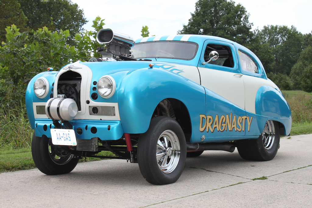

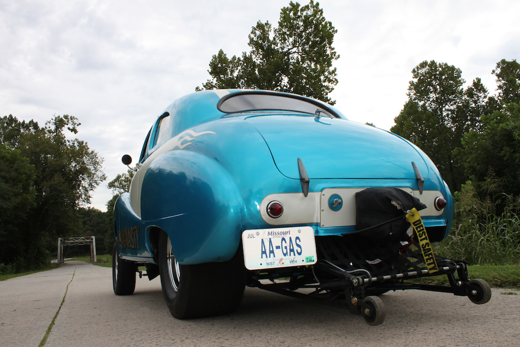

    Saturday we took the Austin out for photo shoot. I chose an stretch of original route 66 concrete about 10 miles from my house. We had a great time. Took Dad's car along and shot it to while we were at it.

    Your dads car is too cool :)

    We are going to get some pie crusts slicks for it and race it at the HAMB Drags next year too!
