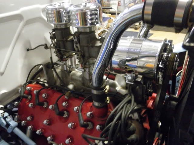

    Got my powergen today. It is to suit my 8ba. I am running twin 94 Carbs.
    I haven't fitted it yet, but it looks a tight fit. Has anyone got any info they can help me with. I have read in the past about grinding a small amount of the front carb, but it still looks if it is a tight fit. Could I solve it by raising the mount and getting a longer belt. I don't want to run a side mount bracket.
    Thanks in advance.
    Rok.

    This is what I have.
    The alternator, on the car, is 6ins long from the centre of the pulley to the thread holding the main wire. The original Gen and the Powergen are 8 1/2'' long. The orig Gen is 4 1/2'' in DIA. and powergen is 5'' in DIA.
    Original generator on stock manifold.
    Final option might be this setup.
    I am only putting this up out of interest and hope it might help a few others on here.
    (And yeah I know I should have ordered the short one.:))
    Rok.

    Finally got it done a bit over a week ago. Still runs fine with spacers under the carbs.
